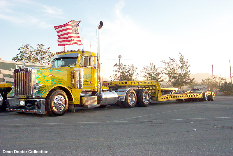

You need this rig to safely move a 50 hp tractor :laughing::laughing:
