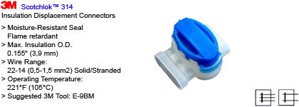

Then I got side tracked with wiring issues. I'll rewire tomorrow. Should I use crimps or solder connections?

You may have started a huge argument here. I used to think solder was the way to go. Then I saw some information about solder joints on vehicles actually being failure prone because of fatigue and corrosion. I've had some fail. Now I'm carefully using crimps (disconnects, splices and taps) and I've been having great success with them over the last few years. If you solder, be careful to get a very good seal with tape and support it so it doesn't flex. If you use crimps use the correct size and don't be sloppy. Either way you'll be fine.

My $0.02 - Always use adhesive shrink tube on any connection exposed to the elements, whether you solder or crimp. Tape will eventually let moisture in. Moisture promotes corrosion.
/ Trailer brakes #10
Tape will not prevent moisture getting in, solder creates a "rigid point" in the wire and is prone to brake on edge of solder regular heat shrink will not stop moisture Ive been there many times
Ma Bell has been using scotch locks for years on the phone lines with the jelly in them to exclude the moisture.
If its good enough for Ma Bell its good enough for me, what I use is the 314 series
megabbs-imagedisplay.php
I haven't had a problem with the connections since I switched to these in the last 10 years.
Note they are not the tap and run blue type so you have to cut wire and put all 3 wires in to make tee.
