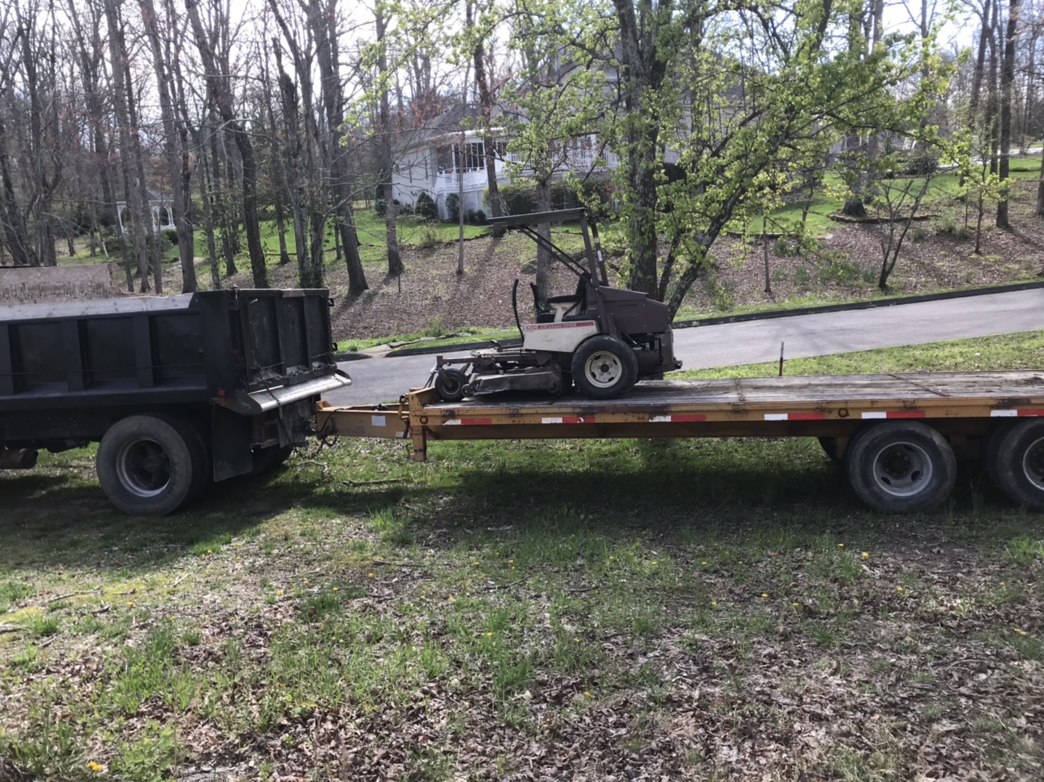

If you're going to go buy it, put your zero turn on your existing small trailer and tow it there to see if it works. If it does, tow the big trailer back with a small trailer and ZTR on top.
Aaron Z
Yeaahhhh, I don’t see that happening :laughing:

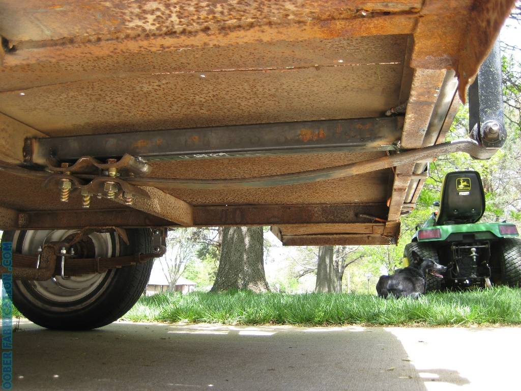

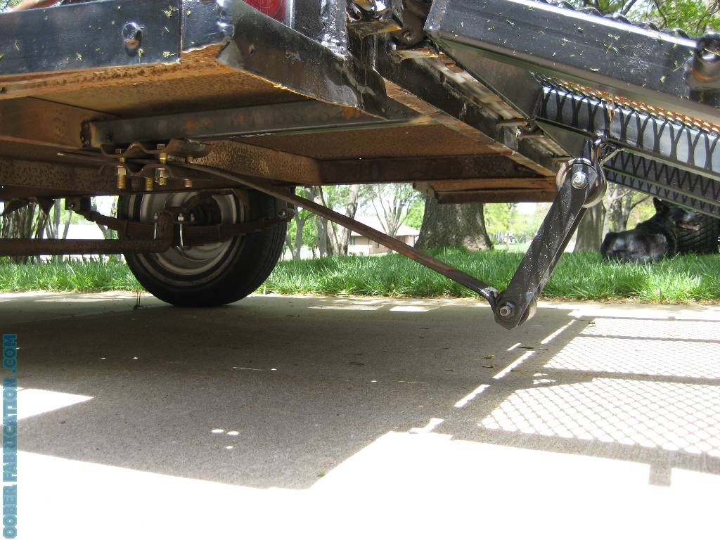

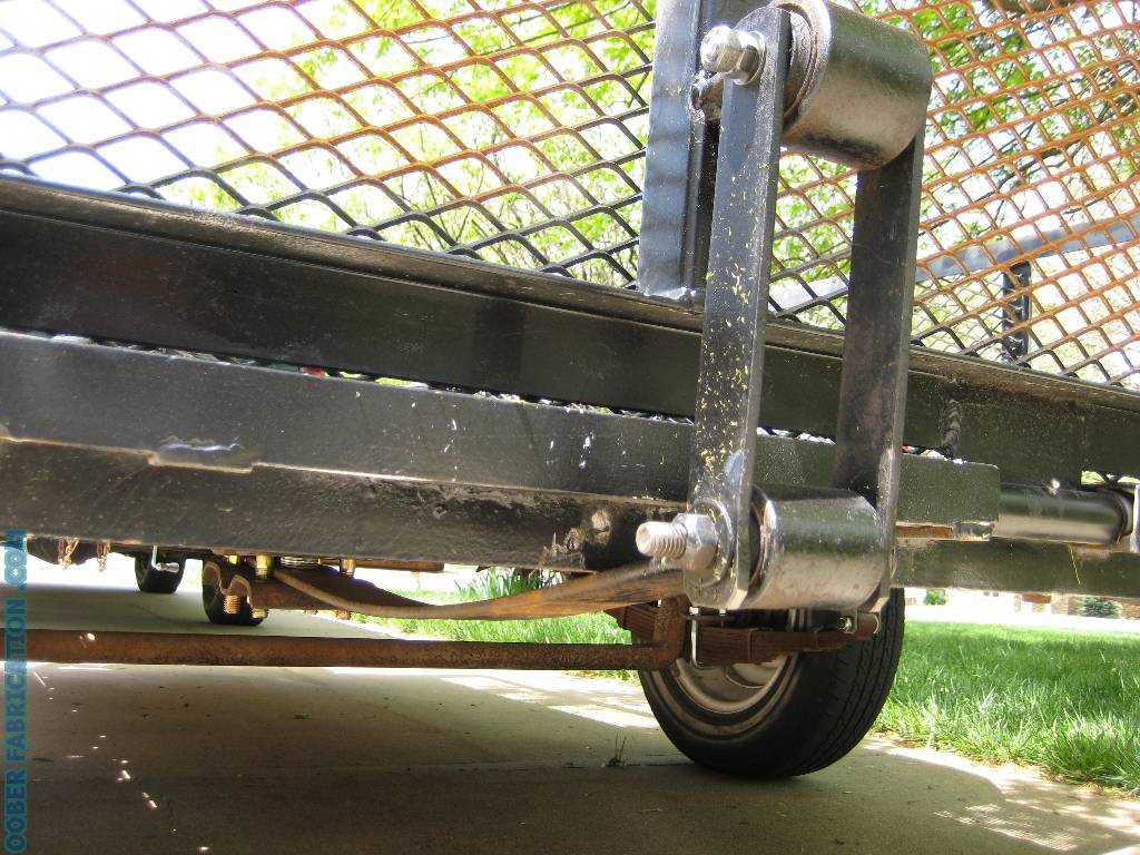

You have enough clearance underneath, for a lift assist spring, I would look at the spring style that uses a trailer spring mounted underneath the trailer and sticks out the back a little bit to provide spring lift assist for the ramps.
Some pictures of someone's version of this, source: How to build a Self Lifting Trailer Tailgate – DIY METAL FABRICATION .com

All you need is a bunch of pieces of 2x2 (or so) angle, some flat strapping and expanded metal and you can convert your existing gate to a spring assisted screen ramp :D

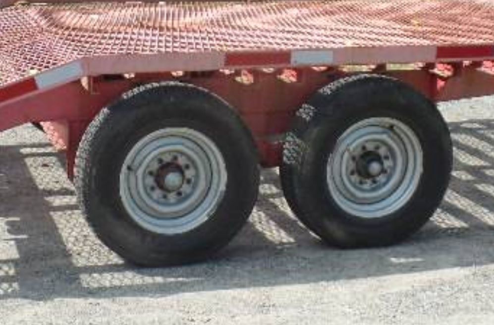

/ Trailer customization suggestions #31
Looks like it may have leaf springs, but not much clearance:
#32
It has more clearance than my dual tandem gooseneck.
#33
/ Trailer customization suggestions #34
If it works for your needs other than the ramps, I’d buy it, then remove the lights and ramps. Build two wide ramps add spring assists and led tail lights along the lower edge of the trailer. Something like these mounted length wise.

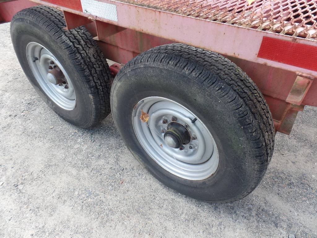

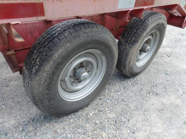

For only $1,500 (no tax) it probably does make good sense to buy it and try adapting to your needs.
#37
I could get by with center ramp removed and two outer ramps set up for variable spacing. Adding a full mesh overlay ramp on the two ramps and a spring assist would make it great. I dont think those little Buyers brand spring cable assists would be enough and if they'd work???? Doesnt look like it.
Even if my final cost is $2500-$3,000, I think I'm still in pretty good shape for a 12k deck over.
Ill be darned if I can find a used 10-12K deck over with a full width reinforced ramp.
/ Trailer customization suggestions #38
Make the center and left ramp one, Then the right extent it and on the side put angle iron so it sits on the side of the center ramp....
/ Trailer customization suggestions #39
looks kinda tiny for a skid steer, my trailer is 14' and its the smallest I would go. The angle looks too steep to go up forwards without tipping, the ramps need to have some structure underneath or they will collapse. and if use it for skid steer there will be too much tongue weight
