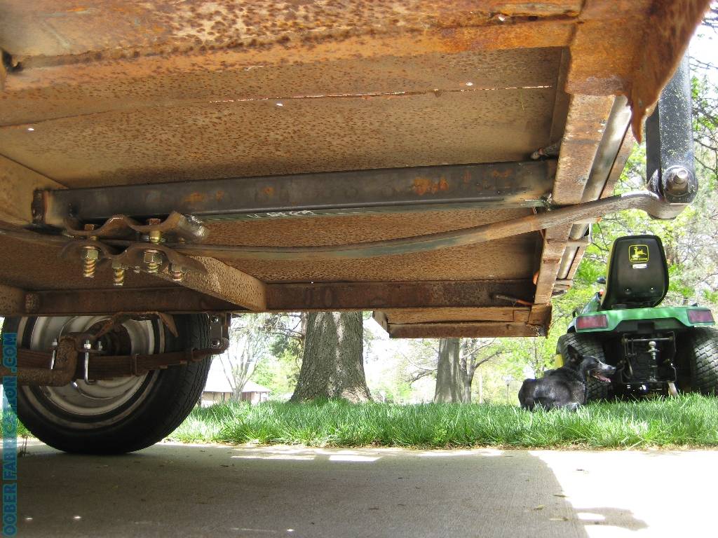

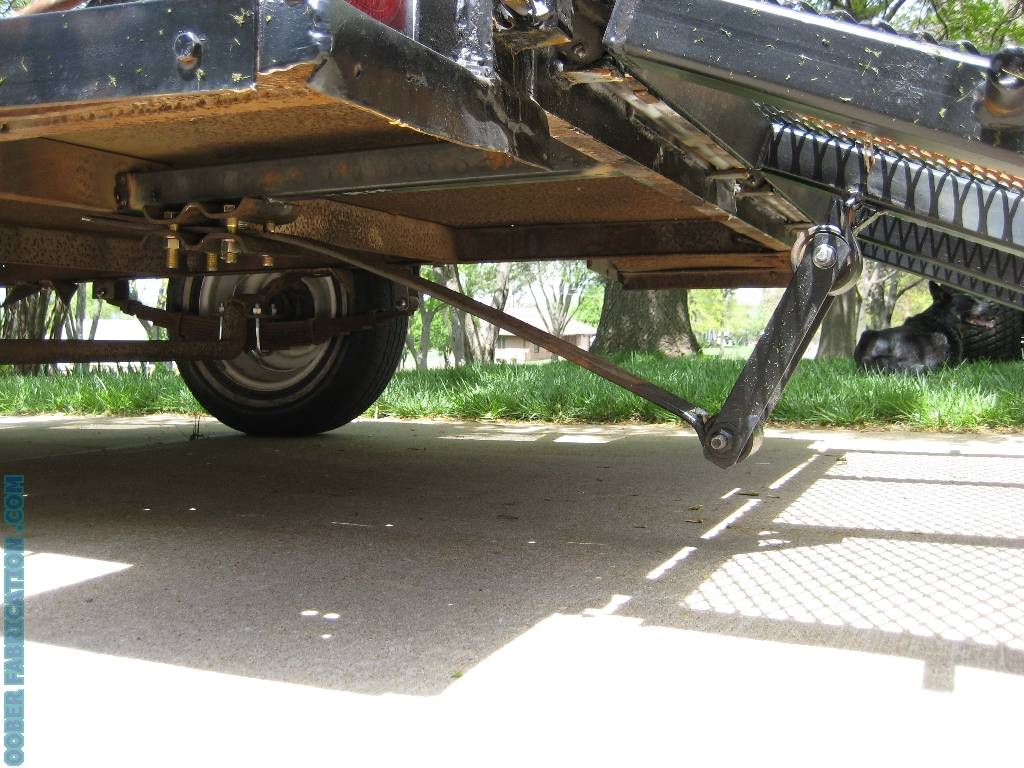

It does, that's actually what U-Haul uses on their ramp tailgate trailers.
The trick is getting the right strength spring, not strong enough and it won't help, too strong and the tailgate won't sit on the ground.

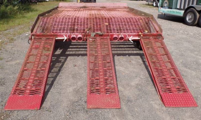

So the outside ramps aren't adjustable left and right?
And you need something narrower?
Can you remove the left and right ramps and swap them? That would narrow it down to just a gap between where the lights are. Make them pinable so you can move them back if you need to load something with a wide track.
If you still need to fill the spaces between the narrowed ramps, you could just lay a couple portable ramps between them. Put some pins on the bottoms to grip the ramps so they won't slide.

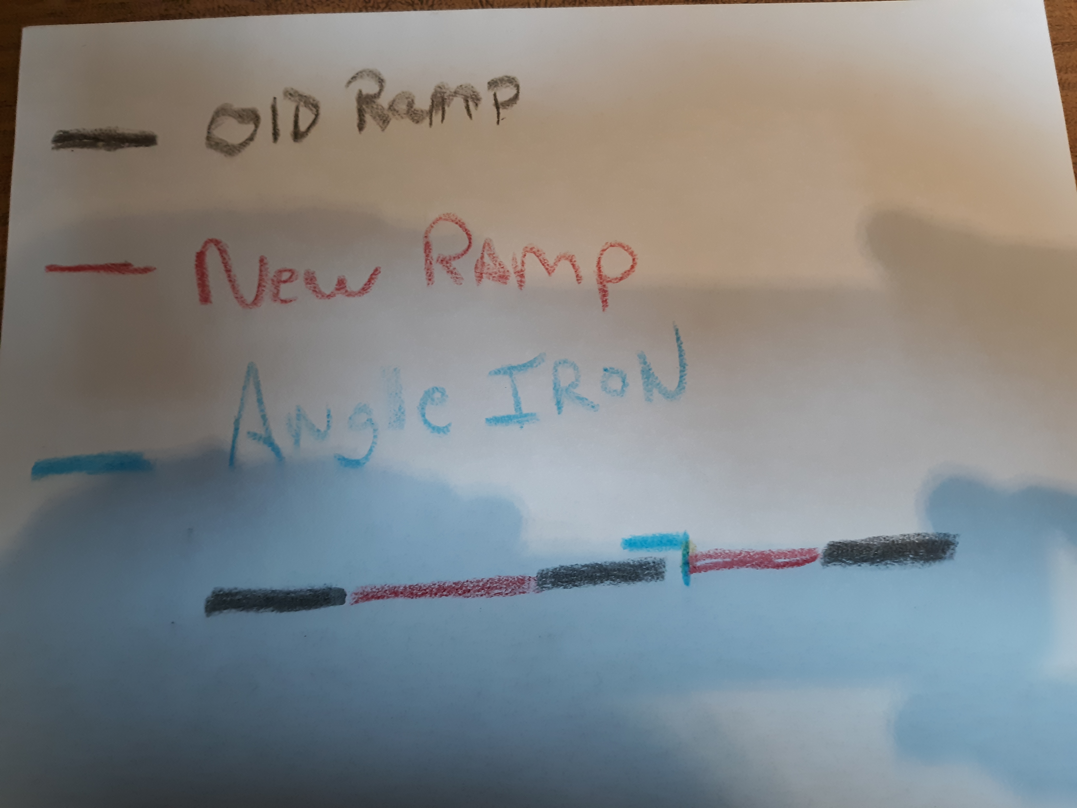

Like it and appreciate those mechanical drawings :laughing:
But I think it’s not going to work for a skiddy. 2 outside ramps might be too wide (assuming red is wire mesh?)
It will be one wide ramp 2 sections and just beef it up where the skiddy tires are going up the ramp...

I agree with Peter, there must be a way to make the ramps work in your favor. Maybe eliminate the middle ramp and extend the inside width of the remaining ramps so that you have two, very wide ramps? I would also add the support loops that reach the ground when the ramps are flipped down. You want the ramps to be self supported when you have a heavy piece of equipment on there.
You'll probably have to back a skidsteer on, so make it easy on yourself. and have as big of a ramp(s) as possible. I wonder if one of the those cable lift systems would work? I've seen them in the Northern Tool catalog.

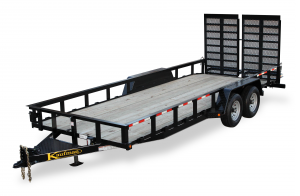

It would look like this but not a 50/50 ramp......12K-Landscaper-Deluxe.png

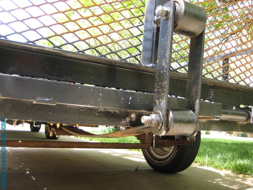

It would look like this but not a 50/50 ramp......View attachment 650826
I bet those ramps are only 3' wide, but that would be OK, I really dont need a ramp in the center 2'.
4' wide even better.
Thinking these ramps are made by each individual trailer manufacturer, they arent something you can buy from a catalog?
/ Trailer customization suggestions #54
A welding shop could copy the picture but they are from Kaufman Trailer I was going to by trailers from them..

The outside ramps will slide in a little closer:
The ramps on my trailer slide sideways a lot:
