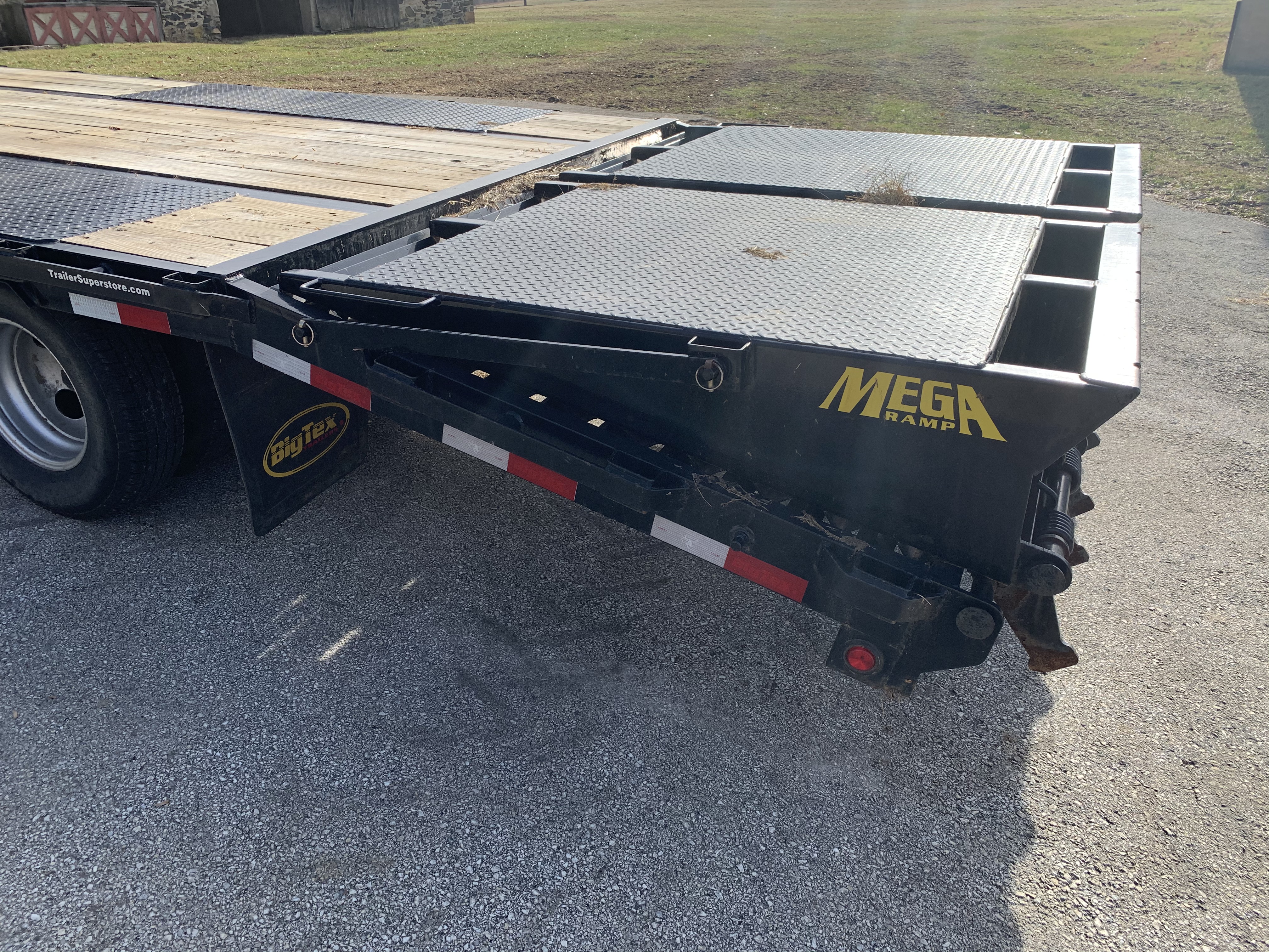

I wish it had ramps like the ones on my Big Tex.

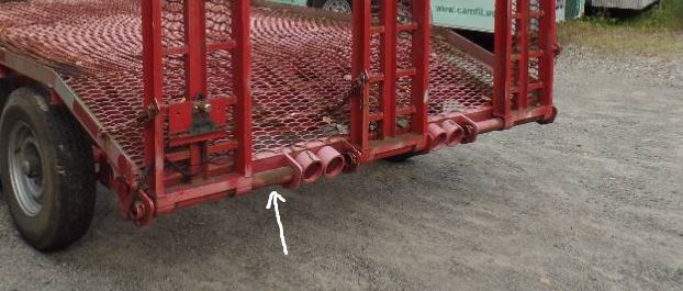

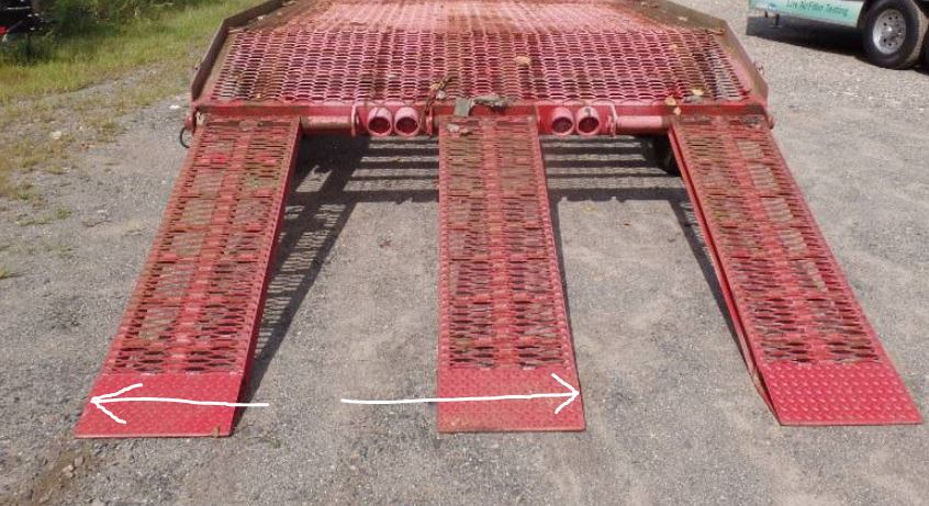

Sure would be nice if they did, but they still don’t slide close enough together for my liking for my zero turn.
On edit: owner just verified ramps DO slide, but only about 10” inward. The most narrow setting is 80”. My zero turn is 58”.
/ Trailer customization suggestions #67
The most narrow set is 80" outside edge to outside edge of the outer ramps. That's 6'8".
What's the inside edge to inside edge of the outer ramps?
Your zero turn is 58" outside edge to outside edge of your tires. That's 4'10".
How wide are your tires spaced apart inside edge to inside edge?
If your inside tire-tire measurement is = or > than the inside edge to inside edge of those ramps at their narrowest setting (and I'd guess they are just by looking at it), you're good to go.

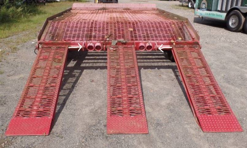

If this area is less than the width of the inside of your zero turn tires you're good to go...

Inside edge to inside edge on outer ramps slid all the way in is about 45” inches. So if my zero turn tires are 58” outside to outside and 32” inside to inside, I’m only getting about 7” of tire on each ramp. It would work, but I’m not real comfortable with that.
