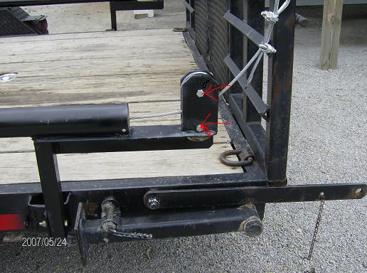

I made my folding ramps out of heavy galvanized grate, much like is commonly used for catwalks and drain systems in paved areas. Local scrap yard had quite a bit for $4 sq ft. I made "hinges" out of heavy angle and pieces of DOM with compatible O.D. and I.D.. Welded the grate side of the hinge and bolted the trailer side so it can easily be removed if needed.
