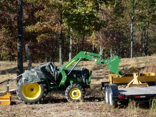

Sorry I'm late to join this thread but have been busy with snow and new puppies (10).
My proble or question is: My sopn has a 22' trailer with the pack away ramps that go under the trailer. Yes they weigh a ton and support the tractor (JD3032E) while being loaded but........"The trailer has to be connected to the pull vehicle while loading and the back end rises while loading.
I'm looking for a way to make supports for the rear of the trailer which will support it while loading but can be stored or folded. The foldup type seem to have a support buile into the design but the pack aways don't have the extra support.
Any help,,,,,that is if you can understand my rant..

Go to HF or TSC and get 2 of these. Simple fix that is totally adjustable.
Heavy Duty 2000 Lb. Capacity Top Wind Trailer Jack
Another simple fix is to carry a single jack stand in the tool box on the trailer. You can get them for about $15 a set. I carry one and simply place it under the rear of the trailer but leave about 2" so when the loaded trailer squats you can get it out. If it does get stuck just drive forward slowly and it will pop out.
Chris

Does the jack get welded to the trailer frame at the rear? Could it be attached on the side rails near the rear? This sounds like a simple solution for a problem I thought was complicated.
Yes, just weld them on the rear corner of the trailer where it will fold up out of the way, not get in the way, and keep the tail lights clear.
Chris
