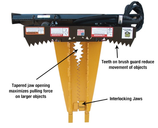

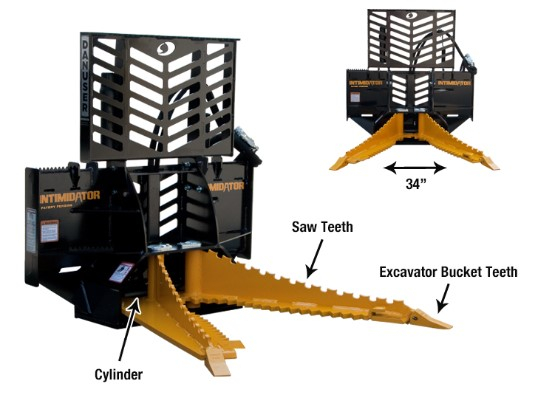

Use my Danuser Intimdator routinely to pull up small diameter brush and trees. Particularly places I can’t mow to keep clear. Large amounts of vines. Not sure if having two moveable jaws instead of one makes a difference? Or how the jaws align on some of the others? Clamp low then move forward preferred or back from fence before lifting.
Wonder if breaking sharp edges on the teeth would allow for more clamping versus cutting or breaking?
Longer jaws give better line on sight. Also has oval relief on tooth bars to better grip larger diameter stuff close to tractor for higher breakout force.
Being able to excavate and break roots before pulling helps tremendously on bigger stuff.
Highly productive and well designed tool that is fun to use.

The Danuser puller can do that. It’s a beast paired with a CTL.

Yeah it seems the Danuser is the pinnacle of these types of attachments. It’s basically a stump bucket and tree puller in one and can also do general grab and carry type of work. It opens to a huge width if i remember correctly.
