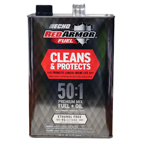

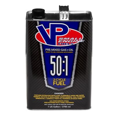

Old thread, but worth adding my 2 cents.
I strictly run VP 50:1 when i can`t find Echo Red Armor locally.
My saws love the stuff, and i`ve NEVER had any carbon issues with Red Armor 50:1, or VP 50:1.
You can get VP 50:1 (94 octane) right at tractor supply (at least ours carry's it)
You can get Red Armor 50:1 (93 octane) at most any Home Depot
I`ve tried mixing my own (non-ethanol) for years, the canned fuel is far better.
You`d have to buy your non-e gas from a dedicated pump to get a better non-e gasoline that is TRULY non-ethanol.
When you buy your non-e gas from a multi selection pump at the local gas station`s, that pump is going to give you some e gas in it until the hose and filter is cleared, and THEN, you`ll get your non-e gas coming out of the ground tanks. I`ve noticed many times buying non-e at the pump, my saws ran like sh*t, because there was some E gas mixed in it. If you don`t use a chainsaw much, stay away from the gas stations and just buy some VP or Red Armor for your occasional use.
VP & Red Armor:
Unopened - 5yr shelf life
Opened - 2 yrs shelf life

Using Tru-Fuel 50-1 or Red Armor (when I can find it). Sure it's expensive but I don't use all that much to begin with
Stihl oil is garbage, carbon in the exhaust port garbage.

Like others have said about the Stihl Ultra oil, I was having carbon issues also. Changed over to Echo Red Armour and carbon issue went away. Have a local station that has 90 octane ethanol free gas with a dedicated hose to the pump so no mixing with other gasolines. All 2 strokes get the same mix @ 50:1. All my equipment starts and runs better since I made the change to Red Armour oil.
   / TruFuel 50-1or Stihl 50-1 or Red Armor 50-1??
#97
The other issue with Stihl pre mix oil is, it not only makes a lot of carbon but it clogs up the EPA spark arrestor screen (I run the arrestor screens in all my saws as a safeguard against sparks that may set the grass on fire when I'm cutting). Not sure why it does that (excessive carbon) but it does.
   / TruFuel 50-1or Stihl 50-1 or Red Armor 50-1?? #98
My exact findings as well. Red Armor, or VP, i`m rockin the saws with ZERO issues anymore.
