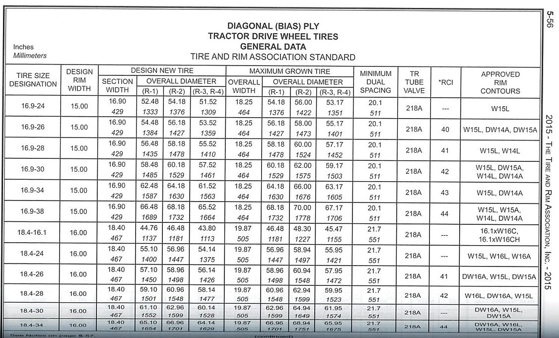

I will try to adjust them the best I can. I just found it weird that they are almost a foot longer of what they are supposed to.
