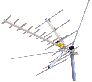

Don't bother with an antenna that includes channels 2-6. The low frequency elements are wide and catch excessive wind loading and ice loading. Not having the elements for 2-6 also reduces interference from FM radio stations .
You may be watching channels 2-6, (old VHF Low Band), but with the change to HD TV, most places they are transmitting on VHF High band or UHF, so you don't need the longer elements.
You need to verify the VHF Low Band is not being used in your area with TV Fool

Channels 2-6 are received just fine on a deep fringe channel 7-51 antenna . Channels 2-6 being low frequency will transmit farther than UHF with the same wattage .
Reducing the intermode overloading of the receiver front end with FM broadcast radio . Will also make up for not having 1/4 elements for channels 2-6.

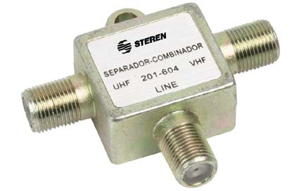

Even better would be an antenna made for channel 6 only, that could aimed for best reception, with a VHF Low signal combiner to the other antenna.

If you were to put both antenna's on the same mast you could mount the splitter on the mast also and only need 1 wire to the house as opposed to 2 if they are on separate buildings.
