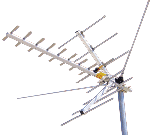

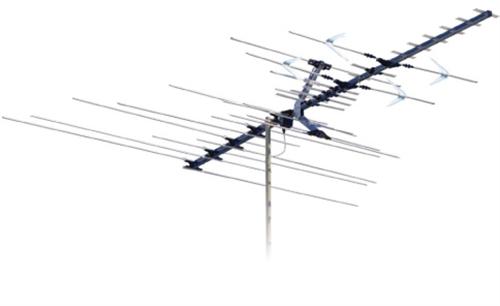

KOua, That's a lot of intake for someone in my pay grade, seeing how I'm from another country, lets recap and see if I got it or am I going backwards
Antennacraft HBU55> (UHF Range: 60+ Miles (Ch. 14 - 69) (VHF High Range: 100 Miles (Ch. 7 - 13)<<This on my garage now, and it works. and points towards Portland-ish.
Winegard HD 8200U> (Range: 65 miles, it pulls in channels 2 to 69).<<Next I tried this, didn't work, but was able to take it back to Homedepot, Yea!
Antennacratf HD1850> (UHF Range: 60+ Miles (Ch. 14 - 69) (VHF Low Range: 100+ Miles (Ch. 2 - 6) (VHF High Range: 100+ Miles (Ch. 7 - 13)<<I tried this one and didn't work and still have it, Boo hoo...
Winegard HD 7084P) (Lo band VHF/Hi band VHF/UHF/HD/FM, RANGE 60 TO 80 MILES +Range: <<No channels listed, odd-ish. But it's on my house from last year and it works, points towards Bangor and both antennas are on a Channel Master pre-amp 7777
This only took 1 hour to look all this up as simple as I know how, so guys and gals, Riddle me this, in laymen's terms WHY<is it this FM Trap thing or not???????????

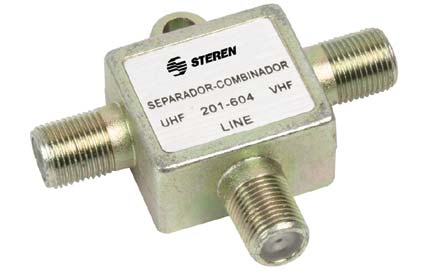

Without hooking up your coax to a portable field strength meter it is hard for me to tell 1500 miles away why your installation did not work.. previously I mentioned double checking and or substitution of any baluns and coax and its connections. Coax can be checked with an ohm meter and and aligator clip on the far end to check continuity. Baluns not so easy.. best just substitute. Also double check antenna connections and deployment of its elements. When I was doing TV antenna installations professionally (many many years ago) we had the portable field strength meter and it was very very handy to figure things out and also to get antennas pointed correctly. Just hook a short piece of coax up to the meter from the antenna and watch the meter as you rotated the antenna by hand and lock it down when satisfied.
Also are we sure your splitter/combiner is passing signals? have you tried hooking your tv up to just the antenna that does not work and pointing it around to determing how things are working.?

("Also are we sure your splitter/combiner is passing signals? have you tried hooking your tv up to just the antenna that does not work and pointing it around to determing how things are working.?")
(75' FT Quad RG6 Coaxial Cable Black with Gold F-Connectors)<<<This is what's on my garage antenna, then theres 40' of the same thing on my house antenna, both go through this>>>>>(2512 Channel Plus 2-Way Splitter / Combiner DC and IR Passing)<< both antennas are working. BUT BUT BUT the bigger antennas did not work on my garage, I tried by-passing the combiner but still didn't work.
