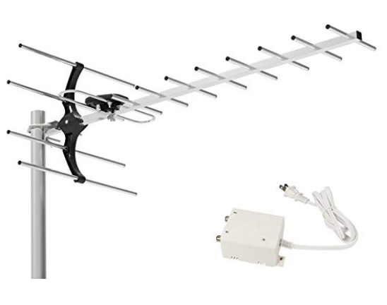

/ tv antenna #178
You are lucky they all are transmitting on UHF.
That antenna doesn't work on VHF Hi Band:
