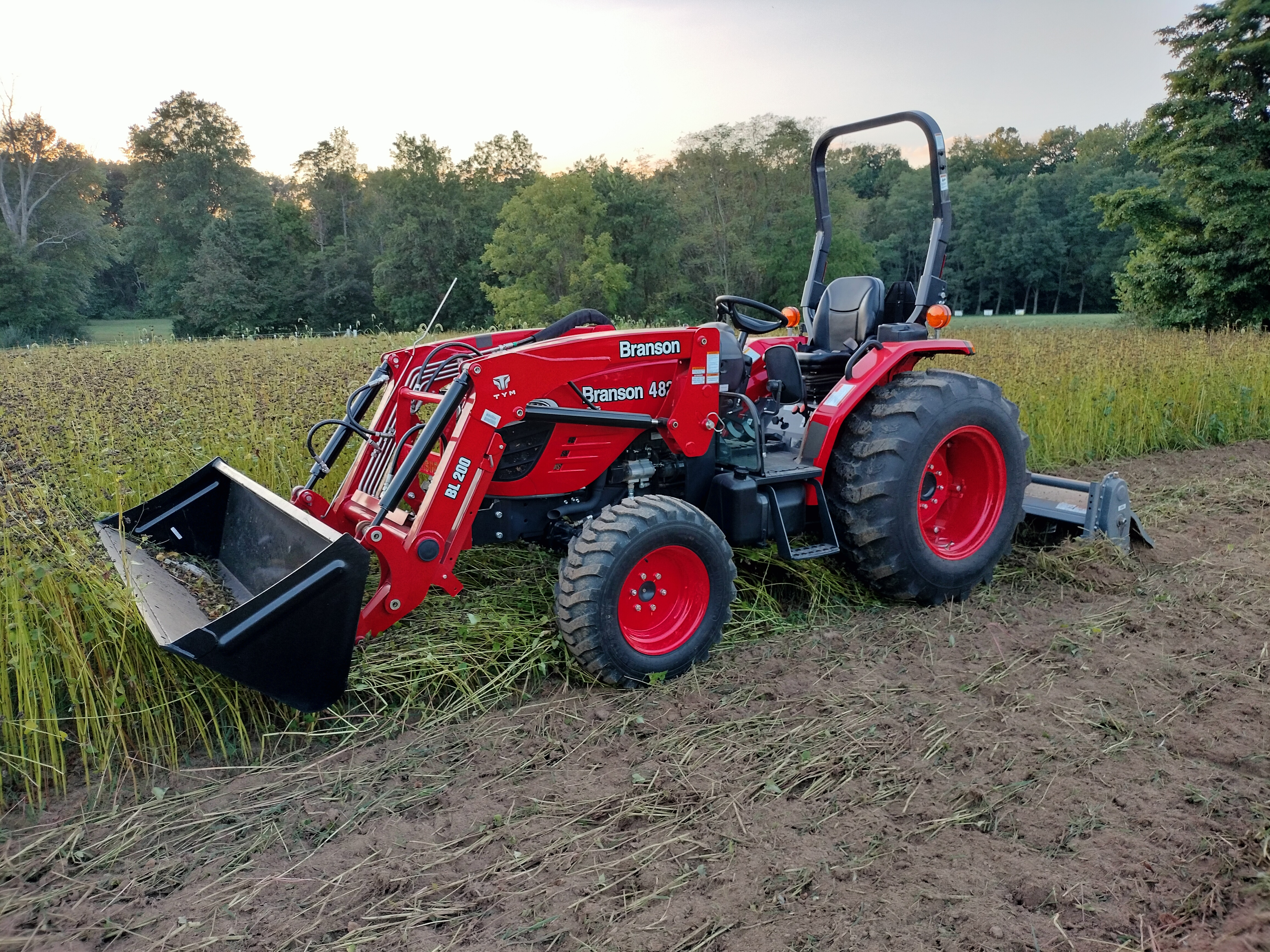

I've only had my Branson 4820 for two years... But so far it does all it's supposed to. It basically runs at 2500 RPM, 90% of its life doing tillage.
