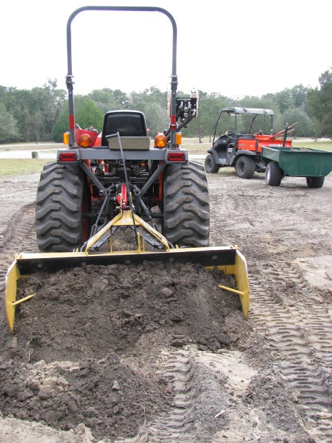

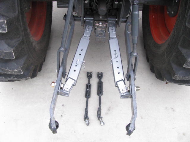

If you get pin adjustable stabilizers I think you will find implements go on/off so easily that you will not want anything additional.
Remember, the rigid, pin adjustable stabilizers greatly reinforce the lower links when you are pushing loads in reverse.
Many owners of subcompacts have bent lower links and/or the lifting rods in reverse, usually when pushing dirt with a box blade or pushing a rotary cutter into thick brush. (I bent the Kubota turnbuckle check chains the first time I tried to push dirt in reverse with a Rollover Box Blade)
Now I have Stabilworks. Check out Mark's informative video:

I made lower links in the pictures that I posted and telescoping stabilizers.

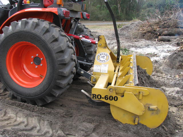

I have 257 hours on my B3300SU, which is the first tactor I have owned and bought implements for. ( I had loan of Deere/Yanmar 750 subcompact for a year before buying the Kubota.)
The B3300SU Operator's Manual, page 5, under IMPLEMENT LIMITATIONS, specs box blade at 500 pounds. Well, I wanted a 60" Rollover Box Blade and after creating a search for one on eBay and waiting for six months, the Bush Hog ROBB showed up, new-old-stock, not too far away, and I bought it. It is 630 pounds, 130 pounds over spec, so I do not blame on Kubota for deformed check chains. I have not had any troulbe pushing LOOSE dirt with the ROBB since installing the rigid stabilizers....but I am also cautious.
The ROBB was the first 600+pound implement I bought. With the factory check chains it was a struggle mounting it. Always got it on/off but the struggle, including big sweat and bad words, partly negated my pleasure using the tool. Now I get it on/off in three minutes, 65% due to Stabilworks mechs, 35% technique.
