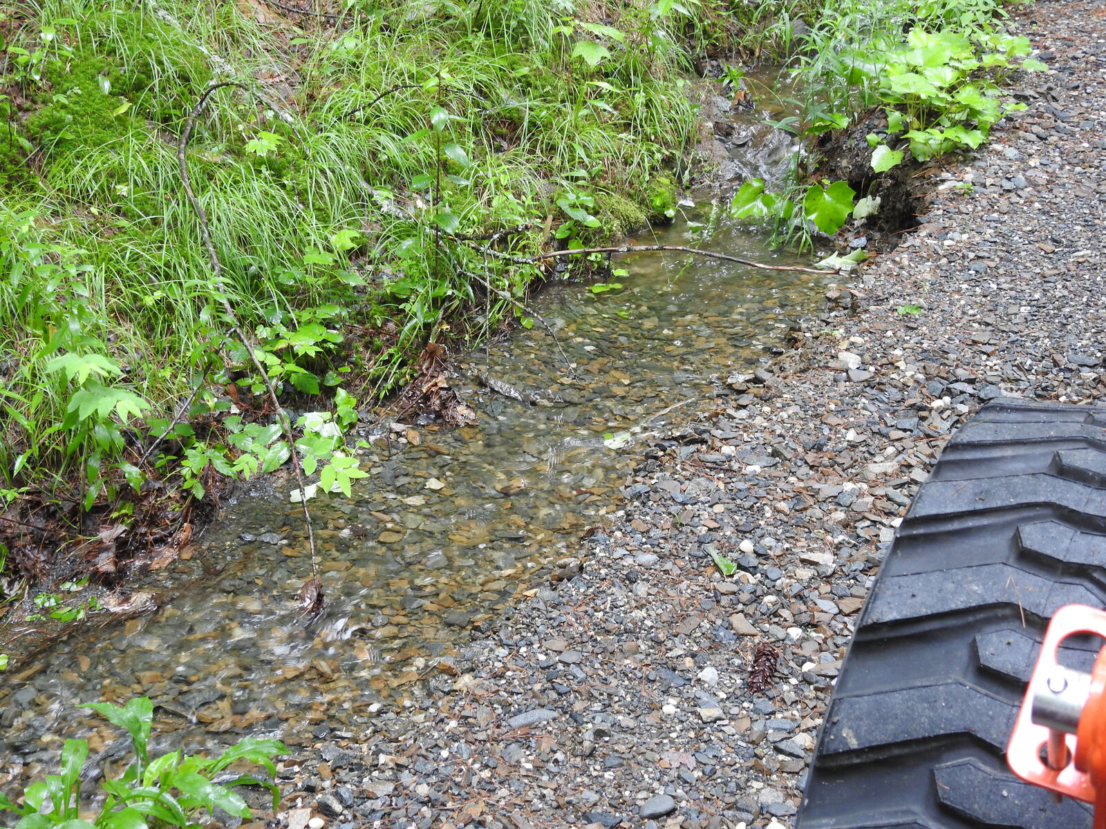

See attached photo, which unfortunately doesn't show the 10-12 vertical inch drop from driveway surface to water very well.
I have this drainage ditch along my gravel driveway feeding multiple culverts all in the hope it will keep my driveway from washing away.
Mostly it works. Most of the length of the driveway the bedrock is right at the base of the ditch. It probably is here too, the pebbles you see are the gravel it's constantly washing out of my driveway. So it's not something I can deepen with a tractor. I might be able to push it back a, but that probably wouldn't work unless I move the ditch back the whole length of the driveway, which isn't pragmatically feasible (trees, rocks, difficult spaces).
So need some way to line the driveway gravel so that the next rain won't just wash it out. I have no idea what to use. Cement / cinderblocks of some kind seems easiest, would that work? I'm looking for suggestions from people who have overcome this particular erosion problem.
I hate having to regularly throw more gravel (purchased by the truckload) at this problem.

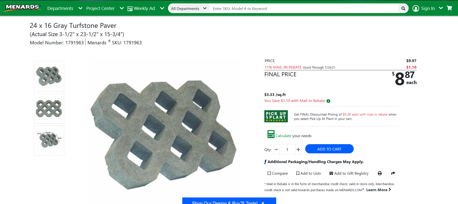

Would something like this help?
No idea, that's why I'm asking :) I was thinking of cinderblocks, they even have those solid ones that weight a ton, I don't know how much they cost. I'm still wondering if they'd need to be cemented together too, and whether the water would just work its way behind the "wall" from the top end and utterly defeat the whole scheme.

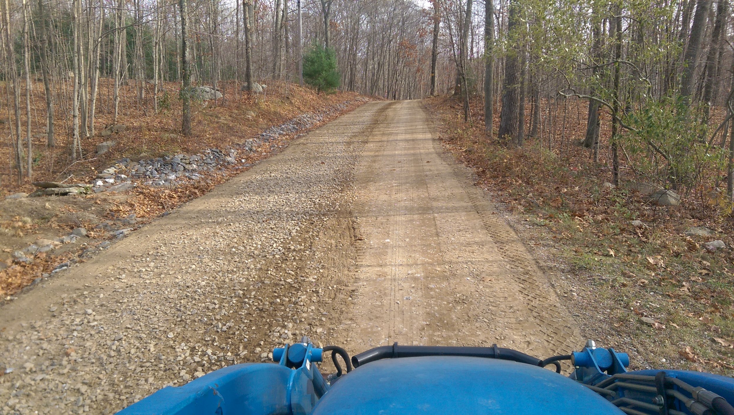

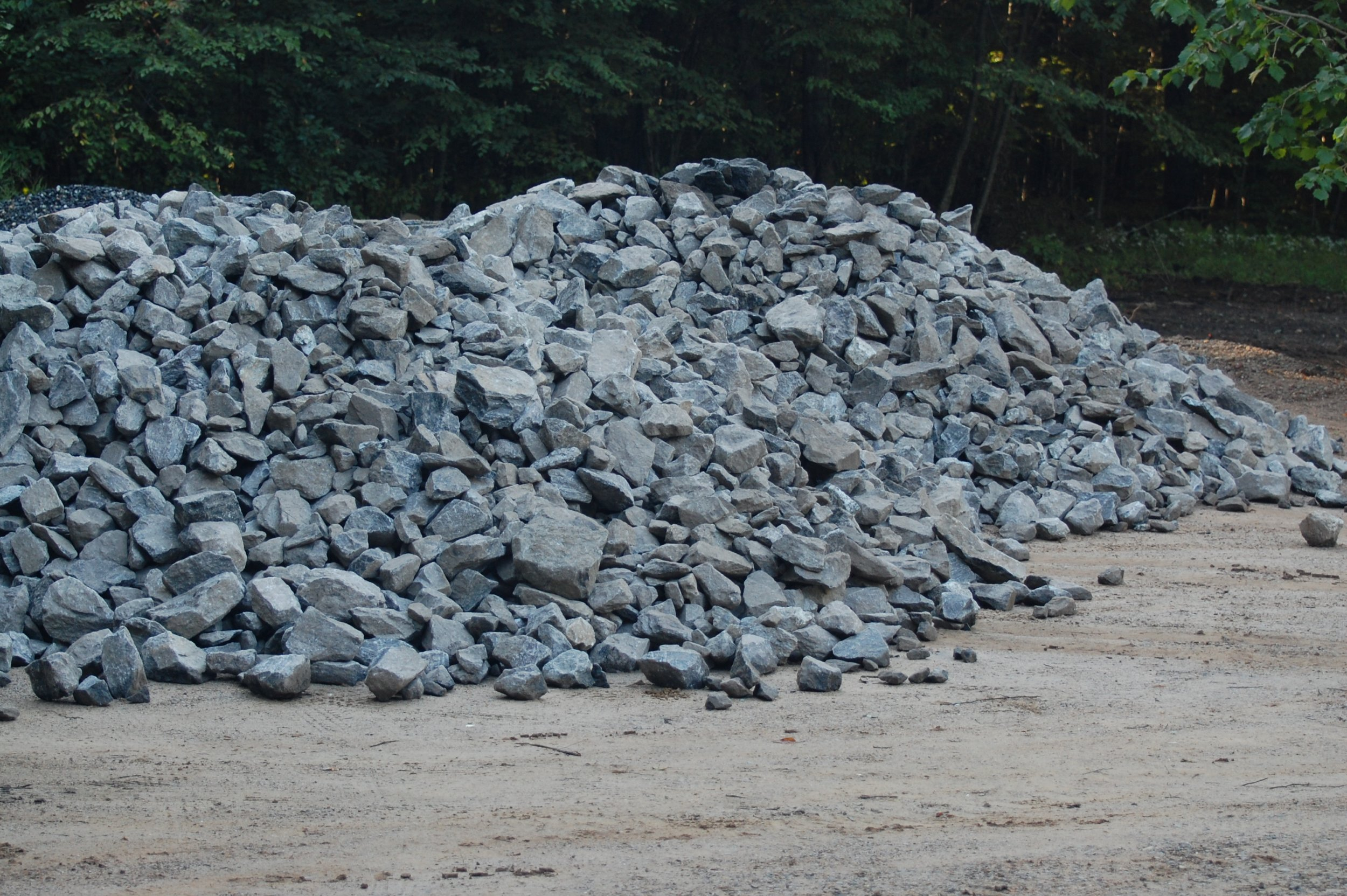

We used Rip-Rap in our culverts to help hold back the driveway process & the dirt banks.... It works with some exceptions... You will loss some gravel / process if it is loose & not compacted (especially on a hill)... The stones & fines that do do in the rip-rap will lock it together over time. You need to keep the edge driveway slope just slightly higher than the rip-rap. Rip-Rap does slow the water down some....
Here is a pic of the one of the delivered piles prior to use installing it... I believe we ordered 5 - 8 inch...
Here is a not so god pic of a small section of our driveway culvert... It will give you an idea (I'll see if I can find some better ones).... Oh, they collect leave well... :rolleyes:
Ah, that's useful. Yeah, I have some of that stuff covering a slightly buried part of drainage elsewhere. May be too big for the ditch I'm trying to fix though. Still, will think about it.
