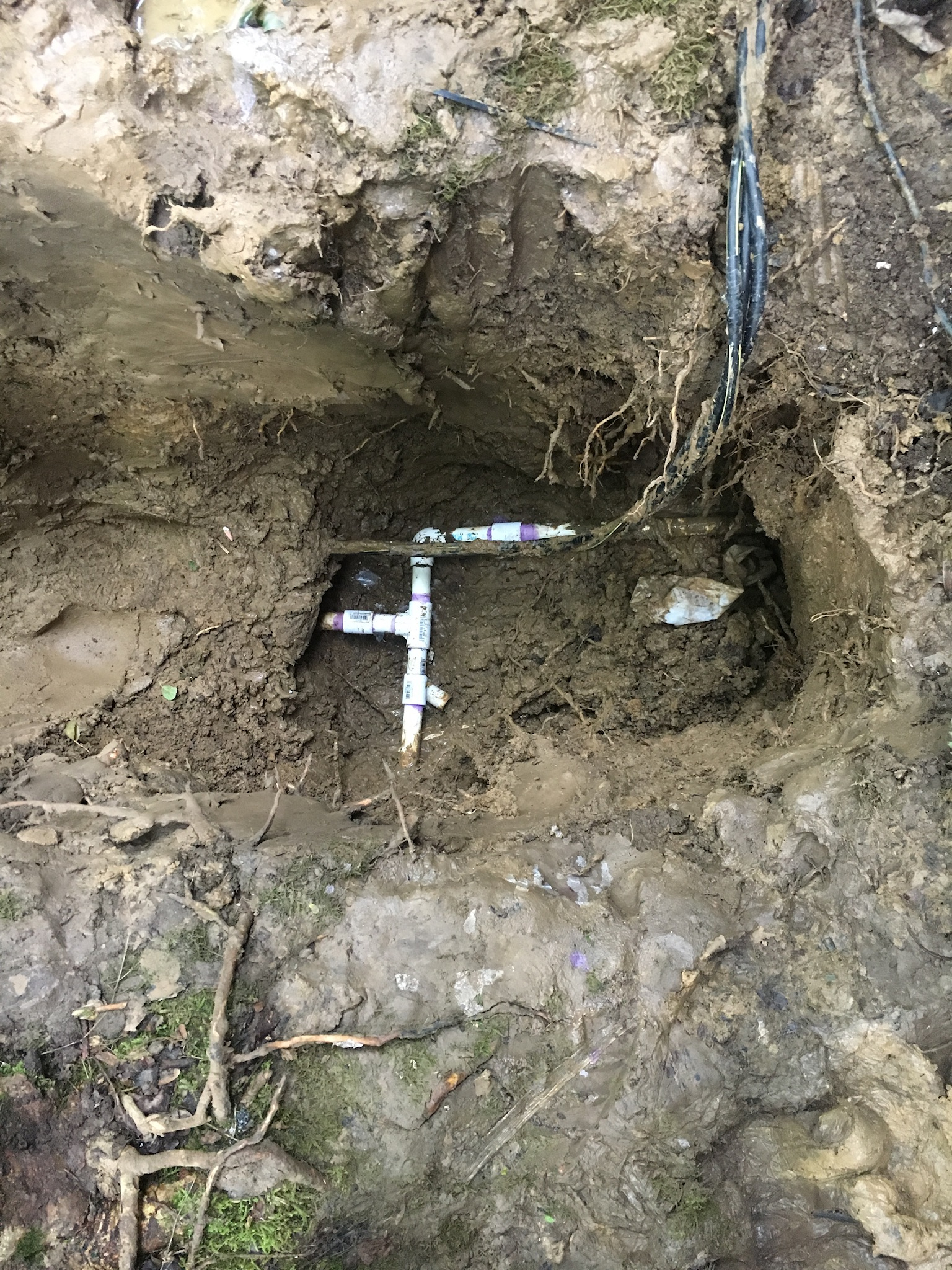

I have a cabin about 3500 feet from the road where there is a meter pit and city water supply. Original homeowner installed 20 foot lengths of 1 inch sch 40 pvc. Pressure is fine. I’ve had to dig it up and repair it 3 times in the 5 years I’ve owned it. Even more fun when they bury electrical lines with the water! All breaks at fittings. Maybe it was poor install but if it were me I’d be running pex or some sort of poly with no fittings. Our soil is silty loam.
The inside of the cabin is all cvpc. Granted it’s 30 years old but that stuff is so brittle now as someone mentioned it cracks and is an accident waiting to happen. I’ve had to fix 10 or so leaks. Plan to rip it all out but it’s rather involved and the log cabin design presents some other challenges.

Those are all couplers vs belled ends. Have you had any belled ends leaking?
