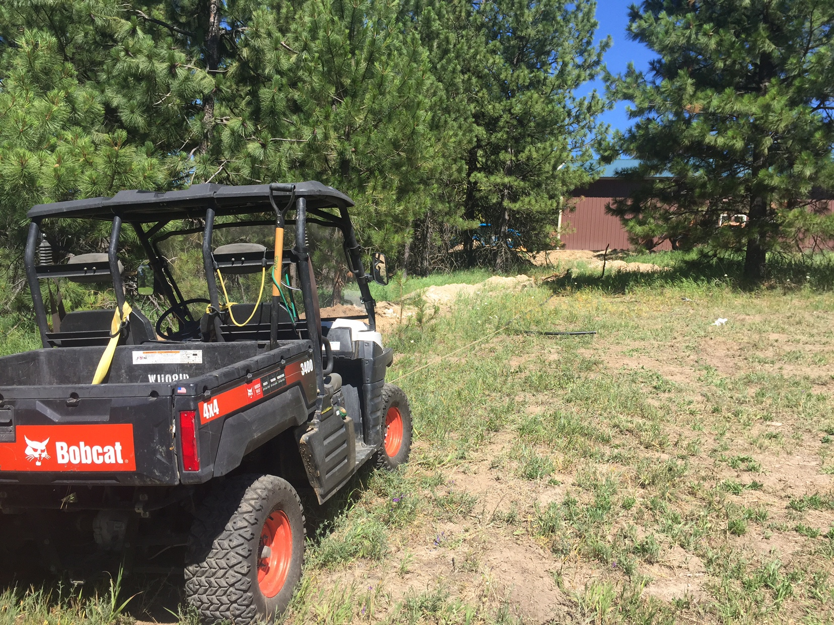

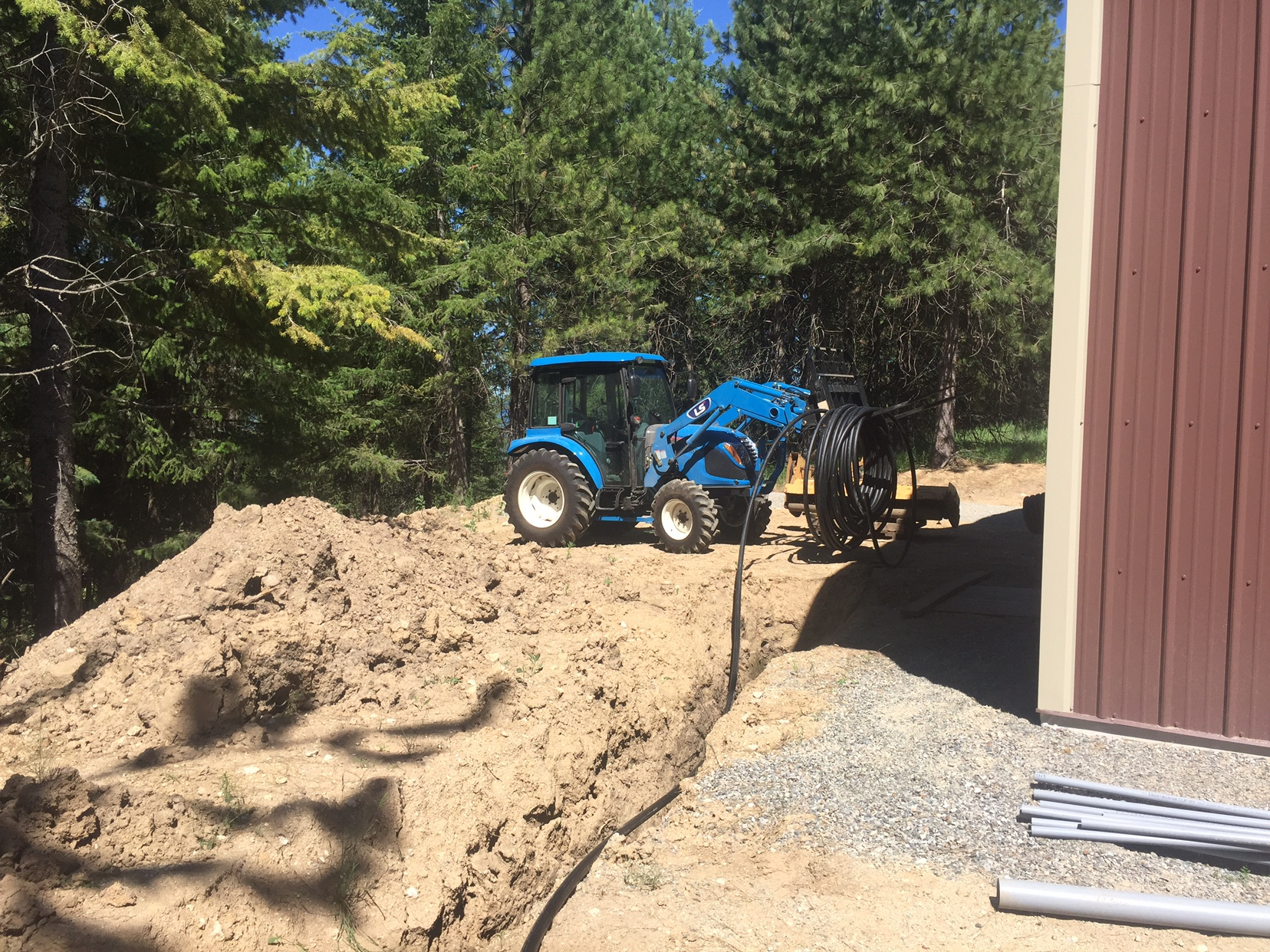

I ran 1 1/2 hdpe for my 200’ from well head to shop. Compression fittings were ridiculously expensive ( iirc ~$50 for 1 1/2, ~$80 for 2- I was considering 2” at one point).
Install can be a bugger-I used pallet forks for roll and pulled the line downhill (gently) using my UTV. Bedded in sand and backfilled.

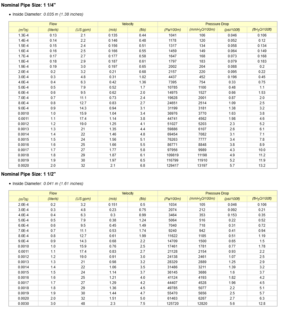

200 pound rated black poly is so much better then anything with joints,
1 1/4 will flow more then a residence will need.
1 1/4 at 19 gpm would lose about 2.3 psi per 100 ft.
Anyone on a domestic well will usually only be at 10-14 gpm, many are only 5-7 gpm.
Farm wells may be higher but depending on the area many will not exceed 20 gpm.

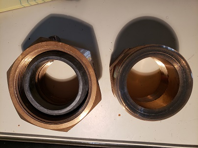

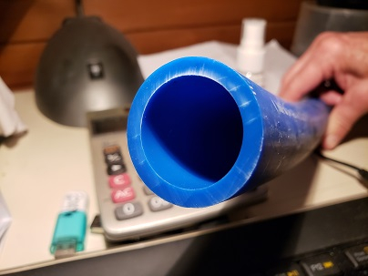

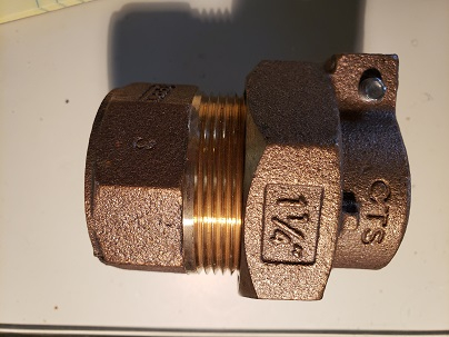

I originally ran my water line 700' in 3/4 pvc. 40 years ago. It did pull apart in only 1 joint. 5 years ago, I replaced it with 1 1/4 " Poly - Very thick walls and very stiff tubing. Came in 500' rolls. The fittings were offered in bronze and plastic. I choose bronze. This pictured is a union. I used one union and 2 end fittings on ends of pipe.
They are tough and very solid and watertight. I bought 3 fittings, I think they were about$45 each. Not too cheap, but good. Maybe I should also mention this in the Ozarks - Any hole deeper than 1 1/2 foot has been dug with dynamite. I bought this pipe at the plumbing supply. This is what the city uses for water lines. Best wishes, Larry

Ya, those were like the fittings i used, but mine were 2” fittings.
