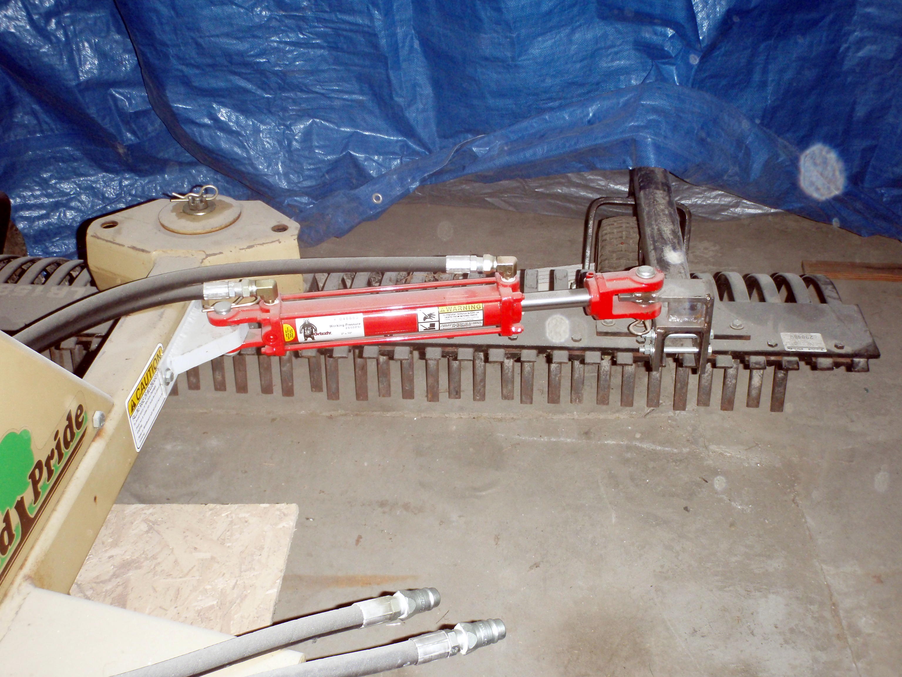

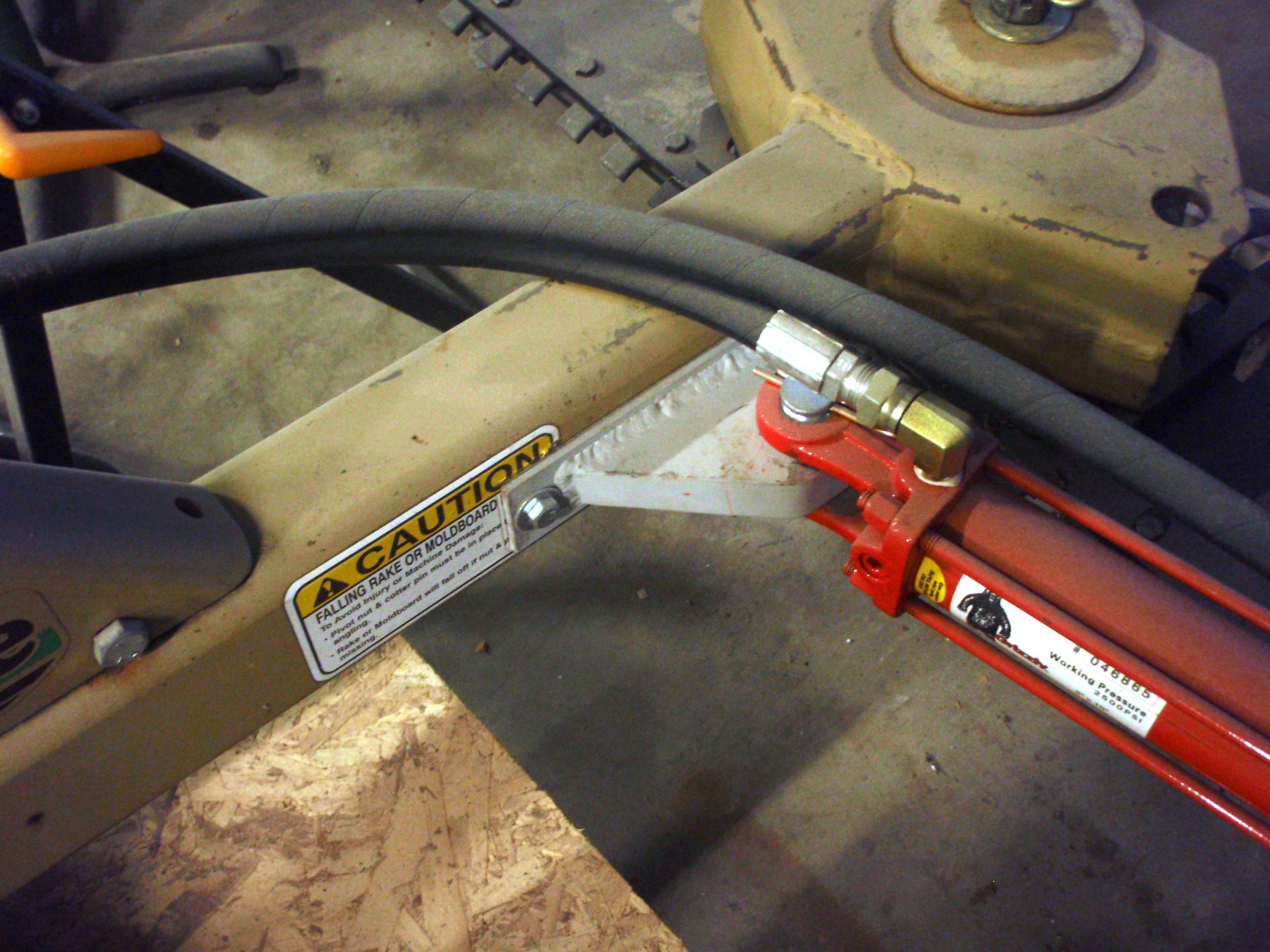

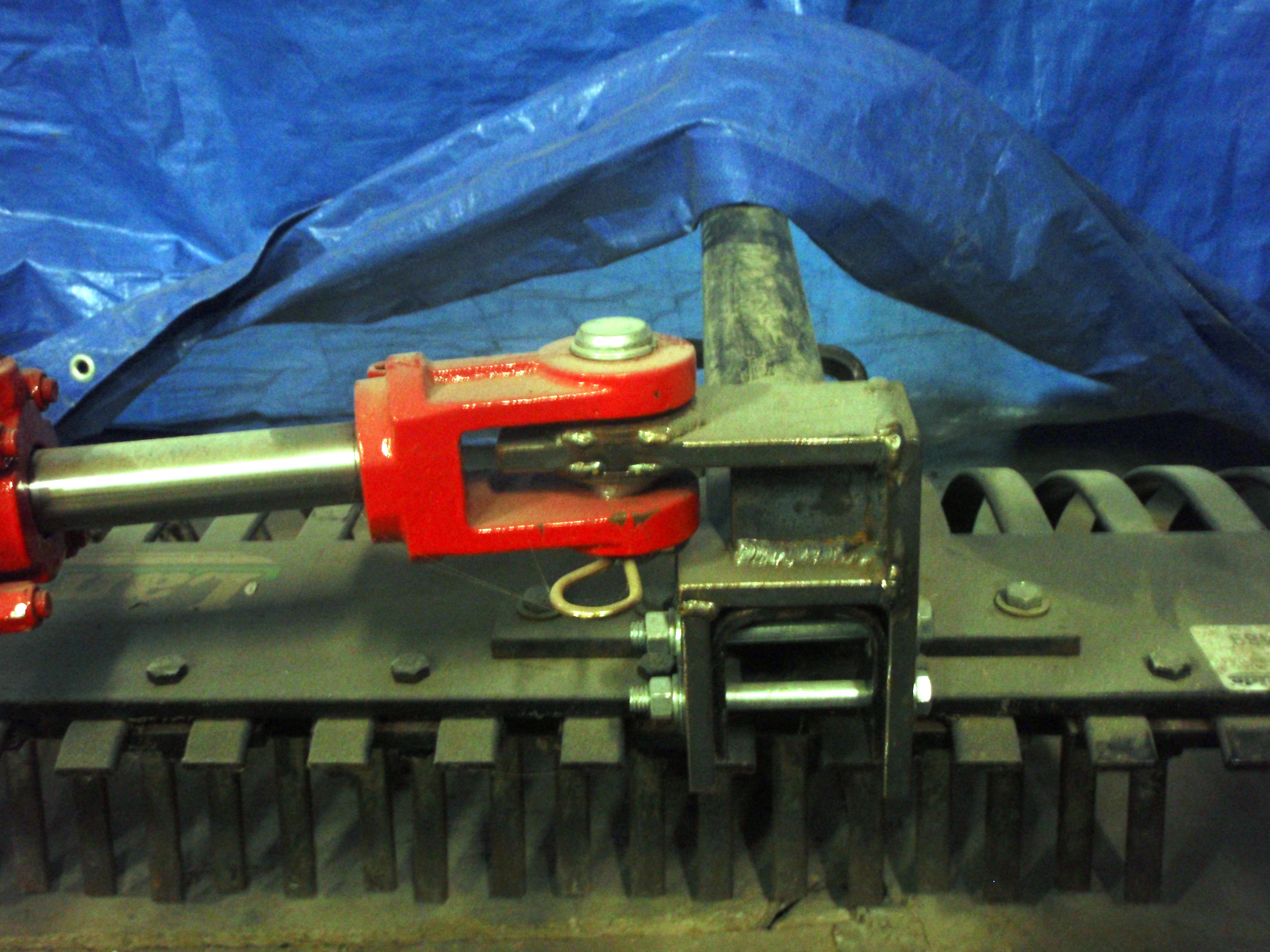

Hi All, over the winter I welded some bracketts to attach a hydraulic cylinder to my seven foot Land Pride rake. It was a real pain to hop off the tractor everytime I wanted to adjust the angle of the rake so I fabricated this (see below). I noticed after much research on this site there are 3 different ways or positions to go about attaching the cylinder. For me it seemed this was the easiest as the construction of the rake kinda determines the attachment points. Im still practicing my welding and havent quite gotten down the "row of dimes" a good weld looks like. But I have found that by holding the piece that was welded perfectly horizontal and applying liberal amounts of paint it tends to hide any ugly welds. (its important the piece is horizontal or the paint will run)

If your MIG welding dont try for a "stacked dime effect" thats Tig welding. I see people trying to achieve that look while mig welding and they whip their puddle around. Just angle your nozzle 5 degrees or so and push the puddle as smooth as you can. Consitency is the key.

Two observations though, looking at the weld on the toothbar makes me think your shield gas needs turning up a little, second I think if you did this again I would set the cylinder at a 45 degree angle when the rake is straight. This would lower the forces on the cylinder dramatically.
Jenk, Thanks for the tip on the gas. Also great idea on the angle of the cylinder. Wish I thought of that.....makes sense...........I may see if I can move it........... John
/ Welded up some bracketts for a rake #8
I thought I recognized the cylinder as tractor supply,
As far as the angle of the cylinder goes, I don't think there will be any great stress the way it is unless your angling while on the ground under load, even then it looks pretty stout. But it looks like since you just have that bracket bolted to the rake you could easily slide it forward for any angle you wanted, might need a longer cylinder though.
The way it looks now, you would not get alot of inward travel on the cylinder? or is the cylinder midway with the rake square?
I seriously want to do this for my rear blade so I've got a good model to follow especially that bracket on the main frame of the rake, very simple.

Jb, thanks for your kind remarks. The rake travel is the same in both directions (the cylinder is midway and rake is square) it travels the same distance as when it was a manual rake......good luck with yours,, John

I agree that it looks stout enough and that the OP did a nice job. The forces on the cylinder while in a fixed position are just as important as when the cylinder is being adjusted. I simply meant that where practical setting up the cylinder at a 45 degree angle from the pivot pin is adviseable.
