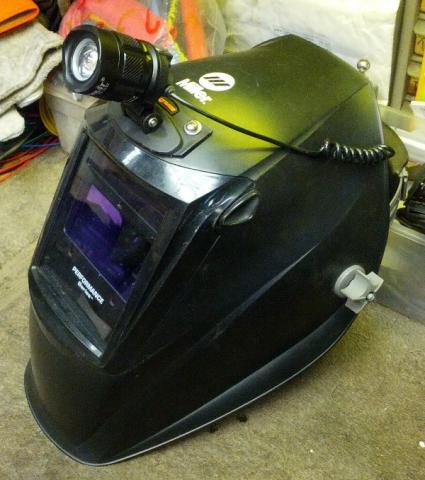

I had cataract surgery 4 years ago, and took the far vision option.... At computer I and general reading I use 2.5 diopter cheaters.... For welding I managed to insert a 2 and a 1 diopter cheater lens in behind standard AD lenses, I know its a lot, but I get better vision to see what arc is actually doing as it it washes over gap/puddle I am trying to weld.....Another thing that helps immensely is to put a lot of light on area where weld will be done, a good light source would be good quartz work lamp... Also playing with "headlamp" on helmet because a slight tilt of head puts a lot of light where I want it....
Fount htis example on I-net and I have dome something similar with small LED flashlight and duct tape till I find headlamp I am happy with to mount permanent...

Dale where did you find that light? Internet address?
My macular degeneration is killing my welding skills among other things and i’m Needing lost more light to see things these days.
B. John
Actually I have not found it yet... Pic is snatch from Google Images.... But just about any miner or cave explorer light may work.... Try to find one that is for mounting on bump/hard hat, If you find really cool on the has cool adjustments and mount I would really like to know....
