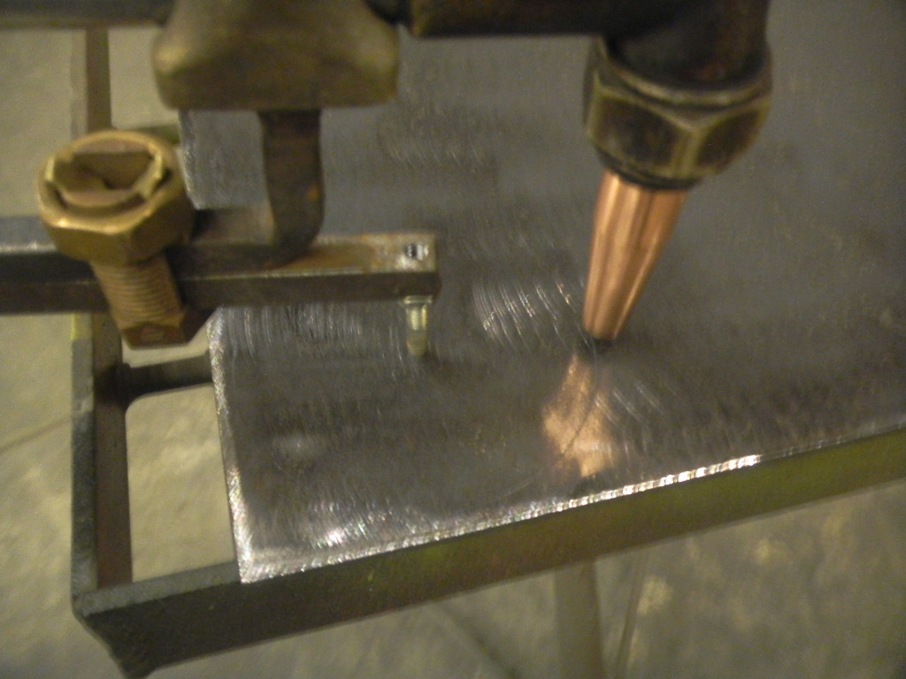

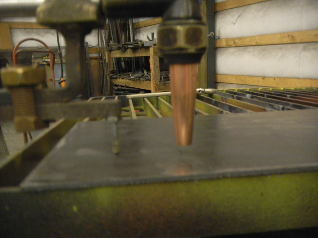

Please forgive the pictures, it's hard to hold the torch's cutting tip perpendicular to the plate and take a picture.:eek:
If the circle cutting attachment is built correctly the horizontal, (long key stock) will be 90-degrees to the cutting tip. Once the height is adjusted for the pre-heating cones of the cutting tip, the correct radius is set, you can either watch and make sure the cutting tip is 90-degrees to the plate, or the long key stock is level to the plate. Personally I watch to make sure the tip is 90-degrees to the plate, then I can also adjust my travel speed at the same time. ;)

   / Welding table build #123
Not quite what I meant...that sets the initial height but what keeps the torch head from dragging? Been a long time since I've used mine and was only self- taught at that. I know you need to keep a bit of space between the tip and material with a plasma cutter, doesn't a torch work the same way?
I've seen some simple homemade versions of rollers that are attached to the base of the cutting tip. They consist of a couple rollers with an adjustable height to keep the tip the right distance from the plate you're cutting. But you would have to allow enough room from the edge for the rollers to travel, or else place the rollers back behind the tip.
I don't have any now or I would take a pic. You could do a Google search and probably find a pic.
I'm so shaky any more with a damaged nerve in my elbow, I need to make a set-up like Shield Arc's. I like the simplicity of his version with the key stock and electrical split nuts used as brackets. And I'll probably also make a set of rollers for the tip. :cool:
   / Welding table build #124
With a little practice it's not hard to hold the tip at the right height. I tried a circle cutting attachment once that had rollers and didn't like it. If there's any mill scale or the plate isn't perfectly clean, it's hard to do a steady even cut.

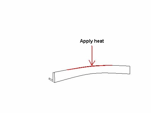

Hopefully a few of you from early on will still see this and can help me out. Kinda hijacking my own thread but hey, it's mine and what I need help with was built on this table.....
We had a very useful conversation on flame straightening and had it not been for this thread, I'd have never heard of it, nor realized that I have likely a good application for it.
Today I welded up my skeleton bucket (firewood bucket, bottom half of a grapple, whatever you want to call it). 3.5 x 1/4 angle as the back bones, 1.75 x .120 wall for the tines and 2 x 1/4 angle for the front stiffener.
The heat from welding the tines to the main angles bent the angles approx 1/4" over the 5' length, which has put a nasty twist to my bucket. This is after painstakingly measuring and squaring, double and triple checking and alternating my welds all over the place to try to help eliminate warpage. Now my new bucket looks like shiat and I haven't even burnt in the final welds on the bucket mount. I can't even get it.properly mounted on my loader to tack the pin bosses in place.
Unless you guys advise me otherwise, I'm thinking the best course of action would be to heat the top flange of the angle to draw it back into place. To me this seems like a good application of flame shrinking.
Having never tried it, (and been more than 10 yrs since I've sparked up my torches), I'm looking for any advice I can get.
   / Welding table build #129
Before I heated that wedge like you have marked out. I would first try heating the toe of the angle. If that won't pull it back enough heat the wedge, or a circle where you have the wedge marked out.

   / Welding table build #130
Hopefully a few of you from early on will still see this and can help me out. Kinda hijacking my own thread but hey, it's mine and what I need help with was built on this table..... We had a very useful conversation on flame straightening and had it not been for this thread, I'd have never heard of it, nor realized that I have likely a good application for it. Today I welded up my skeleton bucket (firewood bucket, bottom half of a grapple, whatever you want to call it). 3.5 x 1/4 angle as the back bones, 1.75 x .120 wall for the tines and 2 x 1/4 angle for the front stiffener. <img src="http://www.tractorbynet.com/forums/files/welding/404886-welding-table-build-forumrunner_20150101_183040-png"/> The heat from welding the tines to the main angles bent the angles approx 1/4" over the 5' length, which has put a nasty twist to my bucket. This is after painstakingly measuring and squaring, double and triple checking and alternating my welds all over the place to try to help eliminate warpage. Now my new bucket looks like shiat and I haven't even burnt in the final welds on the bucket mount. I can't even get it.properly mounted on my loader to tack the pin bosses in place. <img src="http://www.tractorbynet.com/forums/files/welding/404887-welding-table-build-forumrunner_20150101_183054-png"/> Unless you guys advise me otherwise, I'm thinking the best course of action would be to heat the top flange of the angle to draw it back into place. To me this seems like a good application of flame shrinking. Having never tried it, (and been more than 10 yrs since I've sparked up my torches), I'm looking for any advice I can get. <img src="http://www.tractorbynet.com/forums/files/welding/404888-welding-table-build-forumrunner_20150101_183103-png"/>
Your in good hands with SA.
BFreaky is also a master at prepping, fitting, clamping and welding. His stuff always turns out straight!
Thanks, I'll give that a try. I'm guessing heating the full length will create a more even pull than the wedge which is obviously concentrated?
How do I tell how much to heat it?

I did go back out and have another look at it though. There are 2 distinct spots where it is bent. In this pic, you can see the 2 lines with the zero beside them, those are the apex of the bend. Still straight between the 2 marks. On the left side, it's 1/4" out at the end and on the right, it's 1/8". Surprised me, I figured its would have been more consistent, with similar amount of distortion at each tine
Since I've discovered it's 2 specific bends, should I still try heating the toe or should I use the V right at these spots?

   / Welding table build #134
How much heat to apply is the trick to flame straightening! The theory of where to place the heat is the easy part, how much heat is the hard part!
Look at heating just the toe of the angle as a gradual correction. Look at heating the wedge as a hefty correction. Most likely you won't see the heating of the toe after it cools. The wedge will produce a small kink, that will be visible. At first try heating the toe of the angle right where you can see the bend, use a straight edge to find the bends, If heating the toe doesn't work, then heat a wedge.

Got tanks for my torches today and gave it a whirl. Started heating the toe as suggested and quickly got fed up with it and heated the first wedge. Hit it with some water to speed the cooling process and by the time it was cool enough to touch with bare hand, I still didn't see much movement. Ugh.
Round 2... Got out a 6' piece of 5" channel to use as a strongback with a couple clamps. Heated at the next 2 marks, clamped on the strongback heated some more then drew the clamps in as far as I could. Something still didn't seem right and there was still some gap. Measured for square from top corner to front tip and was out an inch. Yikes. Dug out two 2" ratchet straps. As there hadn't been much cooling yet, I reheated again and also heated the lower angle iron. Cranked on the ratchet straps till they were fiddle tight which drew it 1/8 past square. With the extra force of the straps and clamps, as it cooled on its own, the last 1/8" gap closed up. Fingers crossed that tomorrow when I undo the clamps and straps, it's close enough.

Looks good. Maybe (if you need to) shim up the centre a bit, reclamp and reheat. As to your earlier question regarding how much is too much heat, I was going to reply if it bends back TOO far you've used too much heat but figured you probably weren't in a position to appreciate my humor (or lack of):D Terry
Edit:just noticed you DID bend it past square.
#139
Oh yes, I'd appreciate the humor lol. No problem on that. Its kinda like giving directions and saying "its the last road before you get to xxxx". How do you know its the last one unless you've driven by? Or the farm I worked summers on in highschool.... Backing self-unloading wagons into the shed for winter storage, I stopped the tractor and got off cause I couldn't see my guide anymore (full-time farm hand). Told him I needed guidance as to how close I was and to stay where I could see him. His response was he'd let me know when I'd hit something.... Like I wouldn't have already felt it. Dumb a**
When I pulled it with the straps, I went the 1/8 past figuring there'd be a bit of spring back. If when I unclamp tomorrow, I find I still want more correction, do I heat the same spots over again (assuming I'm still trying to work the same spot) or do I go just beside ?

I would try warming up the same spots only over a slightly larger area.
If that doesn't work you should have done it the other way.
