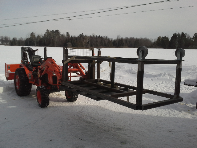

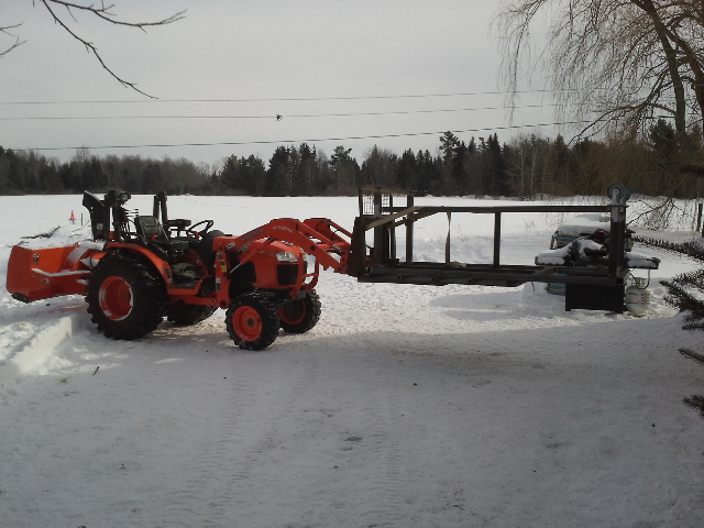

As the only choice I had was to try to pick it up from the end, I had nothing to loose but to give it a shot. Picked it up much easier than I expected. I'll have to calculate the weight but it's less than my racks of firewood that pretty much max out the lift capacity.

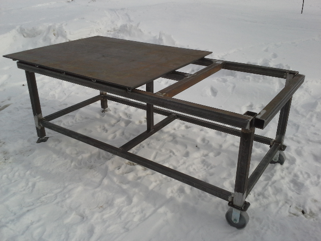

Upright for the first time. A bit of welding to finish up and then on to the cutting area
It turned out MUCH flatter than I had expected. There's a very slight crown to it at the 4' end. Less than 1/16" total and it flattens out by 8" from the end. If I check the 5' direction, its flat as my level so my methods worked to keep it flat after I straightened it. YAY!

Are the corners that way to insert/attach accessories?
Winner winner!
Anything on a 2" tube can mount either direction off each corner. Saw and vice at the moment with a couple other ideas in the works. I'd seen the idea on a couple different ones as I was searching but they just left the main side tubes run long. I figured why limit it to 4 spots when its easy enough to do 8 then I can mount anything anywhere to suit the project at hand.
The center monted receiver is actually intended for a hitch to make moving it easier
   / Welding table build #90
Thanks for the explanation. You have thought this out. I wouldn't have thought of doing it.
