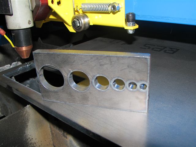

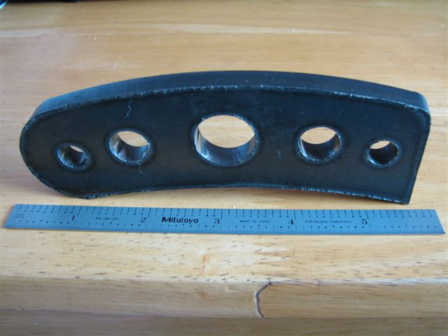

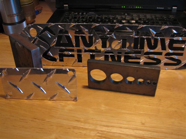

I work for Hypertherm....have been plasma cutting for 32 years. In my home shop I have 3 Hypertherm Plasma systems.....a Powermax30 with a hand torch, a Powermax45 mounted on a 4 x 4 cnc machine, and a Powermax1000 plasma . Hypertherm units are the top of the line when it comes to plasma....not the cheapest to buy, but after considering cut capability, consumable life, cut speed, cut quality and system reliability...they are by far the cheapest to own over time. Here is a picture of a few of the cuts out of my home/farm shop!
