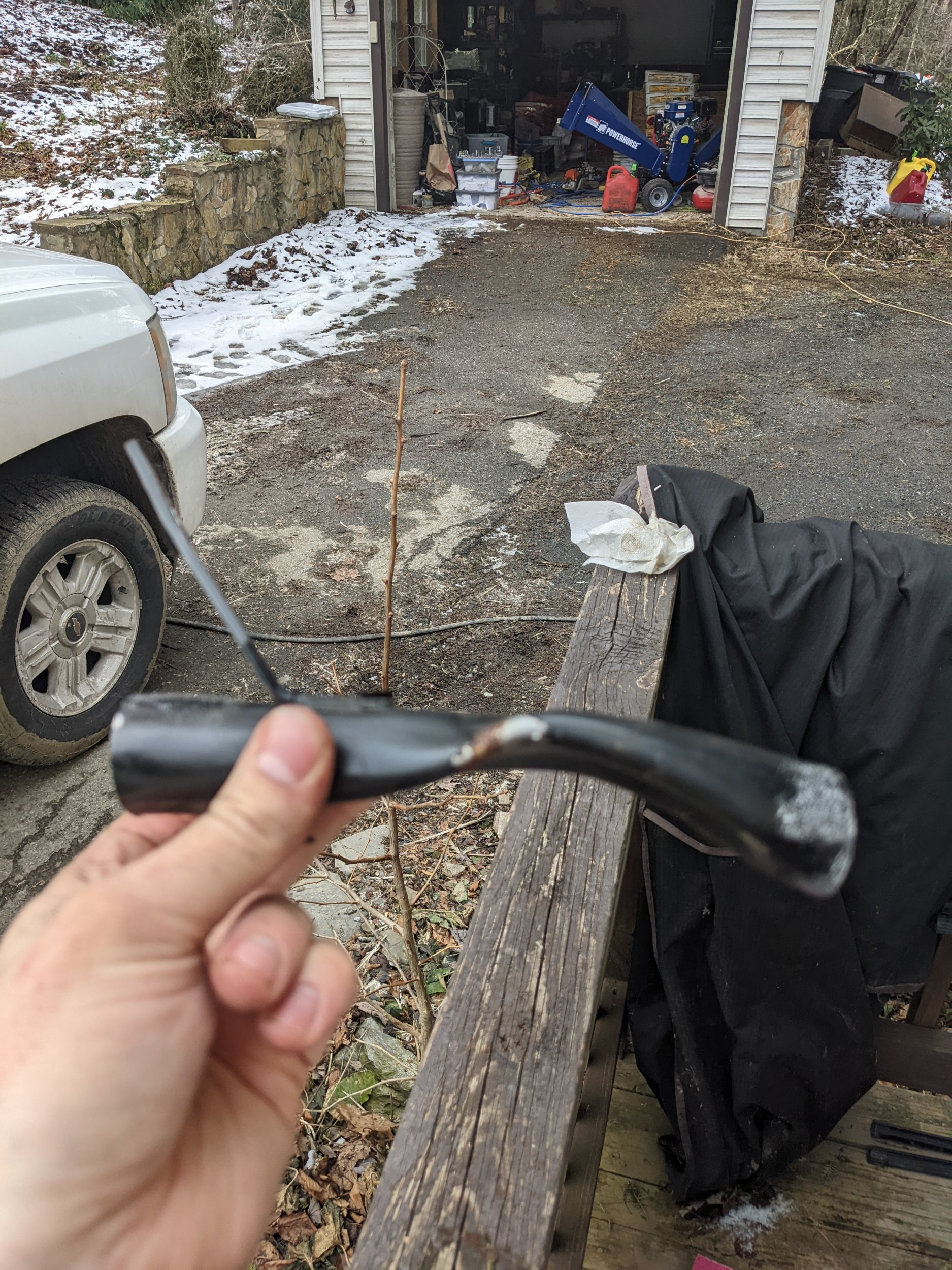

Those bolts may be pretty tight. It may be easier to drop the loader and unbolt the frame to lower it so you can get a good socket on it.
If the pipe looks to be ok with no holes and is not more in danger of being snagged, I might would be tempted to get a longer hose to reconnect to the filter housing. Just a thought.
I may wind up having to go that route in the end to get the tractor into a limp mode.
I got the bolt off with an offset wrench, but the pipe seems to go through a hole in the frame of the tractor. Haven't figured out yet if it's even possible to feed the pipe through the hole and pull it out given the pipe's twists and turns.

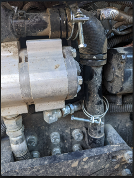

Well I got the return line *mostly* fixed and in an operational state. I bought an entire new pipe and then cut the old pipe and new pipe at the same place, then coupled them together with a 90 degree hydraulic return line elbow.
After the fix and a hydraulic refill I was able to drive the tractor 20ft so it's no longer on the side of our mountain.

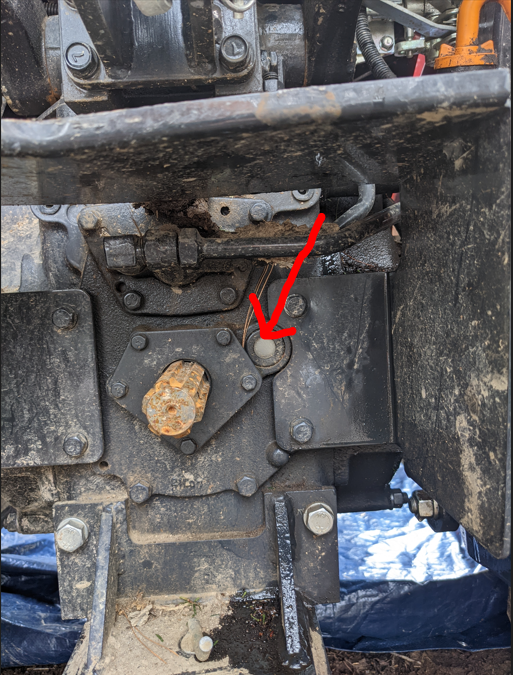

2. I believe when I guessed how much oil to add, I may have added too much. The viewing level below needs to be 1/3 full according to the manual. It looks to be entirely full. Does anyone have a picture of what theirs looks like? I believe I need to drain some fluid off.

By the way, here is the piece that took the impact from the stump.
You can see how crushed it was.

Well, I took a look at the sight glass again after I parked it for several minutes, and let it sit on a fairly level surface (as level as I can be on top of a 3600ft ridge) and it looks like the hydraulic oil is actually a tad bit below the 1/3 level prescribed by the manual. You can see the dark line at the very bottom of the glass.
I added the remaining gallon that I had and that helped with the stuttering. I'm thinking I may need to add another gallon or two.

Please correct me if I'm wrong, but you cut the new pipe for ease of installment and then used a rubber line to join both halves together, right? I wonder if the rubber hose is collapsing, causing the pump stuttering.
   / What part of the hydraulic system is this?
#19
Correct, there is a rubber 90 degree elbow joining them.
Now the elbow that I used is from Branson and is rated for hydraulic suction. It's actually the same exact part as the 90 degree elbow pictured here on the suction line. I just ordered another one to join the two halves.
