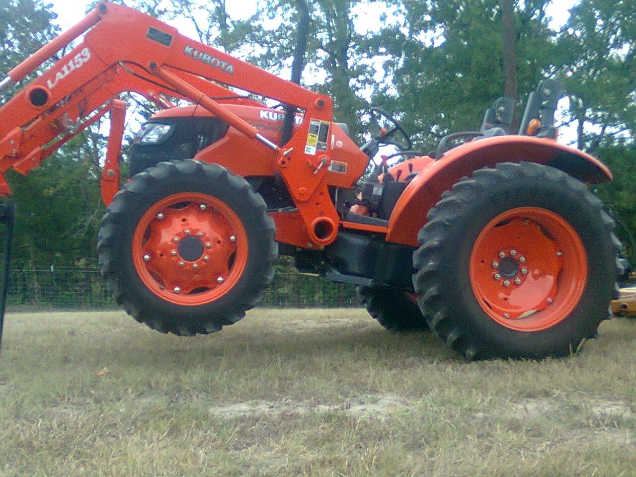

5040 and ds1440wheelie.JPG Here is a picture of my 50hp(M5040)...

That is a NICE ride Etexas!
