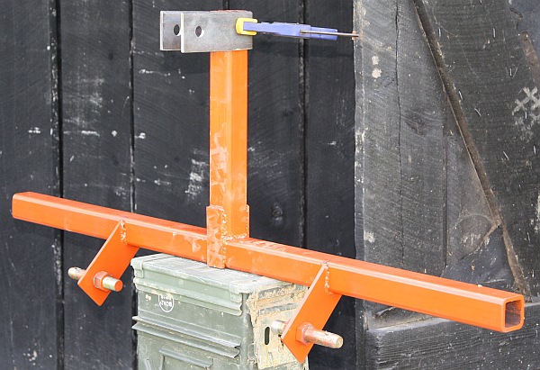

Yep, that along with the wedge bolt. Keep in mind that clamp needs a 1.5" tool bar.
I'm not going that route though. If you see what BHB did, he made a clamp out of a couple pieces of scrap plate and some thick walled tube. I'm deviating a little from that but going basically the same route. I'm trying to do this on the cheap and don't want to spend cash on the store bought clamps.

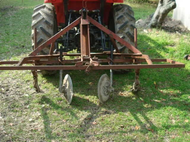

Here's what I came up with.
14" disks
4" of clearance between the disk and the toolbar.
With lower arms level, disk will be 3" below grade.
With arms all the way up, disks will be 6" above grade
With arms all the way down, disks will be 10" below grade.

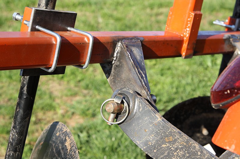

Here is what I just set up, 14" disk with 22" shanks on an old frame found in the woods at the farm. It worked fine for the ground being so wet, can only get to the farm on weekends so I have to go for it when I am there.
This clamp really holds the disc well.

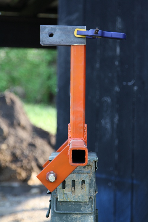

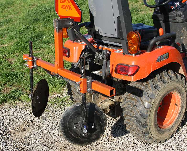

And.... here's my copy. Paint not finished on what I welded up today. It works, although I think it might need a shelf to hold a couple concrete blocks. It didn't want to cut the rain packed dirt very well. I'm still adjusting the angles to get it doing what I want it to do.
I didn't think to put a pin through the holes in the top link brackets when I welded them on so naturally it's just off enough not to allow the pin through. I got a 1/2" bolt in there. It might just stay that way. I welded it between the brackets, so I can't fit a cutoff wheel in there to cut the weld loose. :laughing:
Oh, and no complaints about my welding... I burned my first stick about 48 hours ago. :thumbsup:

Looks good! Never thought about a weight attachment, good idea. How big a hill were you able to throw with it? Mine works better when the soil is fairly dry. Does a good job on the potato rows. Mark
   / What size hiller disks to buy?
#19
It wouldn't do much without several passes. Ground is wet and packed from the beating it got from the rain the past couple months.
I wanted to plant corn tomorrow and thought to break the ground up, I would pull a deep furrow with the middlebuster and then toss it back in with the hiller. Looks like they're forecasting rain again tomorrow though. :(
I couldn't let that top link bracket stay crooked. I cut three welds and the 4th broke with just a little encouragement from a hammer. Ground the old weld off, put a pin through and welded it back on. Got it painted this evening.
Now I'm looking at adding a second toolbar so I can mount 2 rows of cultivator shanks. The extra square tube will add to the weight also so the hiller should work better.
Ian
