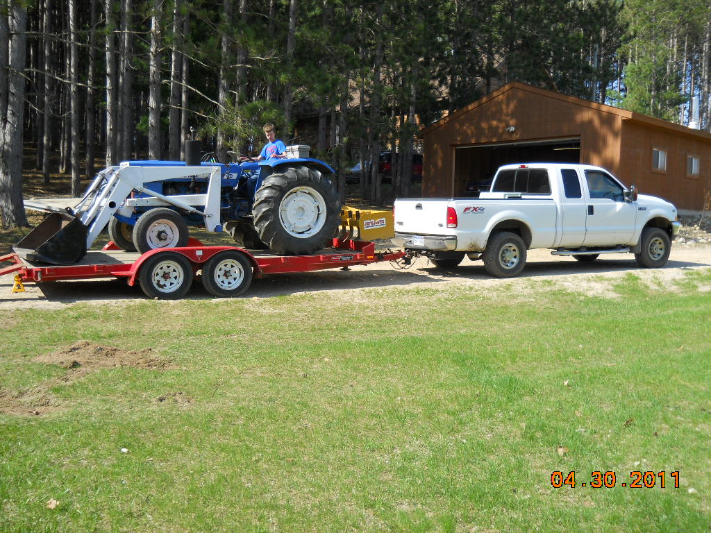

My tractor has a FEL and a box blade on the back. I haul it on a 16 foot car hauler trailer with dual axles and electric brakes. My trail is made by MacLander and has pull out ramps. My tractor is a full size farm tractor and it fits just fine. The box blade hangs over a little bit but so what? I dont haul too far though because my tractor weighs 7000 lbs and is way too heavy for my trailer but it still does the job. Trailer and tractor combined put the total weight at around 9200 lbs. I pull with a Ford Superduty V-10.

sounds like a 10k or 12k trailer is in order :)
trucks fine. :)
