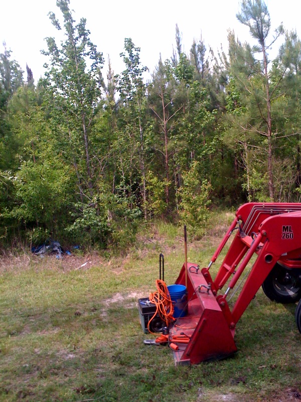

I did not put these shackles on my bucket I bought the tractor used.
But these are the handiest things to have , I can not tell you how many times I have used them in the past year. I know this much if I ever get another tractor with a FEL the first thing I will do is get some welded on my bucket

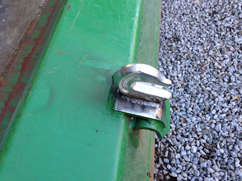

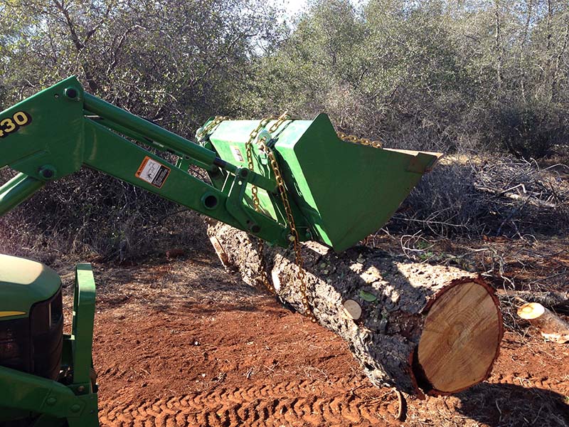

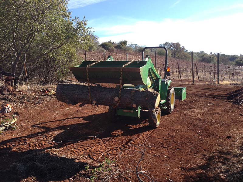

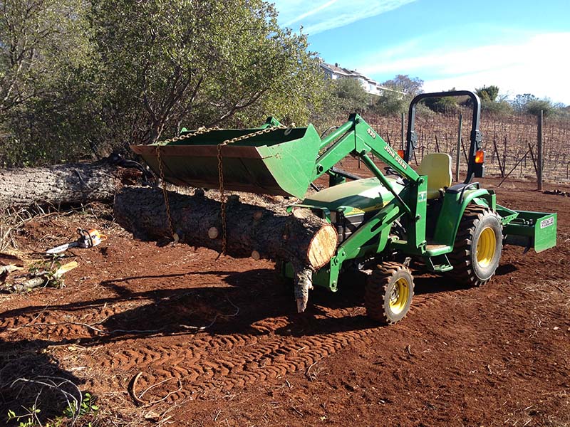

Thanks to this forum topic it has helped me successfully add a few hooks to the JD. I plan to add a 2" trailer set-up on the center of the bucket very soon.
I had two 40+ foot pine trees fall last winter and needed a way to move the 6-8 cut sections.
See the results in the posted pics. I painted them JD green.

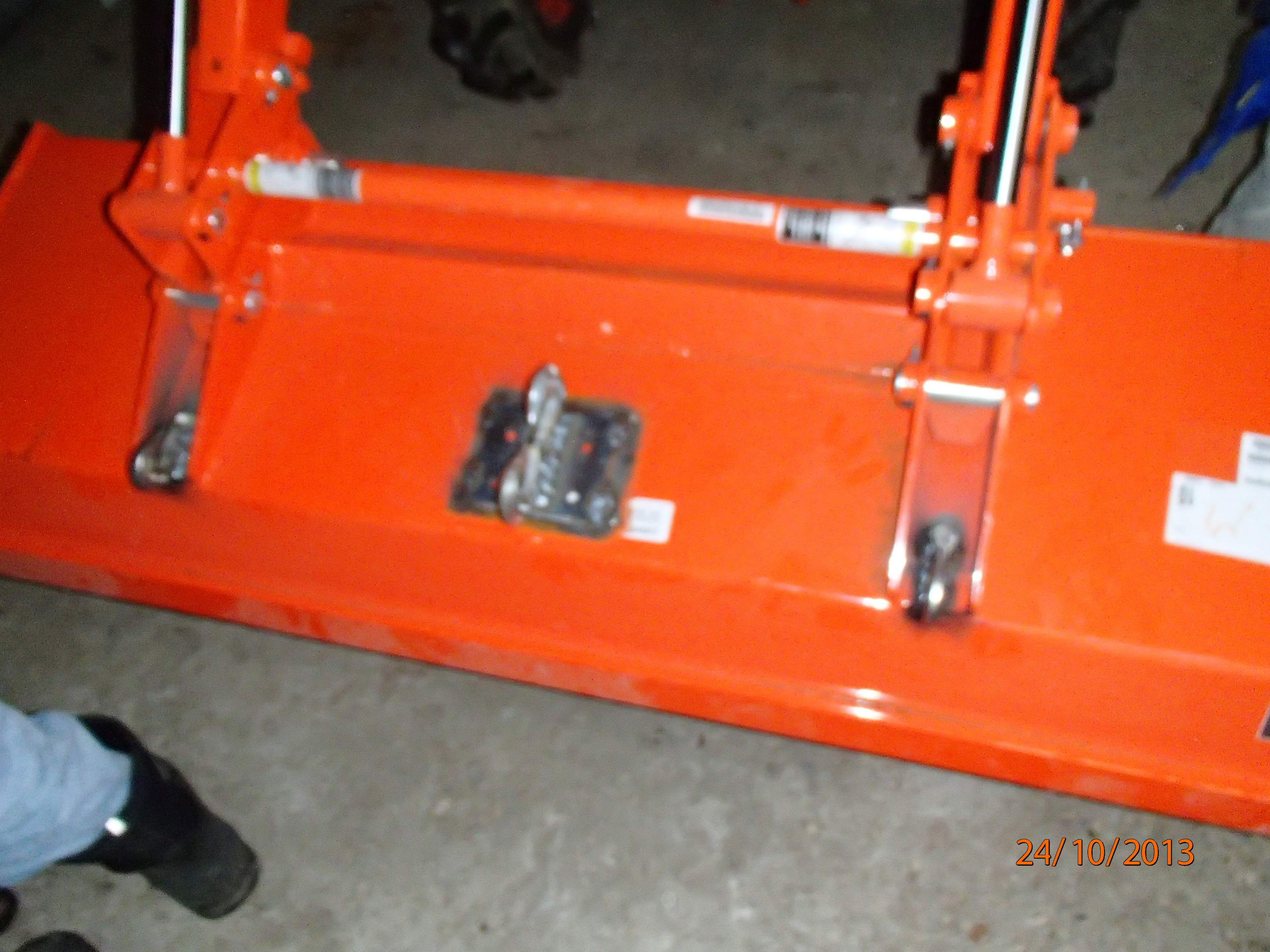

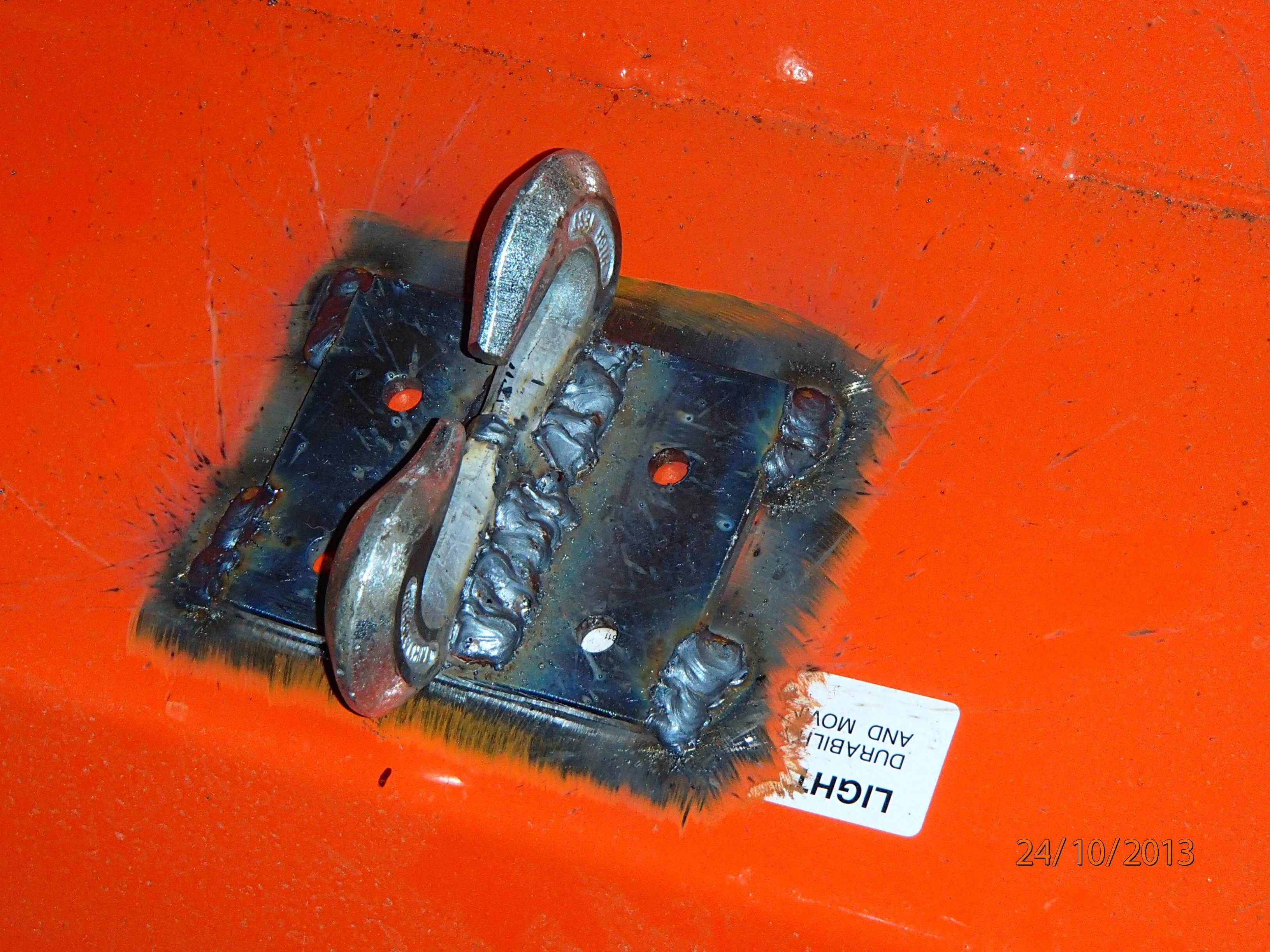

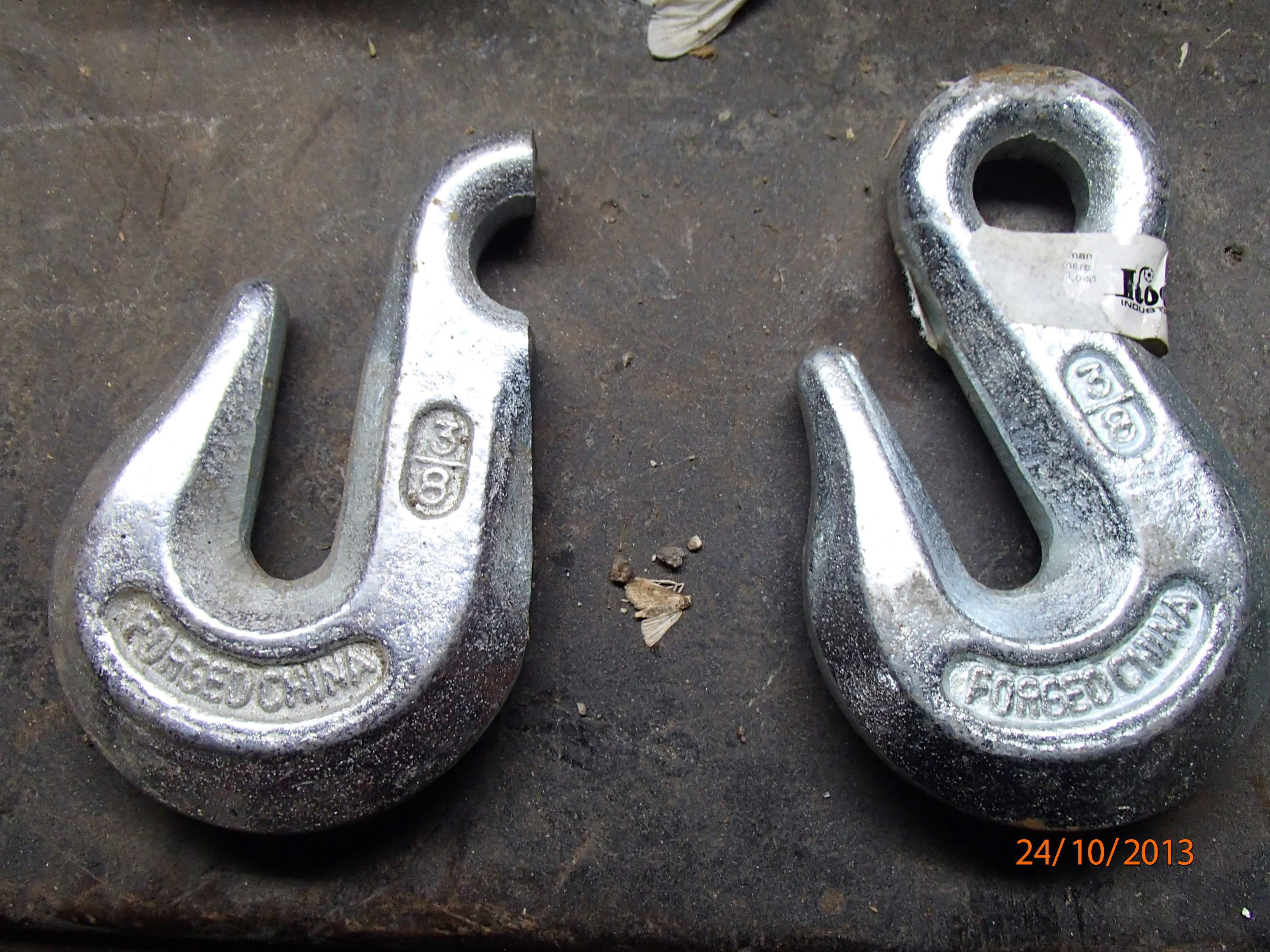

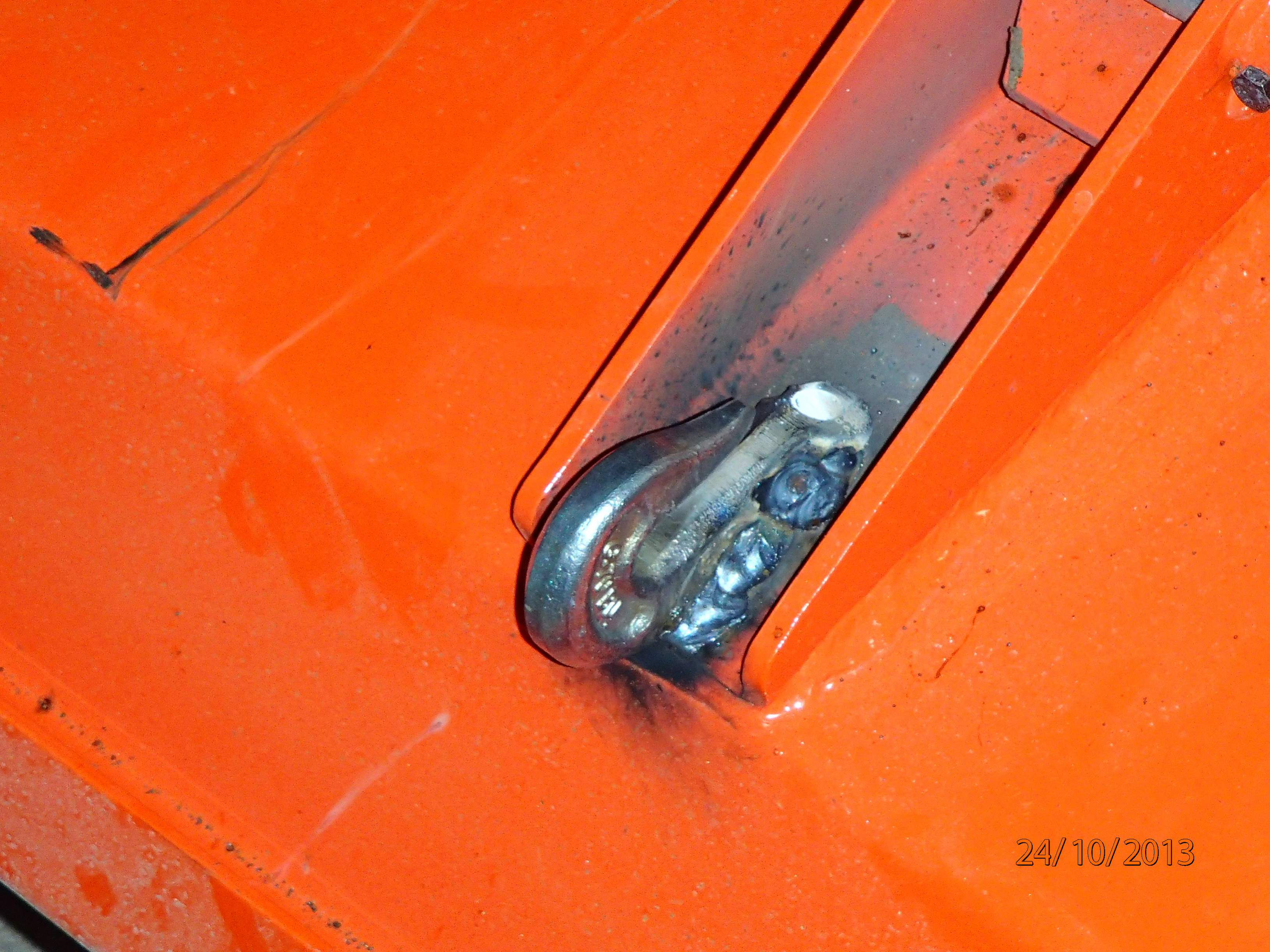

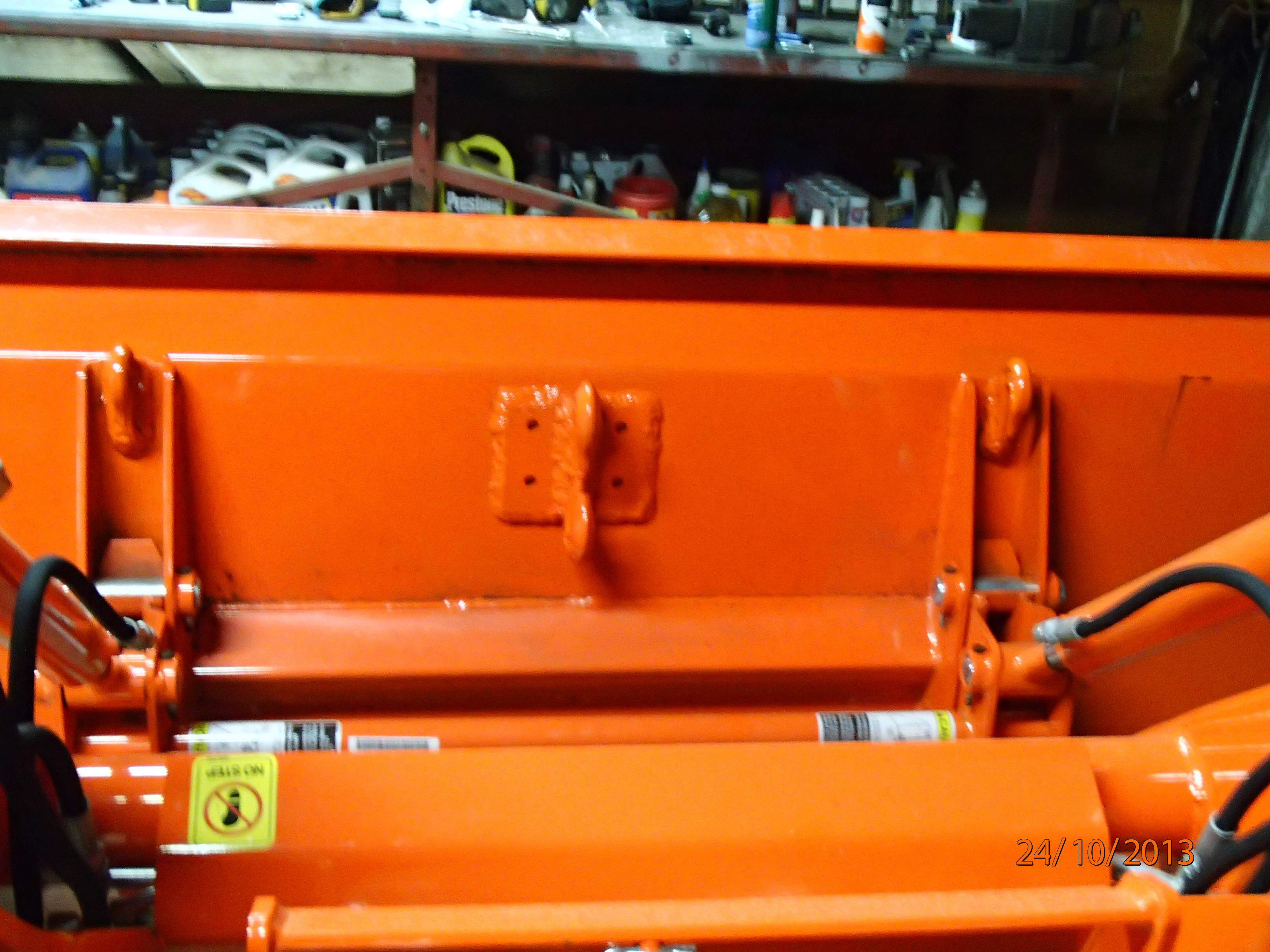

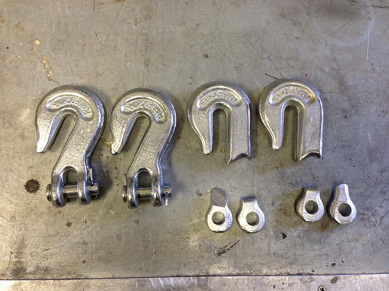

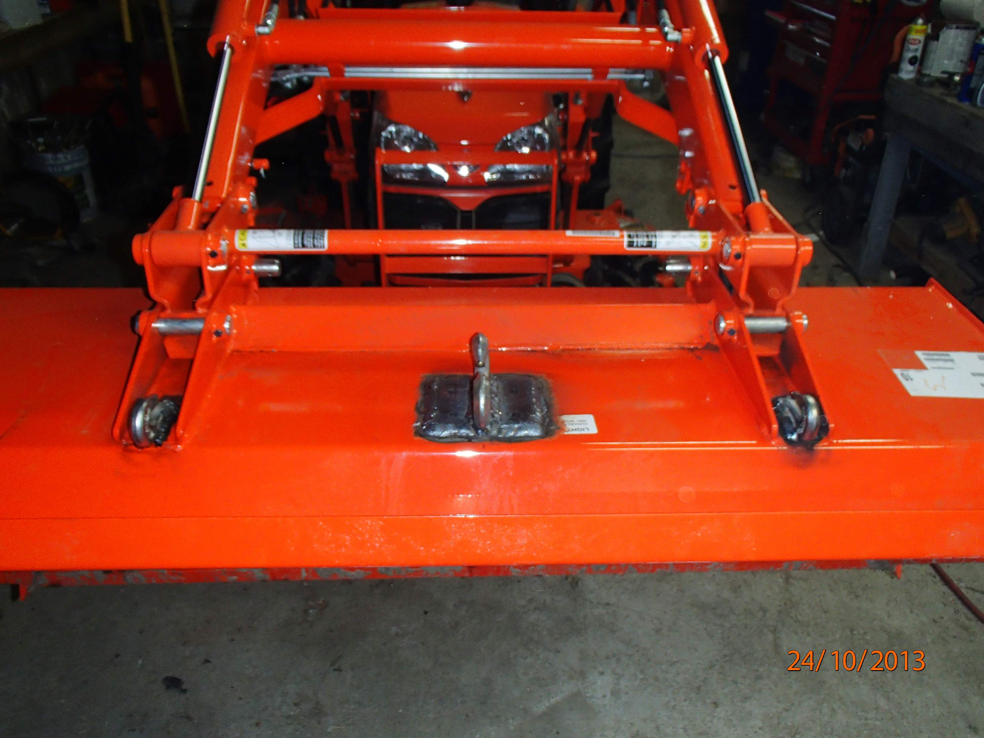

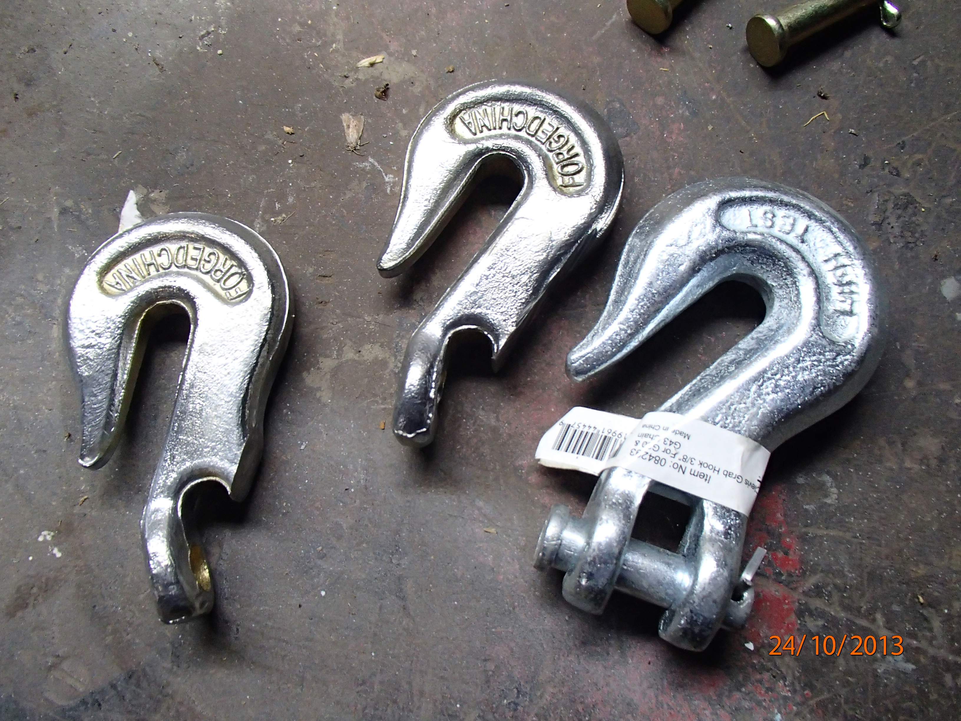

Here is my idea for how to install them!
But with the forks below i find i never use the hooks on the bucket! My first time with forks....best attachment I've ever purchased!
   / Where to weld bucket hooks? #95
Looks good. I put a slip hook in between the two grab hooks. I can then run the chain through the slip and over to a grab hook on one side or the other to take up the slack. The slip hook is nice when you need to hook to a rope or cable eye, strap, etc.
