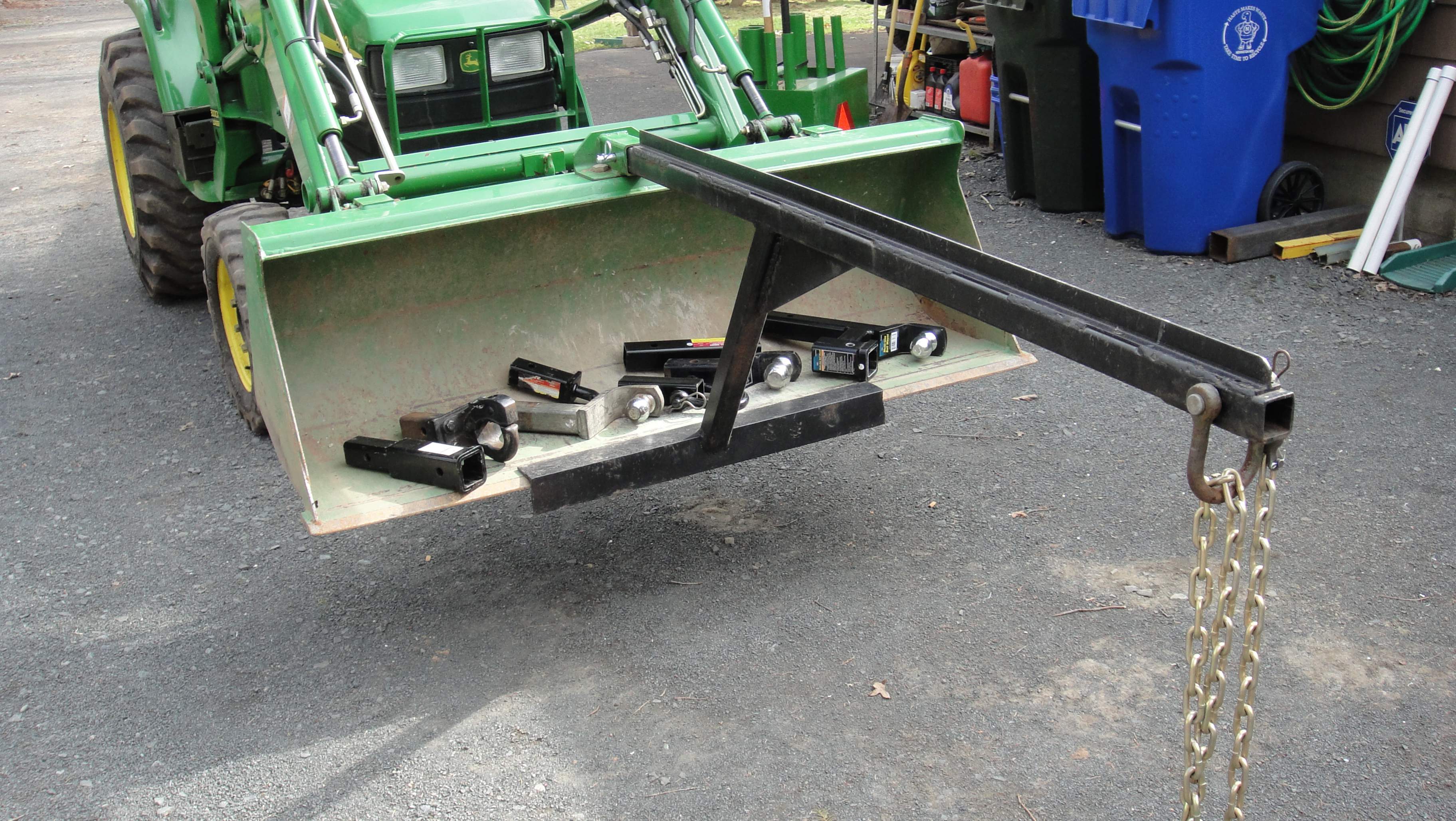

I know I lose alot of my loaders lift capacity with this setup, but definitely no need for a hood guard :D
Another use of receiver tube on top center of bucket, i have yet to need or want weld on hooks.
JB.

That looks like a great boom also not too tough to build. This will have to be on my to do list thanks for the pictures

Nice boonm pole. My only concern would be how easy it would be to overload the front tires. The further out the load is in front of the bucket, the more it loads the front tires.
This may not be an issue on your tractor. Oowever, on my tractor the front tires are a 6-12 size. The 4 ply tire rating is 600 lbs. Even 6 ply is only 780 lbs. & these are tough to find. With an empty bucket, there already is 500 lbs. on each tire. Hanging even 400 lbs. a couple of feet in front of the bucket would bring the rim down to the rubber!
   / Where to weld bucket hooks? #90
I never thought about the tires, but I think the loaders limit is the same.
My loader can lift aprx 1500 pounds, that's probably about in the middle of the bucket. with the boom pole the the capacity would go down drastically out at the end of the boom. But the loader still feels 1500 pounds.
I have worried a little about the front tires when I have capacity loads in the bucket, but these must be pretty good HD tires, cause they seem to handle it with out any noticeable problem. I've only checked the air pressure a couple times since I owned the tractor. Thanks for bringing this up, I should check them now.
