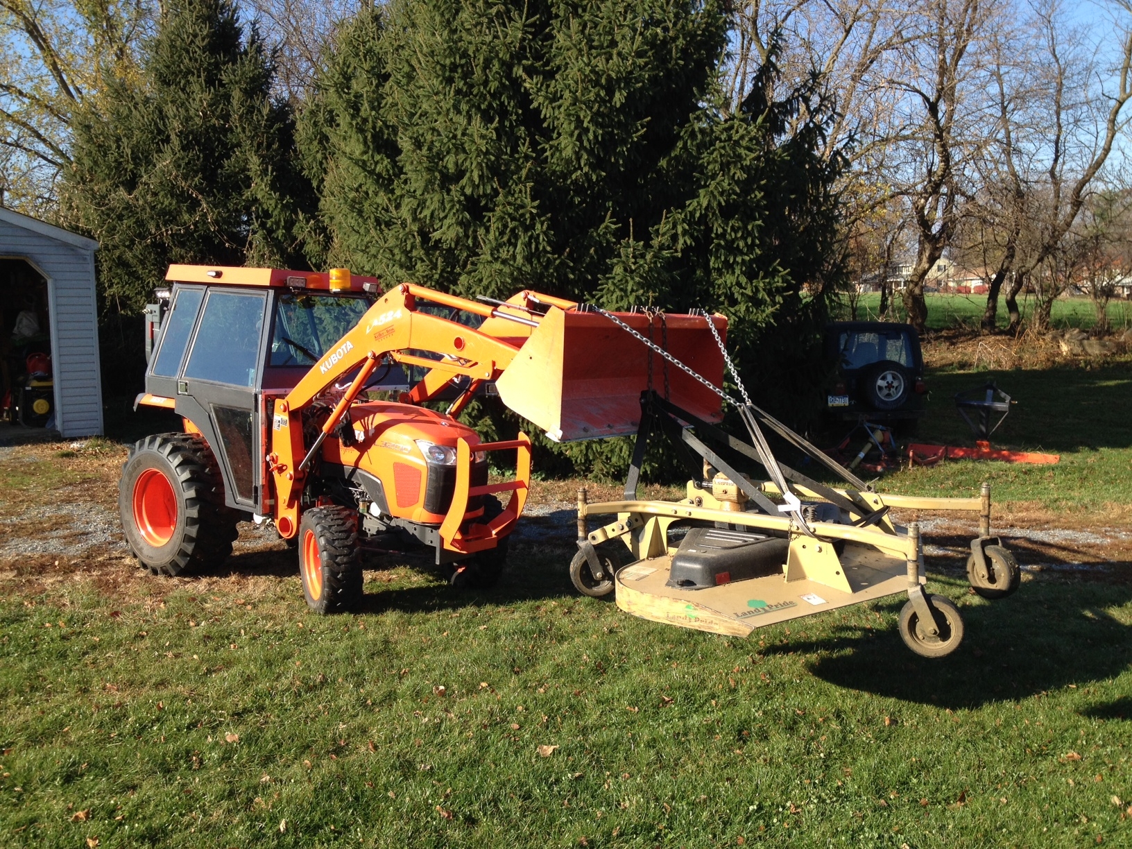

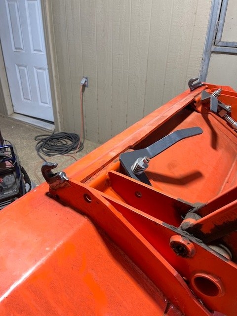

Got these online (Amazon). I painted them to match. They work great. I put 2 on my flail mower too so I can hang it in the air and sharpen the blades with crawling around on the ground.

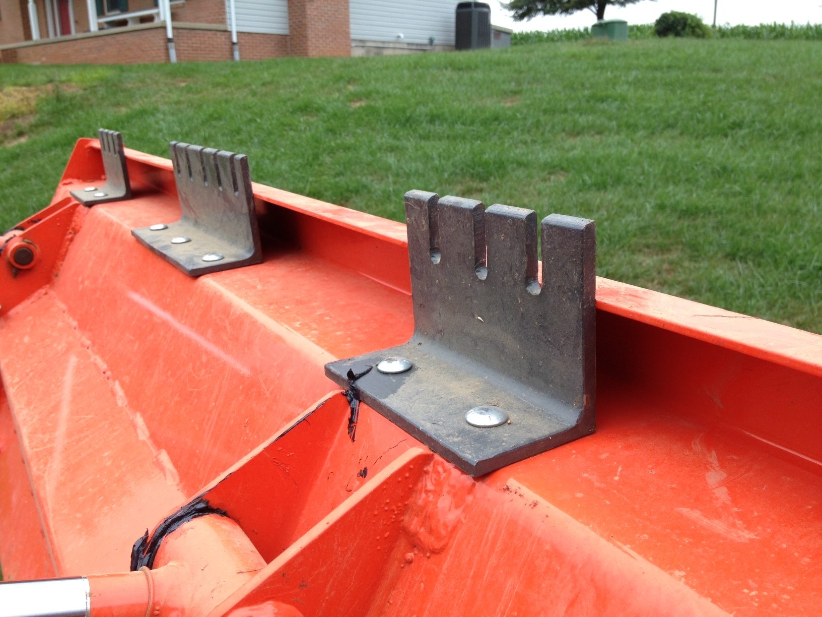

Made my own.... Out of 1/4x 2 inch angle iron... Placed them just above where hydraulics webs are on bucket as I perceived it was strongest point on bucket...
slots-3-jpg.577844

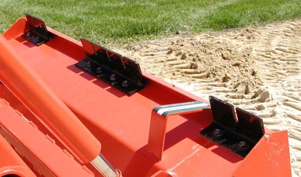

If you want simplicity and good results, use Ken's Bolt-on Hooks. My BIL has some and they're very nice.
If you want to DIY I'd suggest considering angle like I did. It's "bi-chainual". You can drop chains off the front or rear. Had this setup on the last 3 tractors and never a problem. Been using them since around 2002 when we got the B7500. One nice feature is being able to hang extra chain out of the way by dropping it into the extra slots. It's handy enough that it gets incorporated into other attachments like the forks.
The L3200 lifting the 6' LandPride RFM in that manner is probably about as severe as you can load the slotted angle. Another benefit is being able to pick up a load that needs moved, than set it down at the new location and dump the bucket far enough to slip the chains off.
