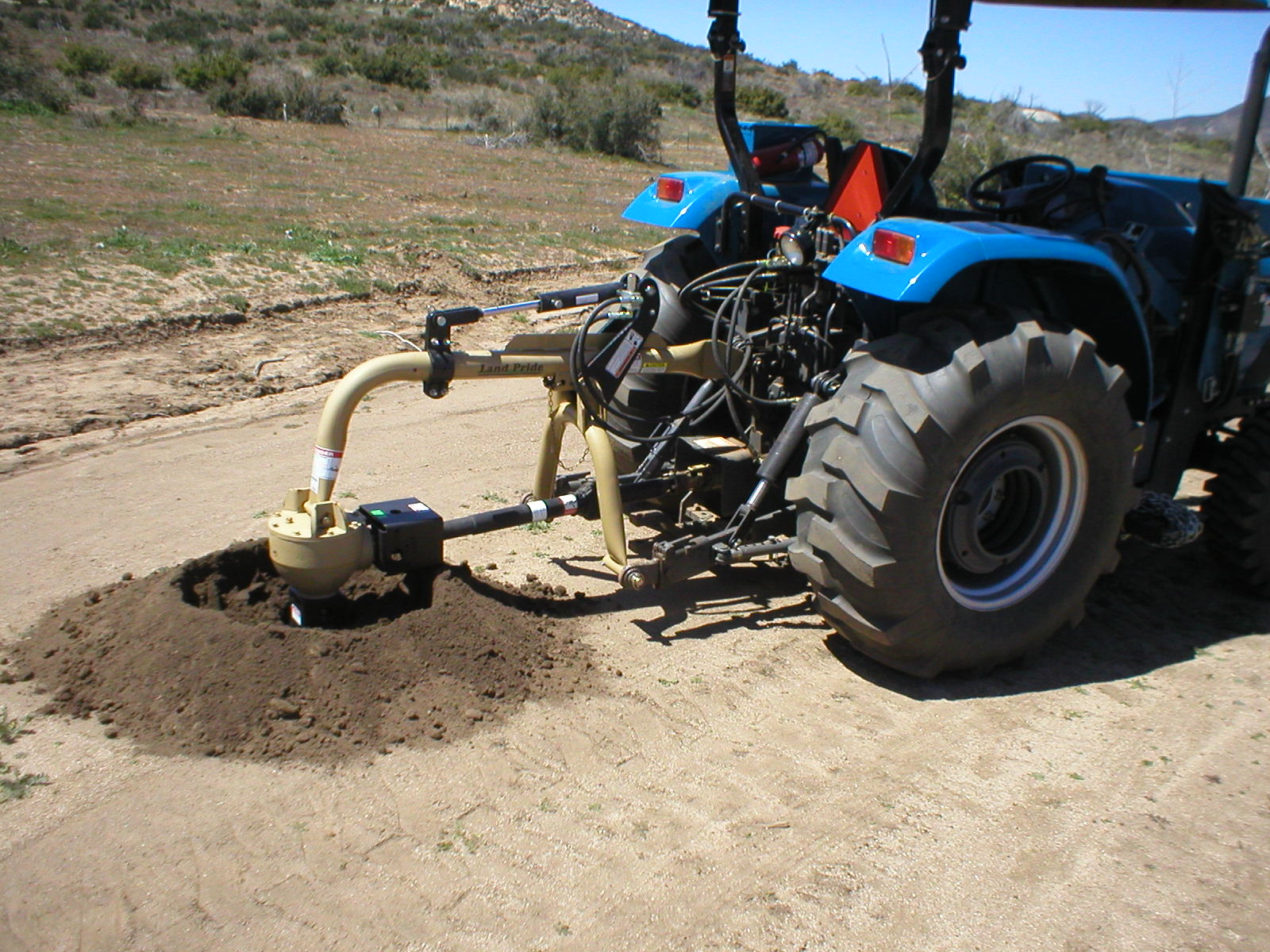

I've been looking at post hole diggers for my tractor. I'm specifically looking at a Cat 2 heavy duty auger. The choice is between the Land Pride PD35 and the Everything Attachments 7500HD. There's about a $500 difference in price favoring the EA brand. Also, what size bit should I consider for all things on the farm? Some say 9" and others say 12". I'll be installing fence 6" posts as well as possible some 6x6" posts.

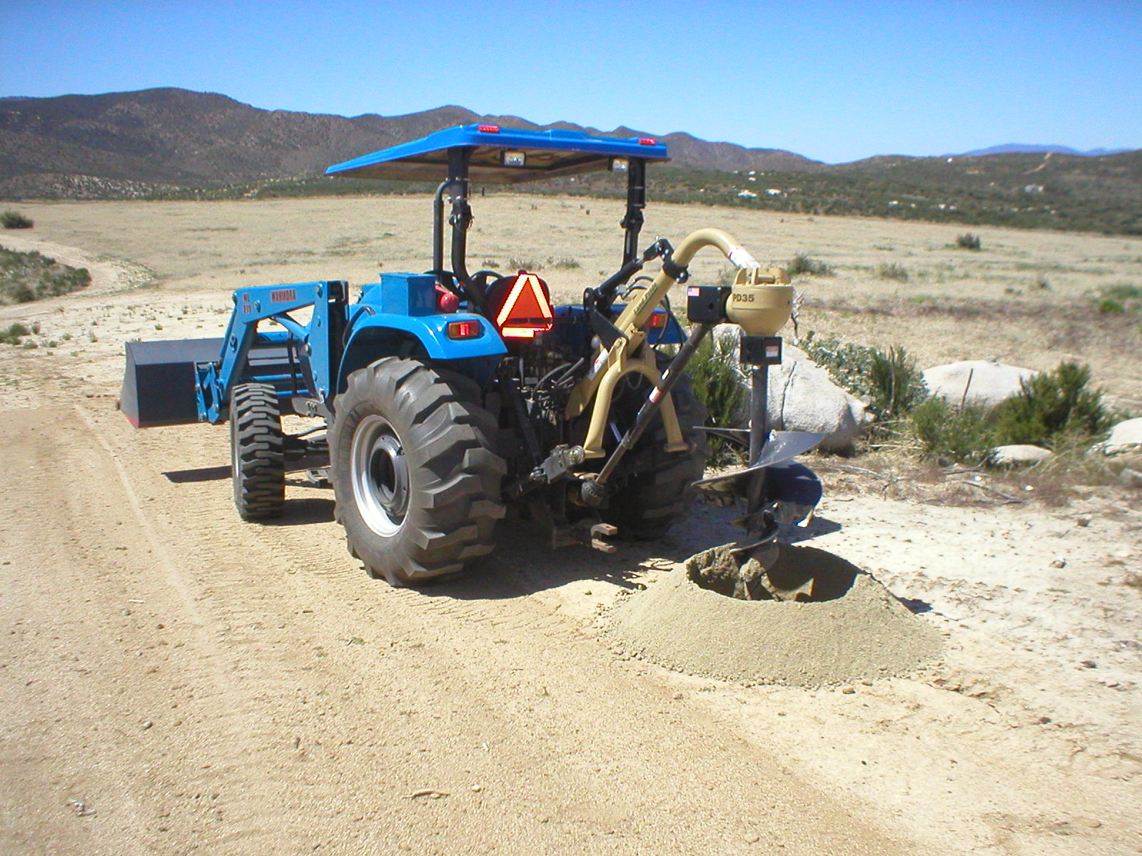

I have no idea how your ground is, but if it ever gets hard, be sure to get the down pressure kit for it PHD. I have the Land Pride PD35 with most of the different bit sizes, (6"-24") and this unit will drill through anything that we have here. A hole that use to take days for the water to soak in so that you could get to full depth now takes literally 2-3 minutes to drill full depth.
We don't really have rocks and roots to deal with, but decomposed granite (DG) and when it is hard, or not as decomposed as other areas you can get sparks off of it with a digging bar. The down pressure kit 100% eliminated any type of waiting for all of my drilling requirements. :thumbsup: :thumbsup:

I went with the Everything Attachments 7500HD auger. I haven't purchased the down pressure kit; However, that is some great info and pictures helped me a lot. Our soil has some limestone in it and no granite.
How do you get your auger up on the 4x4 stand? That's a pretty slick way of holding it.

The cross 4x4 beam just sits in the saddles. Raise the PHD all the way up, slide the 4x4 through, let the PHD down, disconnect the hitch, down force hydraulic hoses, drive away.
People complain about how difficult a PHD is to take off and on, it is actually very easy, takes just under 5 minutes on or off. My tractor is about the same size as your Kubota, so things should be similar.
Good luck with your new implement. ;)
