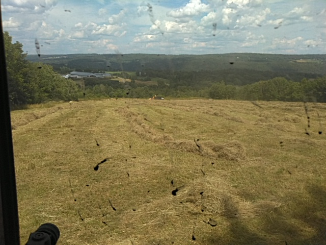

Took a while, but found the first hillside field to bale this year. Only sent one into the trees though.

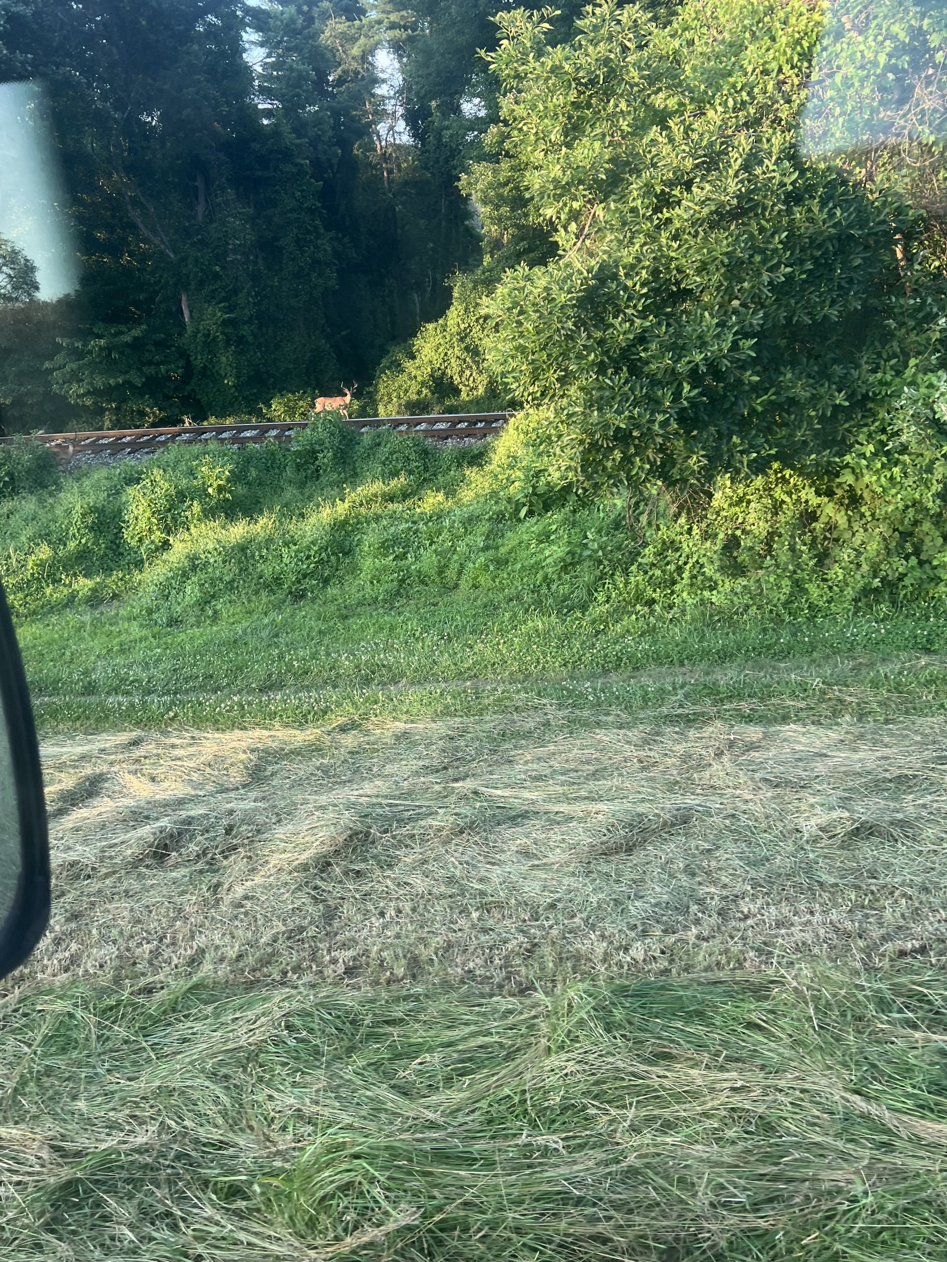

While haying I spotted this 10 pointer.
Might have to skewer him this fall.

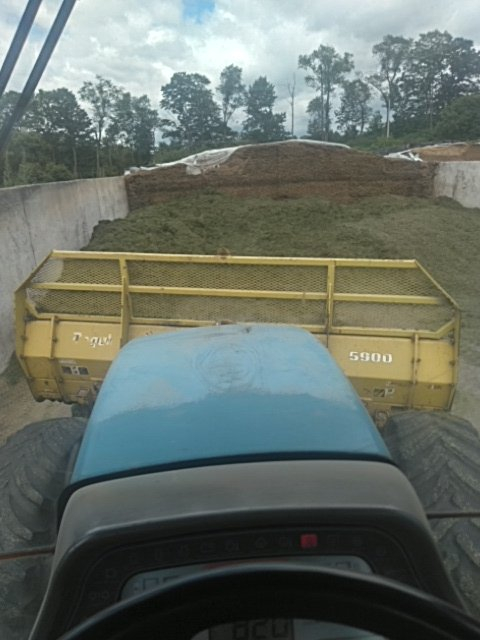

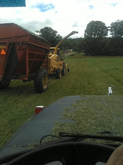

Chopping some third cut--it's hay adjacent anyway. Truck duty in the morning.
Pack tractor later on.
