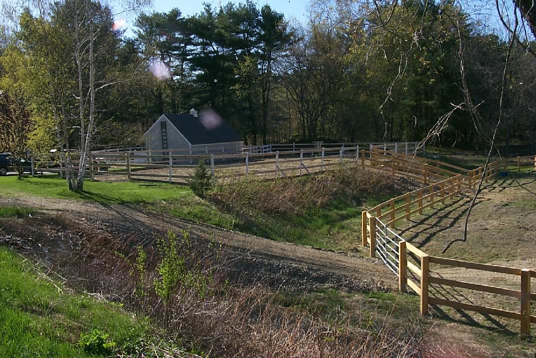

Anybody got any pics to share of a double gate they built? 6' or 8' each. Doesn't matter. Looking more for how attached to the split rail fence (if attached), supported, framed, etc...
Thanks!!
Thanks!!
Michael
Here's a pic of our double 8 footers (lower right center). They do not sag and need no support at the center. They are secured with 2 galvanized chain segments locked. The fence is 6x6x8 hemlock with 2x6x8 foot rough cut hemlock boards.
Unfortunately, I cannot obtain these boards in 16 foot lengths, which is totally superior to 8 foot runs for strength and durability.
Also, do NOT use pressure treated wood for animal containment if possible. The older PT contains arsenic and the new stuff is not adviseable, especially if your animals will crib the boards.
Lastly, use a half sack of quick crete on the gate posts. No need to add water, just back fill with the crete and some of the dug material. Anywhere you have some physical stresses on the fence, use some crete on the post holes.
