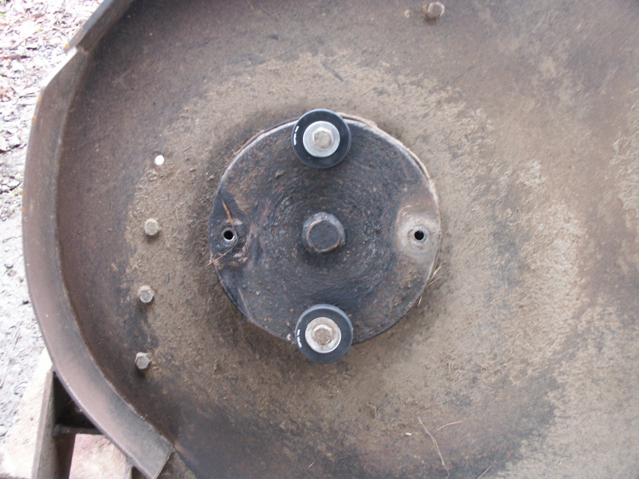

So on the PT mower spindle, there are those spare holes. Would it make any sort of sense to add blades to those holes? (make each rotor a 4 blade instead of a 2 blade)

Carl,
Show us a picture if your spindles. I think the answer is that more blades on there would just collide with other blades.
You ever pedal an air fan exercise bike? The faster you pedal the harder it gets. If you add another blade to your mower, it will make the machine work twice as hard to spin it just through the air, let alone the grass.

I never thought of aerodynamic drag. Or actually getting that sort of mass rotating.
I upgraded my PT blades from soft 3/8" to hardened 1/2" blades custom made, and it does take the PT more time to wind up that big mower... Also Vibrations are more prevelant...
JJ, Here is a couple of pix of the belly of the beast.
Carl, Thanks.
My new observation on the four holes verses 2. If you wear or strip out the current hole the blades are mounted in, just switch the blades to the other set of holes.

As far as the number of blades, you could have from one blade to 20 blades on a mower set up as long as they are balanced, especially the one bladed cutter. The speed of the unit is dictated by the available HP, and motor limitations, and being down right dangerous at extraordinary speeds. One has to keep in mind, the weight of the object being thrown around by centrifugal force. There would be no difference in applied HP or speed, if the weight of the 4 blades equal the two blades, and so forth, with any number of blades.
