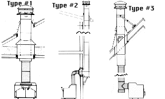

Kenny, what type of chimney do you have ? Type 1, 2 or 3 ? A type 2 chimney will never gain as much draft in cold conditions as a type 1. A type 3 will have less draft than a type 1 due to the extra bends in the system.
I have a damper about 18" above the stove in a type 1 flue and other than lighting the fire, it is otherwise fully closed all the time and I seldom have the air intake of the stove open more than 20% during an extended burn.
Egon, have you looked at the size of the intake air opening on an EPA stove when the control is fully closed ? Do you know that the intake for the secondary air system is a fixed orifice that is larger than a 5c piece ? Do you know that the fixed air intake for the air wash for the glass in the door is about 1/2" in diameter? Basically, if you add it up, if you have the air intake fully closed there is still an opening feeding the stove than is more than 3/4" in diameter which one has no control over at all.

The link is an interesting read but it just doesn't match up to what I have experienced. In my house I have a clay lined masonry chimney. I have about 5 feet of sloped single wall pipe above the stove that goes into the masonry wall. It goes 2 or 3 feet horizontal and then turns vertical and goes up about 30 feet to clear the peak of a steep roofed 2 story house. I guess that would be the "Type 2". If I leave the combustion air wide open my Osburne will exceed the recommended operating temperature but won't get frighteningly hot.
In the pole barn I have about 9 or 10 feet of single wall pipe that then transitions to 9 feet of Class A double wall pipe through the attic space and above the roof. I suppose that would be a Type 1. It's a US Stove and it will run hotter than the Osburn if left wide open but it's easily controllable to stay in normal operating range.
Apparently some people have problems like this but I know a lot of people with wood stoves and I have never heard of the issue before. I have only had these two "airtight" stoves, one rather expensive and one about the cheapest one available and they both work perfectly for me with no control other than the stove control.
