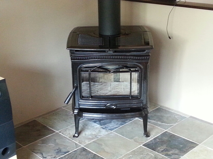

Friday was install day, the Wife and I couldn't be happier with our choice, the living room finally looks complete. Thanks to everyone who participated in this thread.

Thanks Egon, I think it was worth the wait. Really looking forward to cutting a chunk off the electric bill.

I lit that puppy up, third time actually, cause it needs a few season burns to get the stank out obviously. She got the house nice and toasty. Only downside to the stove is that I have to make sure I shut off the HRV, otherwise I get some major negative air pressure which in turn causes backpuffing into the house. I have someone coming next week to see if we can don anything about that.

Back puffing is poor draft or marginal draft with cross winds pushing air down the flue from above. Add a stick(24, 36, 0r 48") of flue pipe above the roof. This will increase your draft and is a cheap easy fix. Post up some photo's of your flue set up on the roof and how far away it is from the peak or any other obstruction. What is your total flue length from stove to cap right now?

It was definitely from the HRV. I turned it off, had all the windows and doors closed, no back puffing. I don't remember off the top of my head what the length is, guessing I'd say 15 ft total top to bottom.
