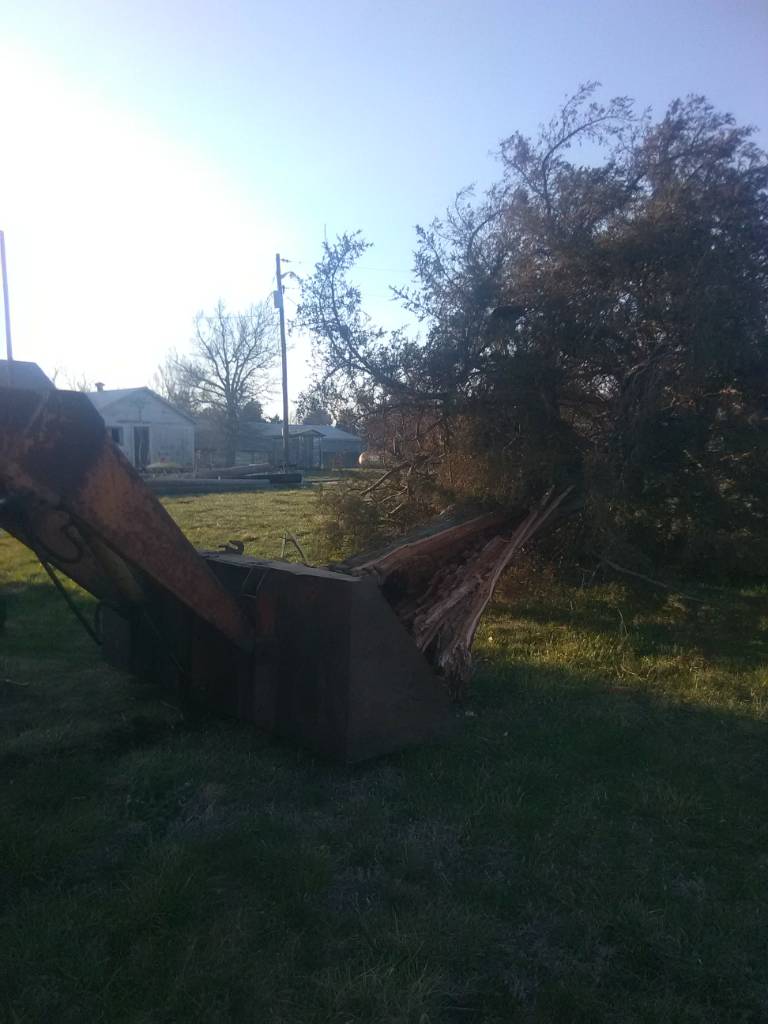

Had a tree i was tired of and decided to push it with the tractor thinking it would up root and i would not have a stump to mow around. Well, as you can see in the photo IMG_20180405_183444.jpgIMG_20180405_183622.jpgIMG_20180405_183709.jpg it broke about even with the ground. I just told a guy on here that one of these little tractors would dig out a stump. I was totally off base with that idea. I jumped on mf because of ease and operational convenience. The little massey didn't do to good. Not enough hp, push power, hydraulics, and weight. It is not just my little massey, i think any of these little tractors would have trouble. Little tractors are not the right tool for stump removal.

Tractor FELs against 14" stumps are a joke. Tractor backhoes aren't much better. A real backhoe and preferably an excavator is leaps and bounds better.

They’re made for LOADING not digging stumps. But if I had to push stumps out I think a 988 cat would be better than a compact tractor.

Pulling stumps is not what a lot of people think. They think that it is like a tooth where the tap root goes deep. On some types of trees that is true; Ash and White Pine being some of the toughest stumps to pull, but mostly it is like glass over a puddle of water on a hard surface. It is not the tap root holding it to the soil, but rather the "suction". You got to break that suction, and that means getting under the stump. A bulldozer works well, an excavator better, but both take a lot of weight to hold the machine to the earth while it does it.
Even with the Allis you are going to struggle. Wrong geometry with no where near the breakout forces needed.
I had a stump many years ago; small and rotted for a few years. I dug at it for quite awhile with my front end loader and was not making much headway. Finally I turned around, put a chain around it, and hooked it to my drawbar. Pulling it, it drug it right out of the ground without even spinning a tire.

I've had better results pulling with the drawbar than pushing with anything except a dozer.

The pictures make it look like that tree had a lot of dead wood in the center. If that's correct, it was likely to break like that no matter what you were pushing with. Also pretty dangerous because a weakened tree will be unpredictable in which way it will fall. If it had been a solid, healthy tree, your tractor probably would not have been big enough to pop the roots out so the tree could fall. You need big iron to shove over anything larger than maybe an 8" or 10" tree. But I got rid of many,many trees by dropping them with the chainsaw and digging out the stump with the backhoe. As a senior citizen, I can say from experience that this is young man's work!

I would have used a subsoiler as close to the tree as possible and ripped the roots on all four sides prior to pushing it. Getting all the feeder roots cut reduces the root ball and makes it easy to push over trees without a long taproot.

Ripper tooth on a tractor frame mounted hoe levels all comers. It's necessary to break or dislodge roots all the way around most stumps before they are able to be pushed over by the FEL.
FEL's by themselves are not designed to do digging- loading and some pushing straight on to center of loader, NOT corners.
Drawbar is only place to pull from, again NOT the FEL. Otherwise one can flip a tractor in short order.
