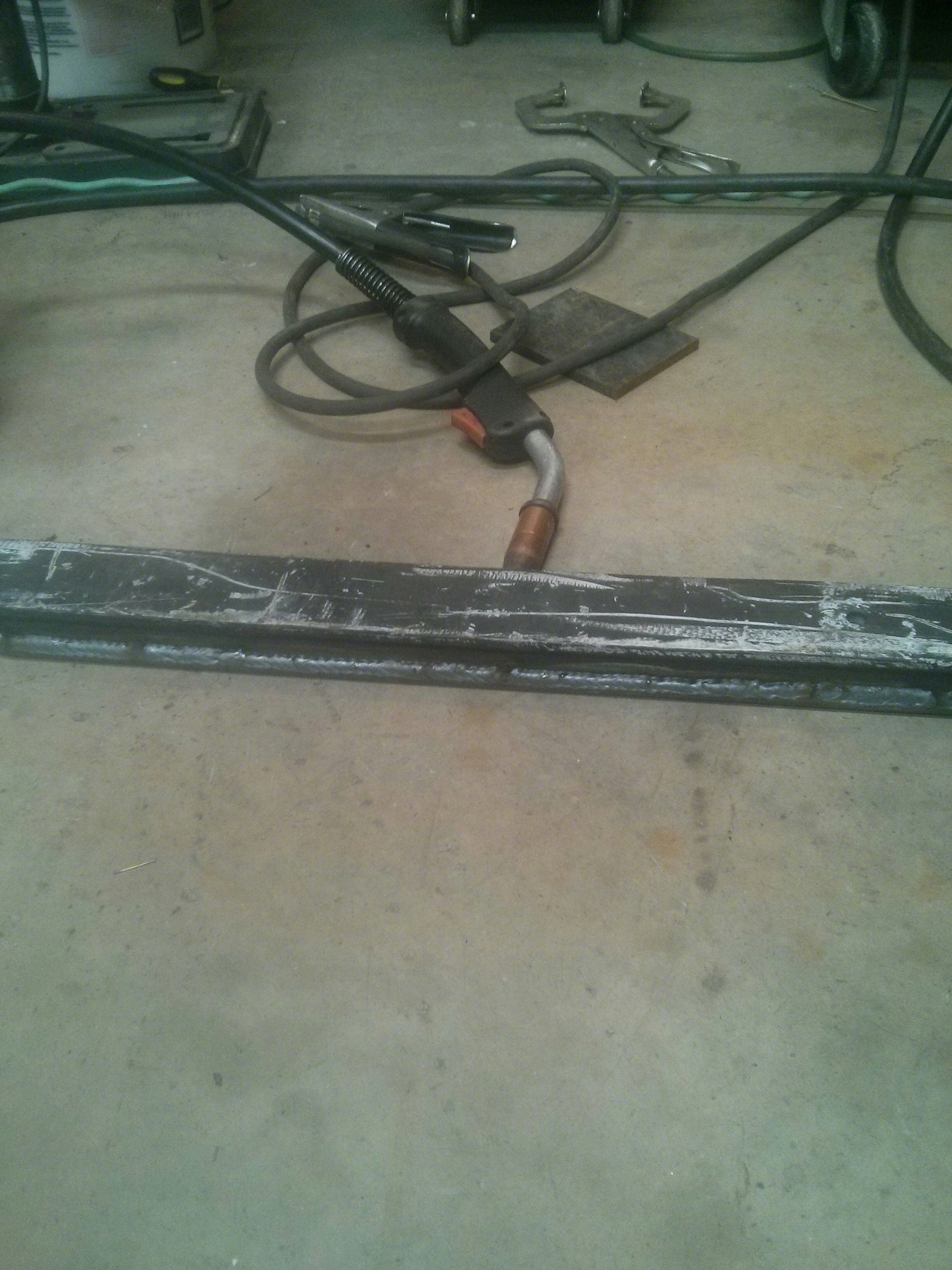

Worked on the pallet forks again last week for a bit...
Added 8lbs more steel to each of the forks. basically created a double I-beam or box beam
rust protection via the rustoleum safety blue and some D rings for picking up stuff.

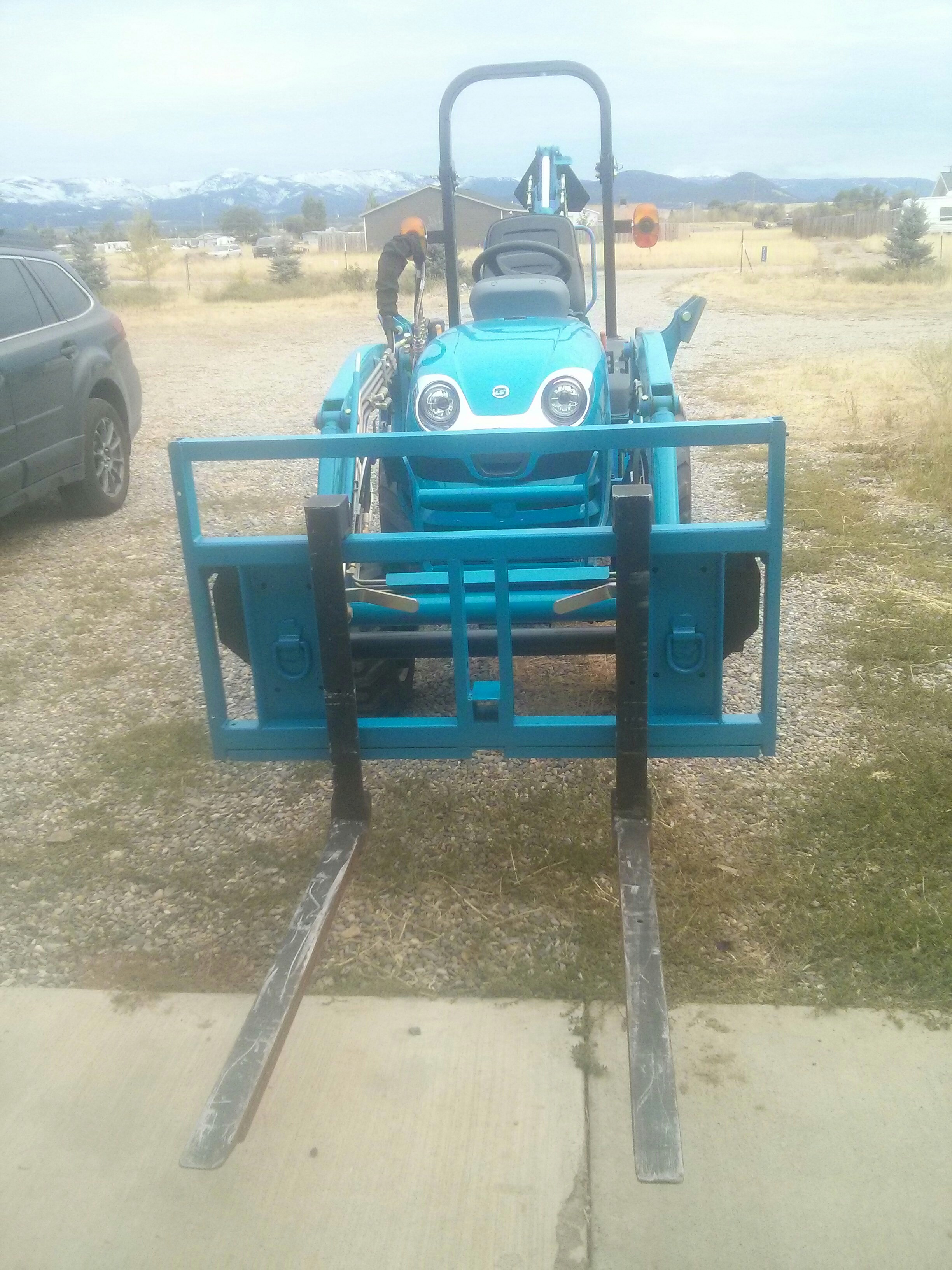

I still need to figure out what it can lift. I stacked another pallet 40"wide by 48" long by 36 tall with a bunch of lumber scraps from my brothers construction company, picked it up just fine and it was heavy because square wood stacks tighter than round/split wood. I noticed the hydro-static steering would not move at a dead stop like others have mentioned on the bigger tractors. I then decided to go try and lift the 48" pallet of split wood and I could lift it 3-4 feet off the ground where as last week i couldn't lift it at all.

I did cheat a bit... When I first got the tractor, I was unhappy with the FEL/loading the bucket to full performance, so I adjusted the relief valve half a turn. Made it much more capable at FEL work and so far been very happy with what I've able to pick up with the pallet forks.
   / xj2025h lifting stuff with home built SSQA pallet forks #18
Where are the relief valves located?
   / xj2025h lifting stuff with home built SSQA pallet forks #19
The valve that you adjust is located on the RH of the transaxle near the top, viewed from the rear. You'll see a block with allen headed screw with a lock nut on it.
