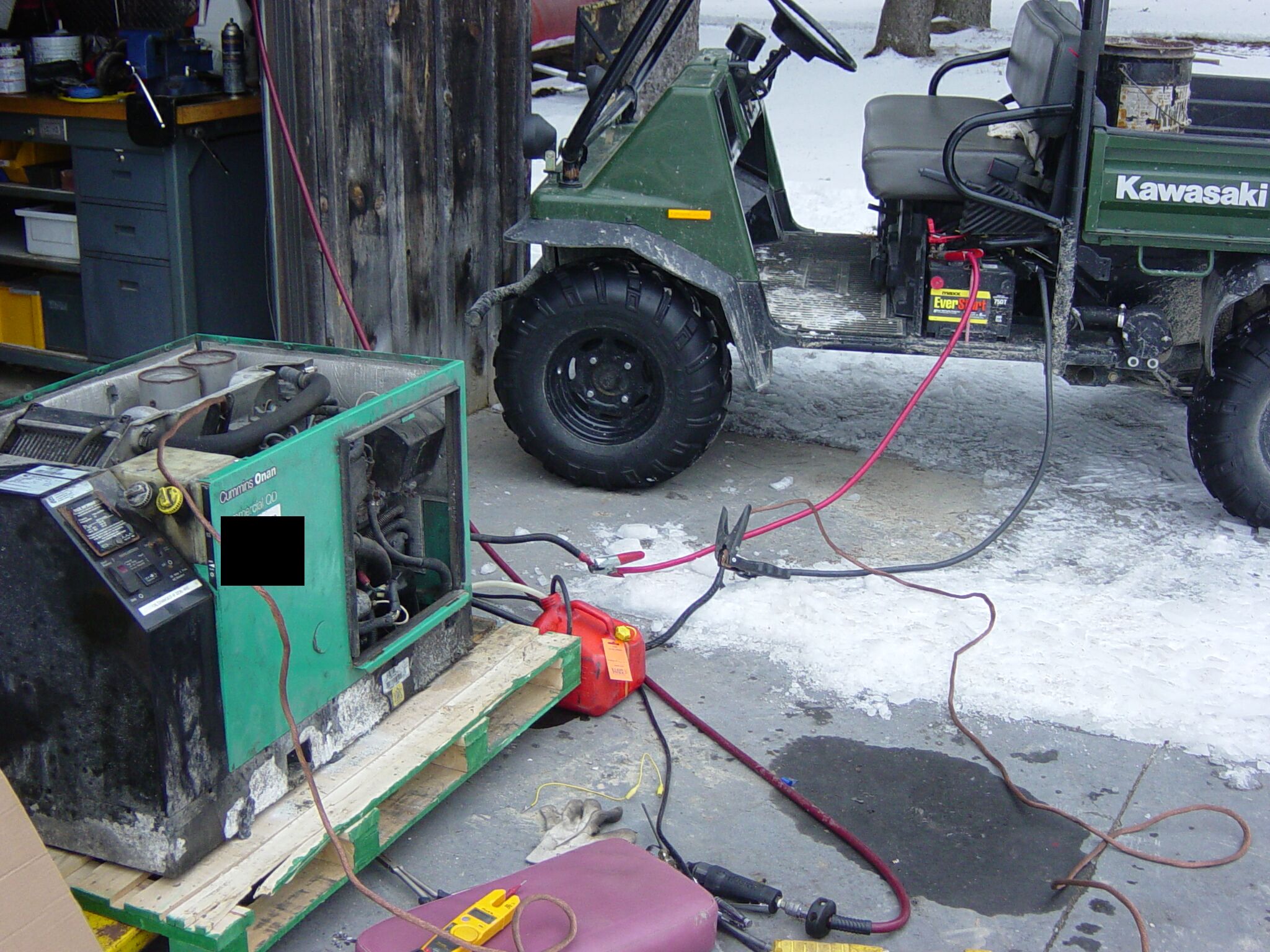

Working on my latest generator yesterday. Base for my Cummins/Onan Quiet Diesel. DSC00008.JPG
I have a 200 amp asco switch but want control, so a contactor (with adjustable) overload is being installed and will be controlled with what turned out to be a very high performance VISONIC wireless four channel control. Two for Stop/Start and Two for Contactor On/Off. Alows me to start the generator remotely and decide how much time before putting under load. Plus, if the power comes back on, a transmitter in the ASCO switch will shut down the generator as well. It will be SLICK!

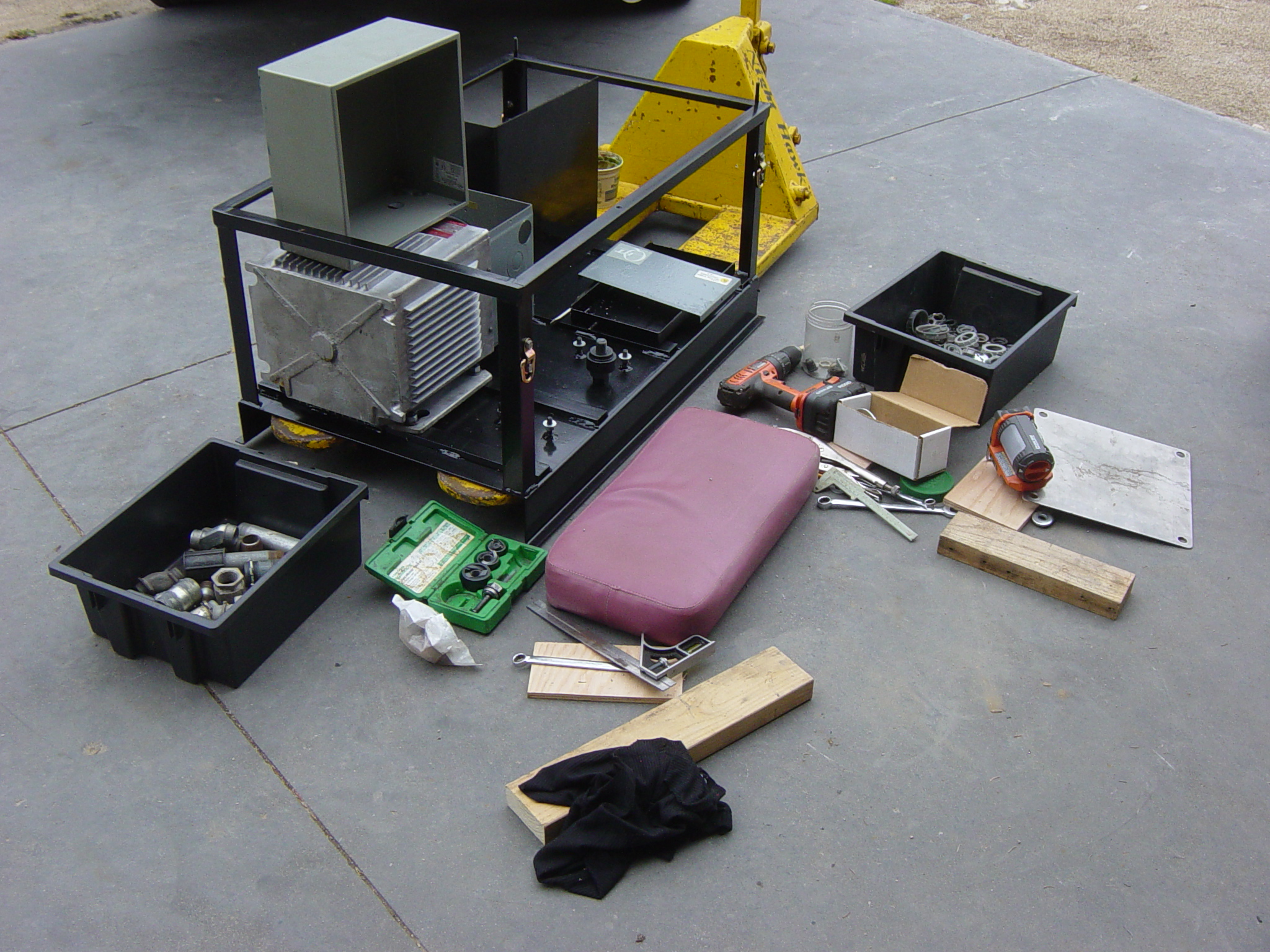

DSC04795b.jpg Generator that will sit atop the frame. Supposed to just be a silly little project that I could slip in between others.
FUEL tank is another story altogether.

Another one of those projects that if I knew what was involved, I would have passed. Park the thing in the corner and if I need it, take the hour to get it going, would have been easier. Plus, the thing is not worth a dollar more than the basic generator unit.
I think the ASCO does have a cool down timer. It has a bunch of timers but I have never used it in an automatic, engine start mode. I don't need or want the thing running in my absense. This newest set is supposed to be my night time or low (summer) load system, and it will be nice if the ASCO shuts it down on Utility restoral if I am sleeping.
