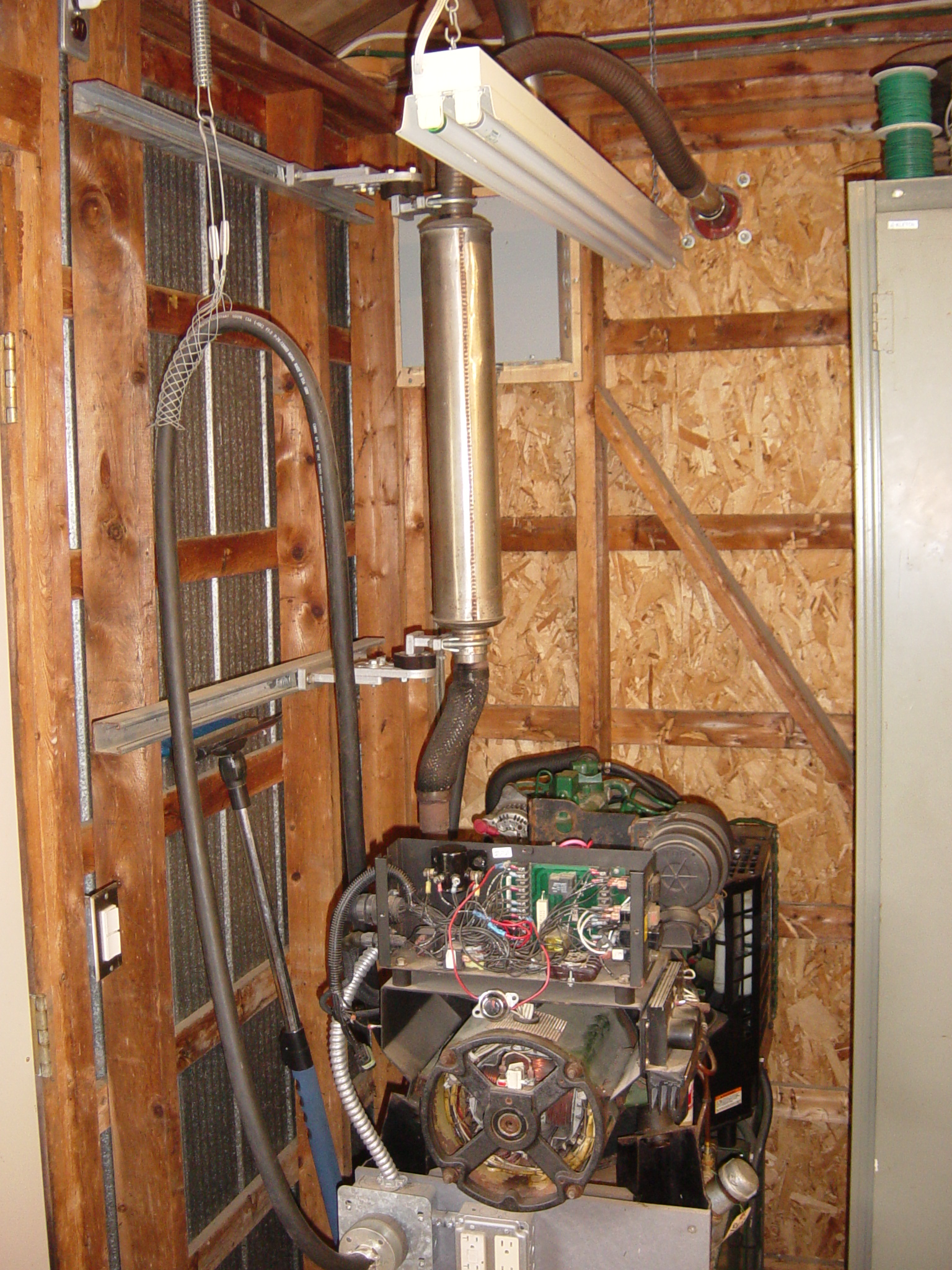

   / Your last generator Maintenance Run #5,373
Going into my 2nd winter with my set up that includes it's own building is working out perfectly.
I've finally landed on my "perfect" backup power solution after several prior projects that basically led me to this.
I occasionally have to shovel the entry door on the back, but long overhangs have done the trick. As you can see the big overhead door is directly on the driveway.
   / Your last generator Maintenance Run #5,374
Did you pipe your exhaust to the outside? Nice setup.
and yes, shovel the intake areas especially on generators, even the rear alternator intake, and keep the vent on propane regulator clear. I have had to replace engines on generators that run while covered in snow. The exhaust side tend to melt off.

Going into my 2nd winter with my set up that includes it's own building is working out perfectly. View attachment 728087
If we ever did a Generator wall-calendar, that pic would be a top contender for January (y)
Unless one lives in AZ, deep overhangs are pretty useful, but sometimes not done $-wise..... even @ pre-Covid pricing....
Rgds, D.

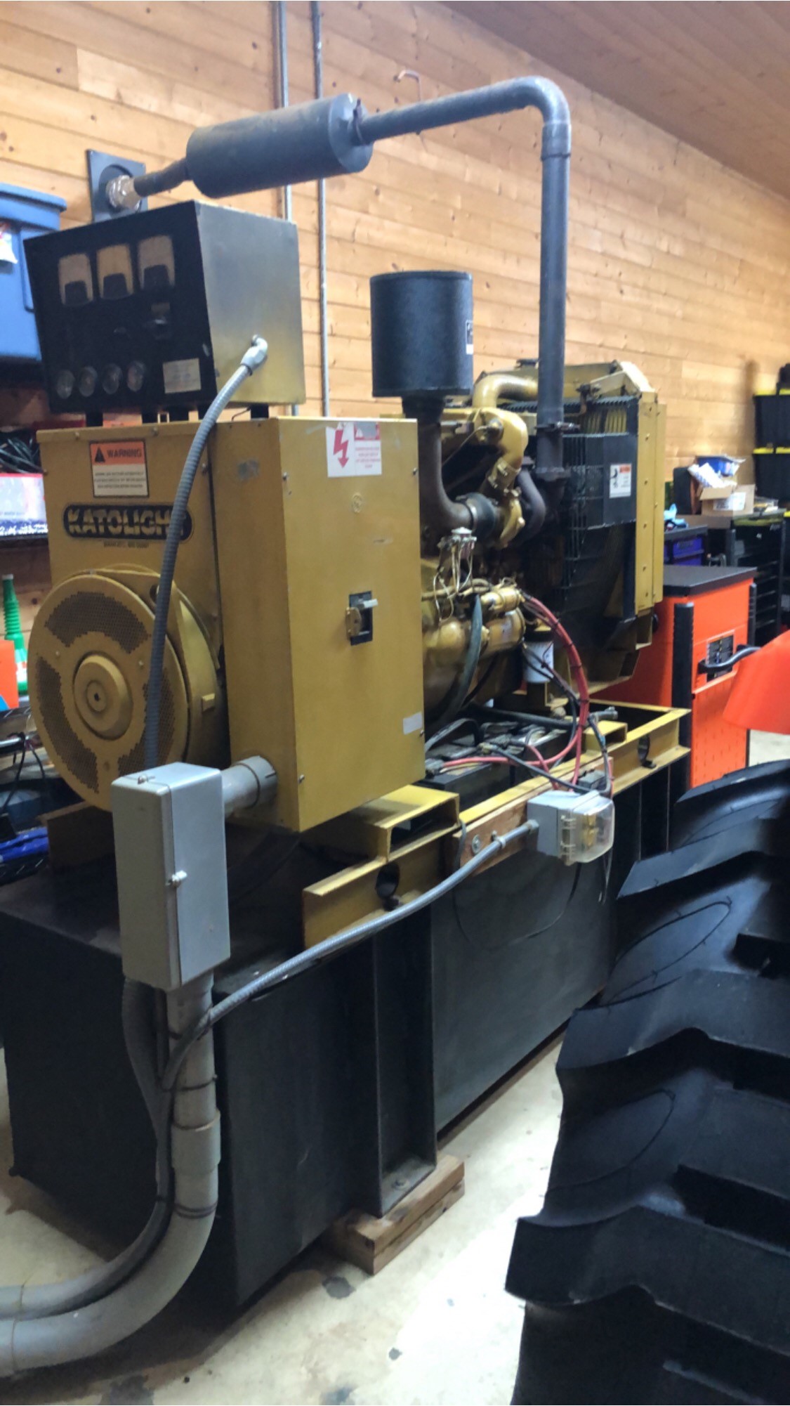

   / Your last generator Maintenance Run #5,378
how many hours on it? exhaust looks a bit rough for how nice the machine itself is
   / Your last generator Maintenance Run #5,380
it's a thing of beauty
probably already incorporated but I'd put a screen or baffle in that exhaust to keep critters from crawling in.
Mud wasps seem to love generators.
