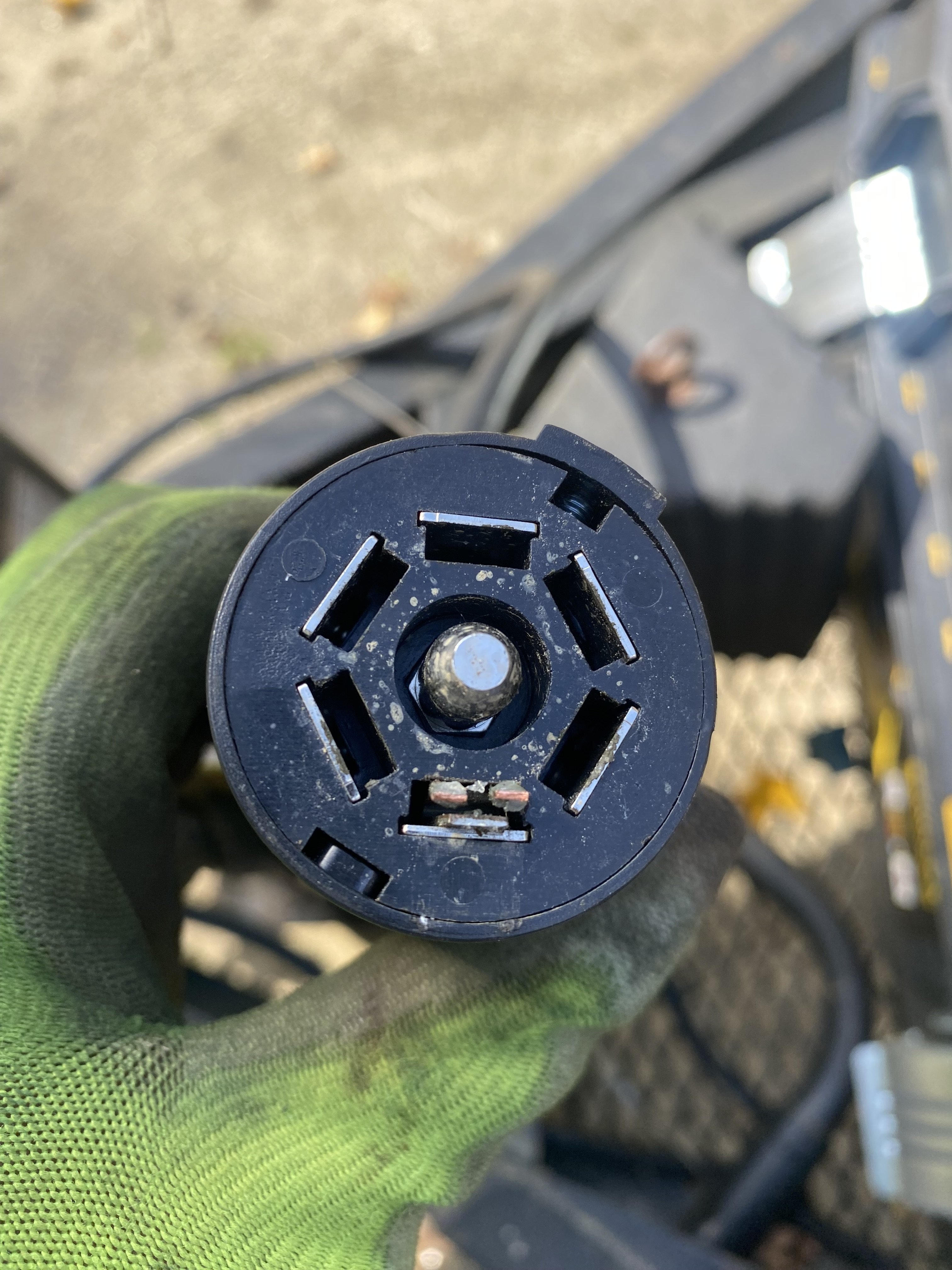

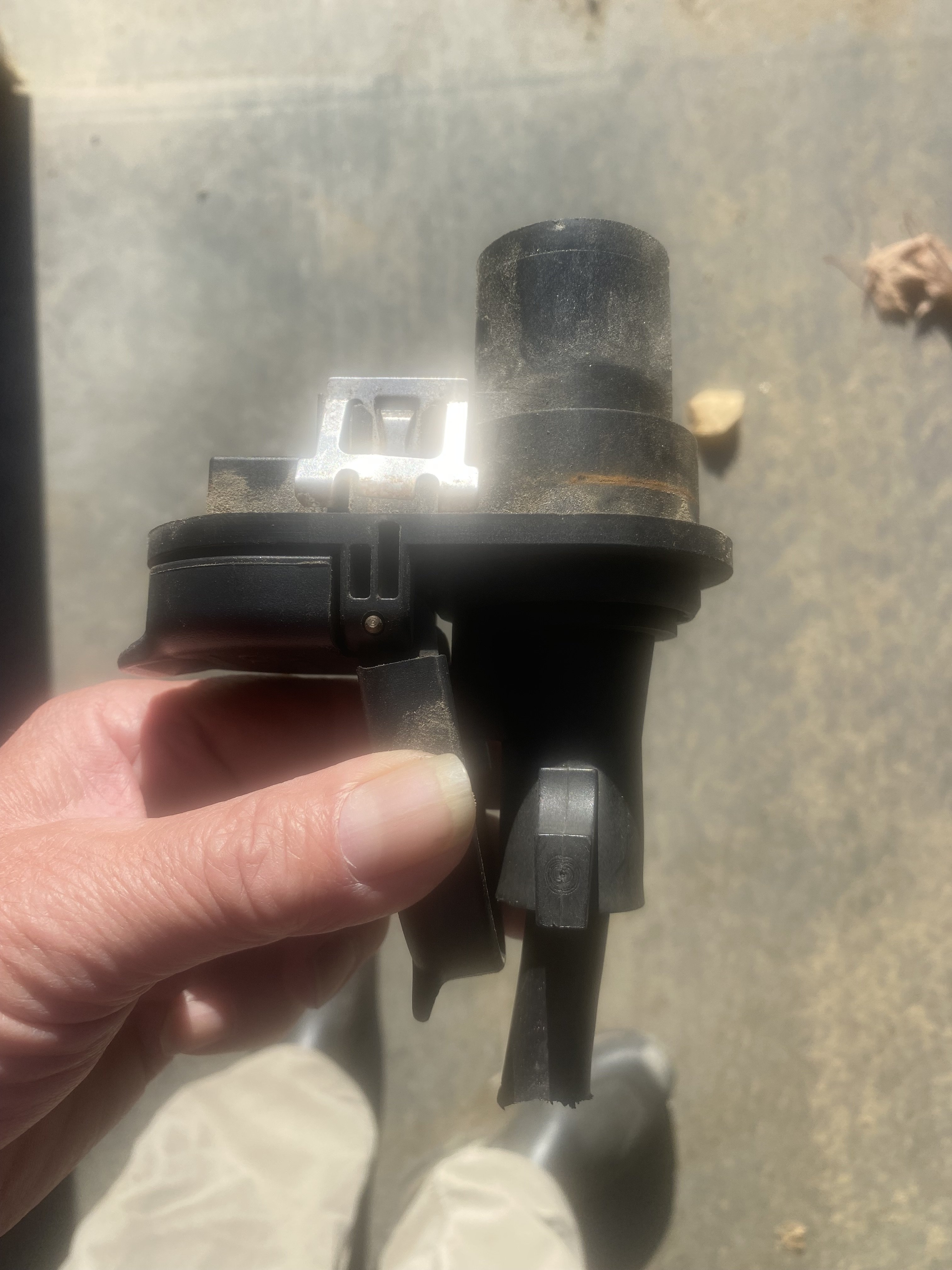

Fixed the ongoing trailer plug issue.
Trailer plug on one of my trailers had a terminal that was pinched shut and would fold over terminal on the truck. I would straighten it out with the Leatherman but knew the day would come... that day was yesterday! Found the truck terminal in one of my trailer plugs
Replaced offending plug and socket on truck.

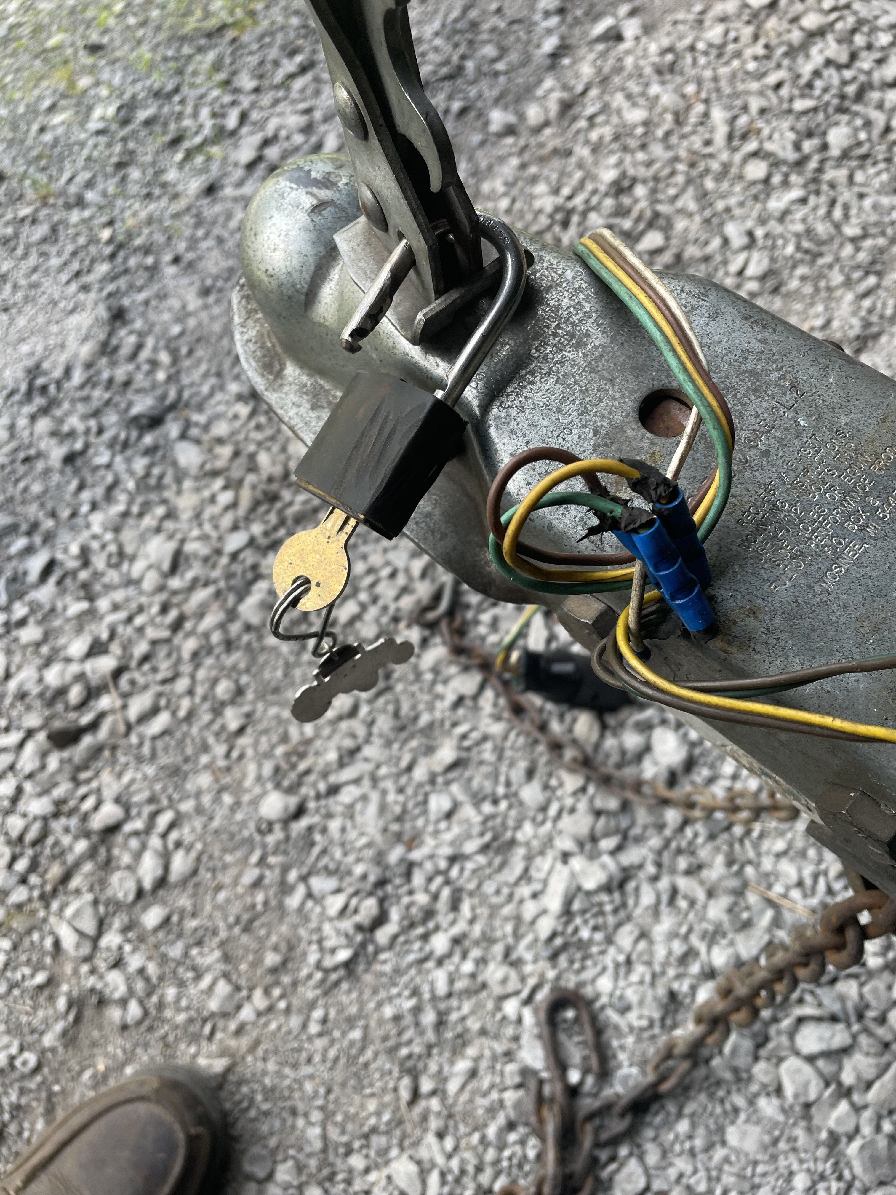

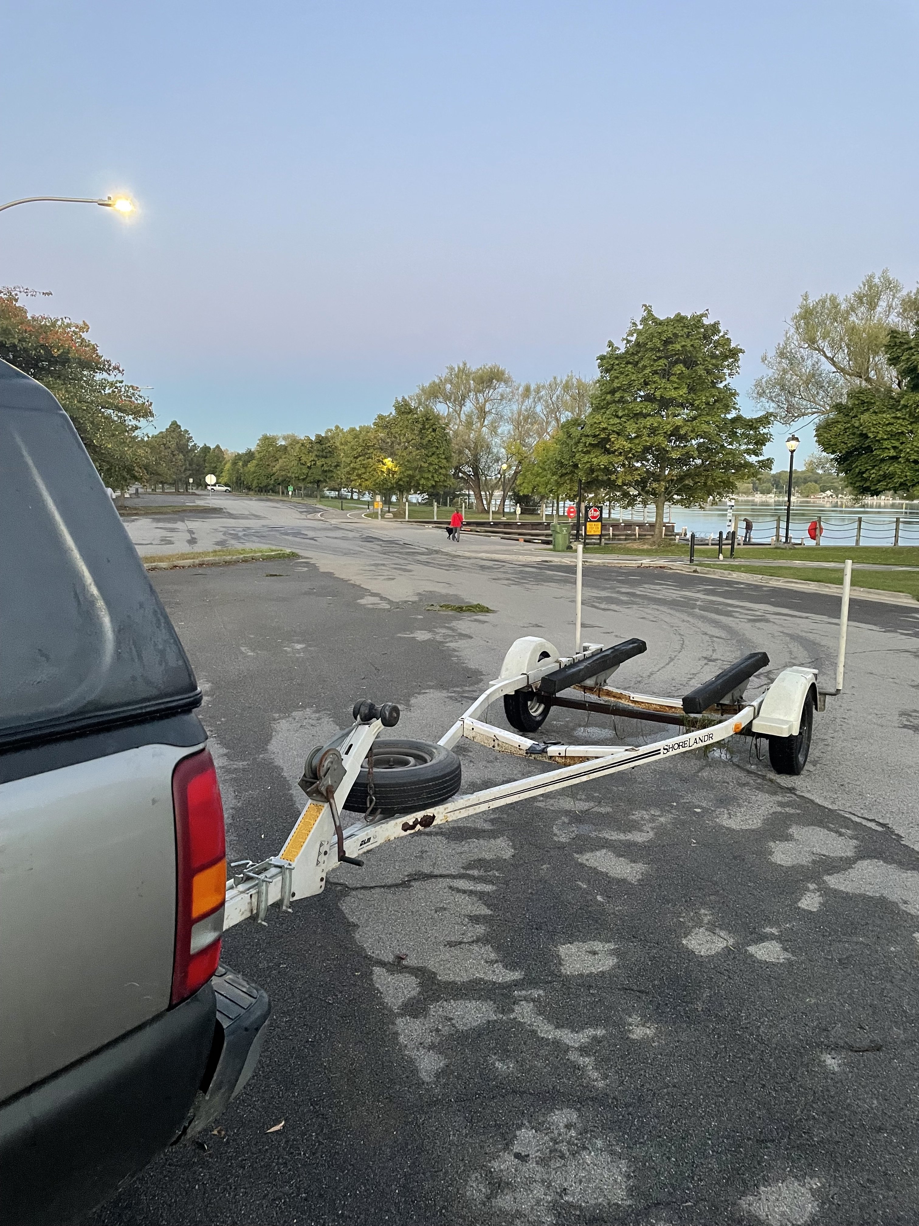

I bought a few padlocks from nearby garage sale a few years ago that were pretty cheap (maybe 50 cents each or so). I liked this brass one for locking my boat trailer onto the ball hitch on my pickup, and also for locking up the cap when I had valuables in it.
A few weeks ago, I got back from a fishing trip and I couldn’t locate the key. I used an angle grinder and cutoff wheel to remove the lock when I got home that day.
A day or two later, I found the key. The cut off lock was still in my shop garbage can. I fished it out and removed the cut-off part. It wasn’t real easy to clamp and it took a few tries to get it straight, but I managed to weld it back together with less than one stick of 6013 1/16” rod.
I ground it flush, reworked the notch a bit with a file, gave it a shot of WD-40, and now it works as well as it ever did. Took me about 1/2 hour for the repair, but it was a fun job. It’s nice to have a good lock again. I was worried the whole time I was out fishing yesterday morning, someone was going to run off with my trailer and leave me stranded out on the river.

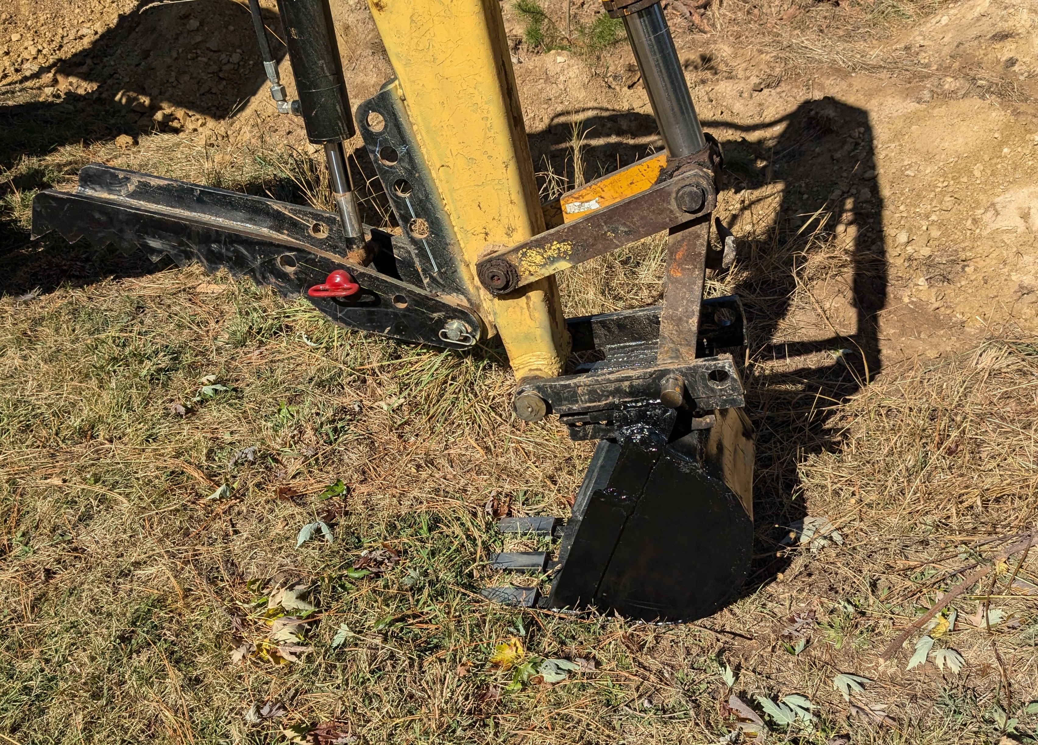

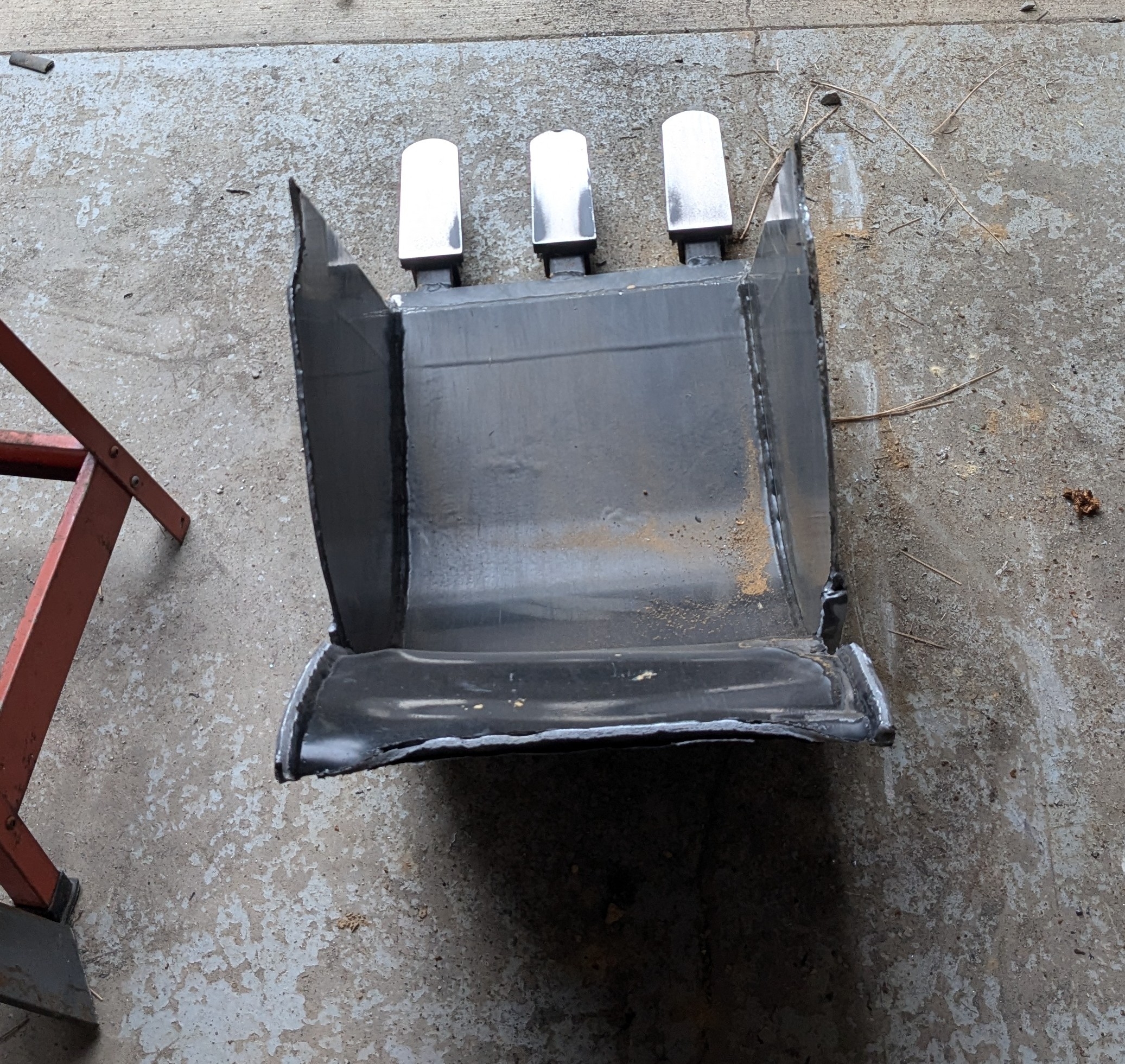

Did get something done on the severed 12 inch. Harbor freight bucket
Reattached and some side reinforcements added was able to dig another 100 feet or so today and the bucket is holding up so far.

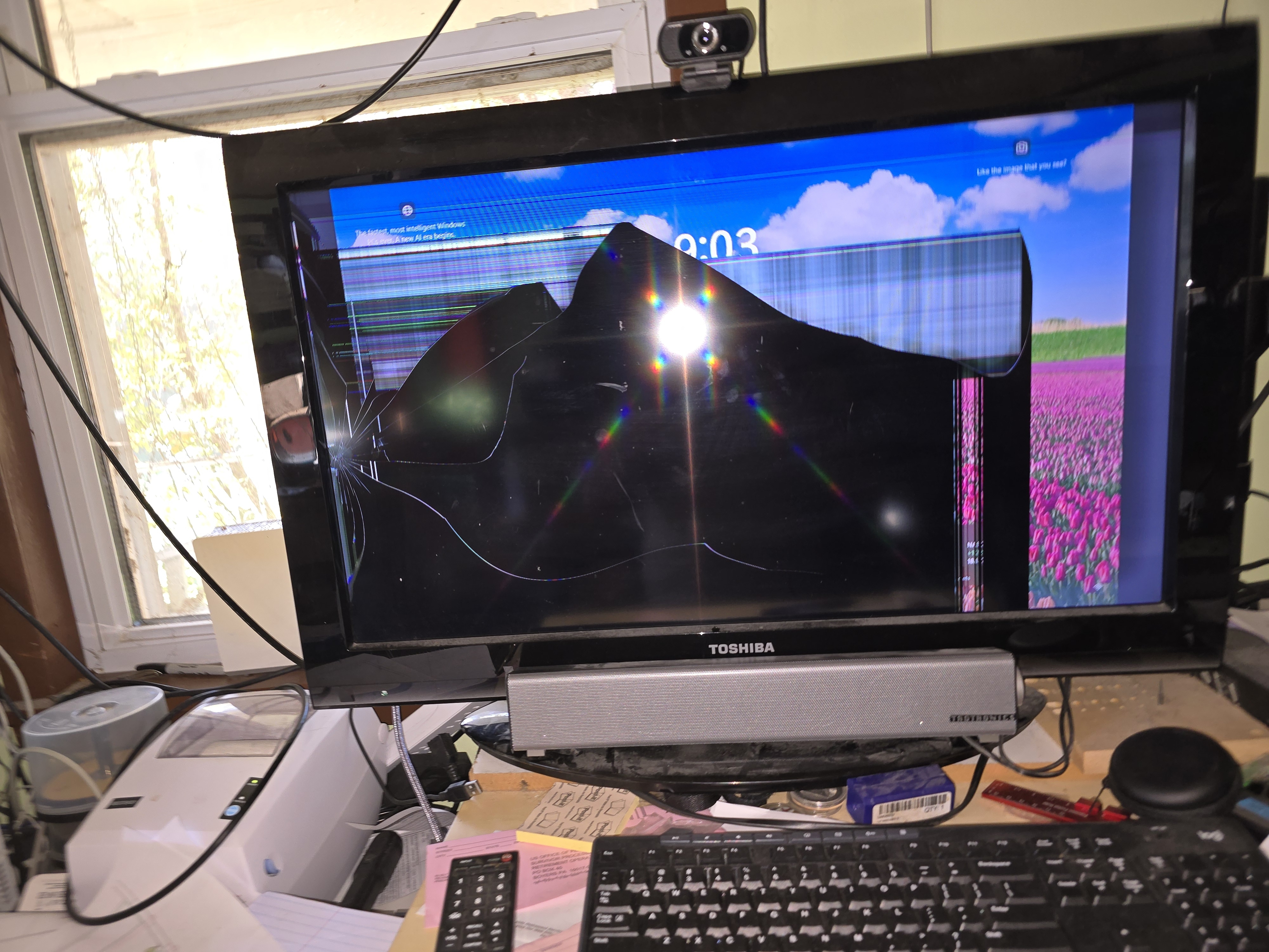

Neighbor borrowed bush-hog. Now it needs new transmission ($725). Cost of shaft and seals, $800🤑. Picked up used 5'er to get by ($500 with free rear 8' blade the seller didn't want anymore). When I got back home, cats decided they didn't like my monitor - No that isn't a black mountain scene on the monitor!
