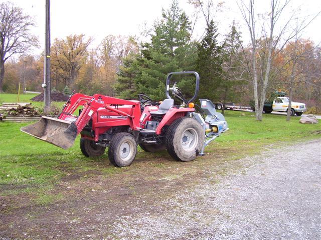

The truck and the trailer are in the back ground, the truck isn't so pretty but it works good.
100_0434 (Small).jpgShane
