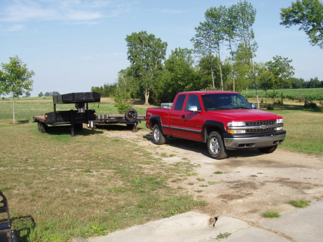

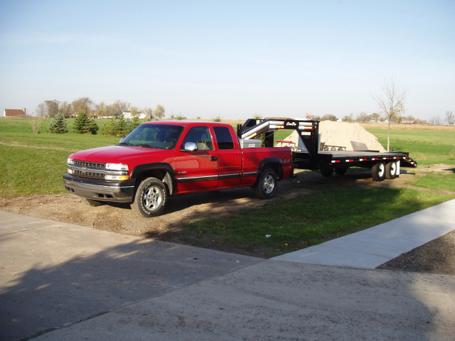

I bought this 20' trailer before the brush hog and quickly figured out It wasn't long enough.Does anyone have any ideas for a better weight distribution for less tongue weight?
OK, I feel dumb. How do we upload pictures? Got it
http://www.tractorbynet.com/photos/showphoto.php/photo/4561
http://www.tractorbynet.com/photos/showphoto.php/photo/4560
Streamin,
From the looks of your pics you need two things. 1) a Longer trailer and 2) a weight distribution hitch. The weight distribution hitch will transfer tongue weight evenly through the truck frame. When adjusted properly it slightly reduces down pressure on the back of the truck and applies or distributes it through the frame to the front of the truck.
   / Your towing rigs and trailers #173
You need something like this Weight Distribution Trunnion Style When set up properly the weight is moved from the tongue to the front wheels and the trailer wheels. Makes towing a heavy trailer much safer. Less tiresome too.

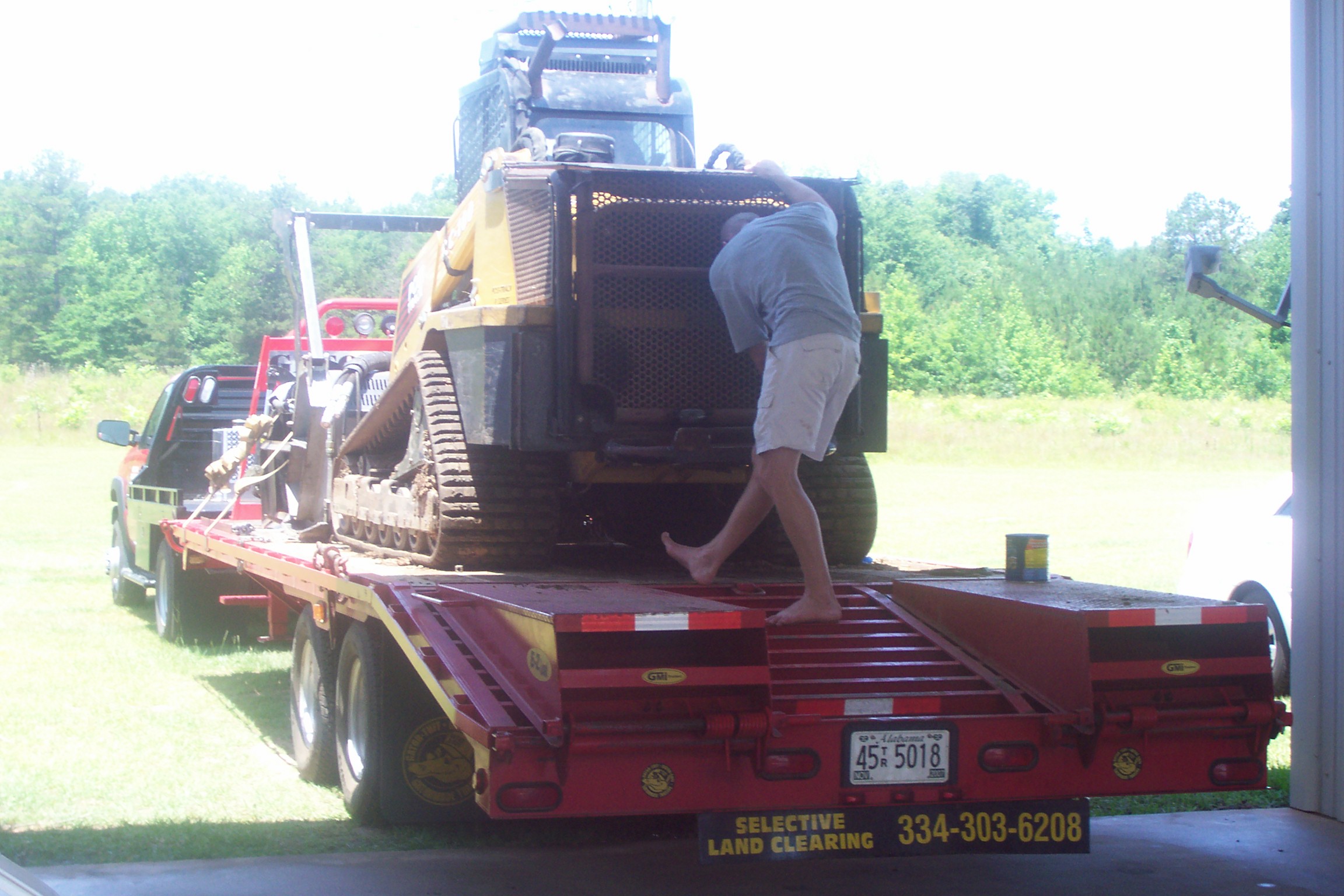

I've been peeking in, so I guess I can throw in a pic.
   / Your towing rigs and trailers #177
Nice Trailer !!!!!!!.............Poor safety (barefoot !!!!!!!)
   / Your towing rigs and trailers #178
Hey...its okay...it an Alabama-thing...:D

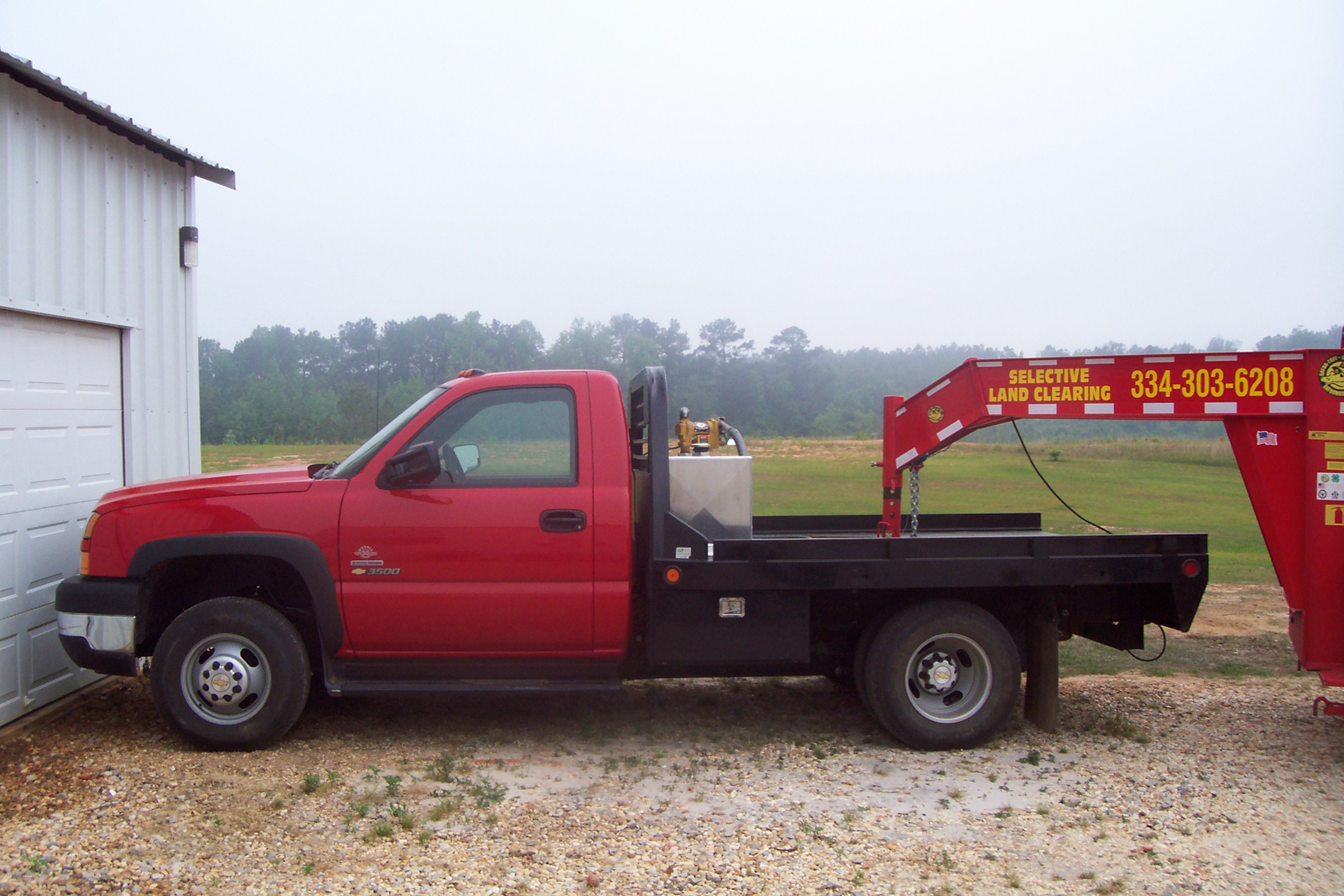

Oky, here are my old and new haulers.
