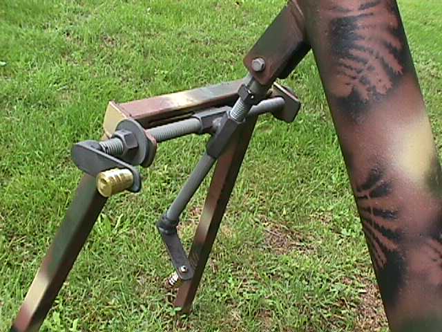

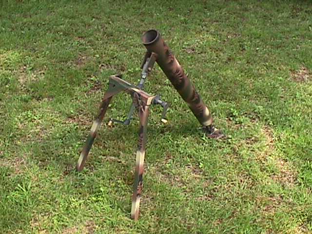

Just average repairs, no production cept I have made several mortars and cannon out of half mobile home axles and could make a living off them! Just for kicks, one of them pictured. Fit a pop can full of sand perfect. 80 gr ffg is a good practice game using T&E to put it where you want, 240 gr ffg pute em in orbit.

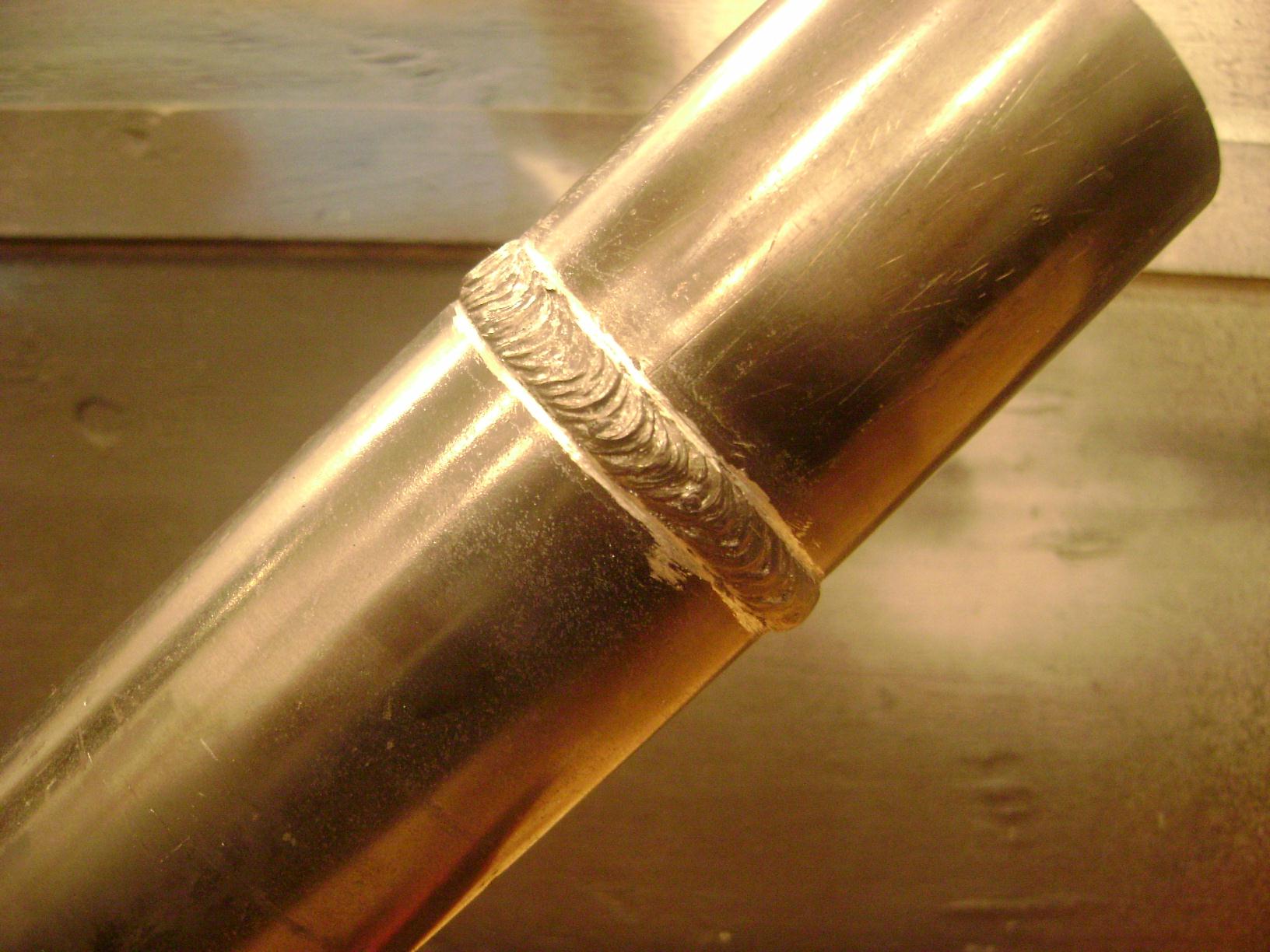

I have an economical stick welder that I really like, it is the Everlast
I have one too, made a weldor out of me!:thumbsup:
