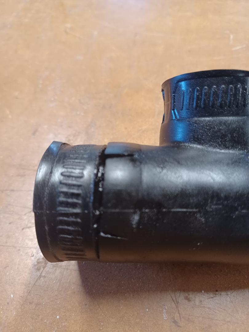

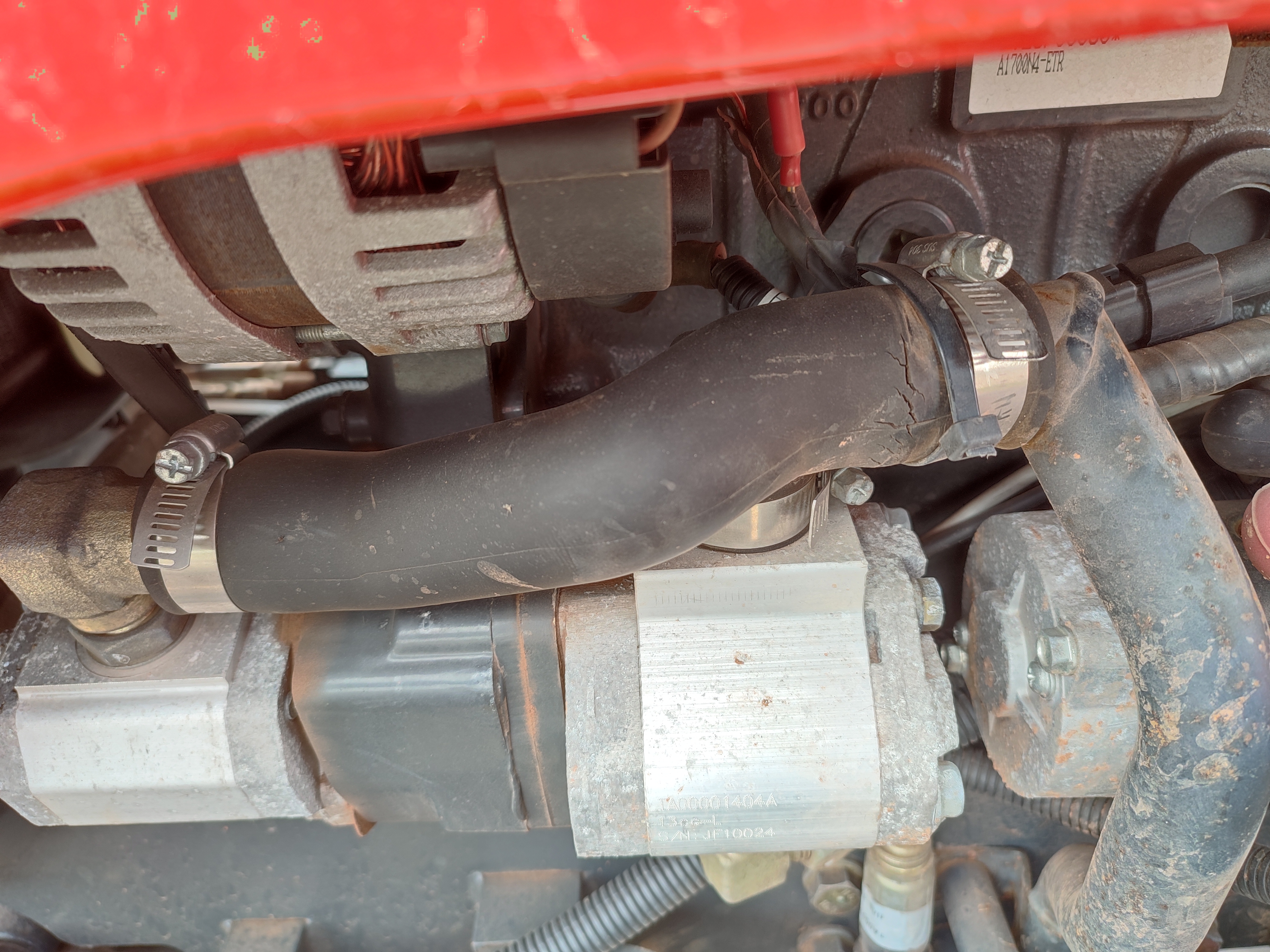

low pressure hydraulic pump rubber return fitting for Branson
2910i

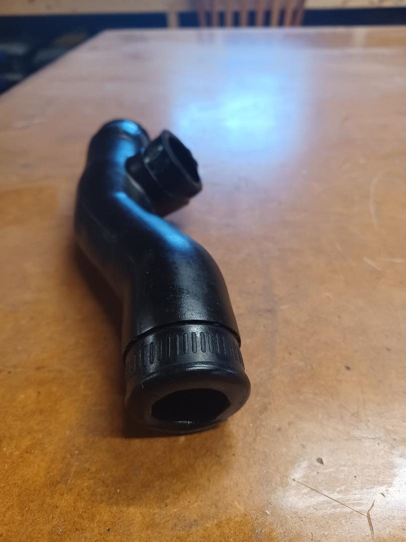

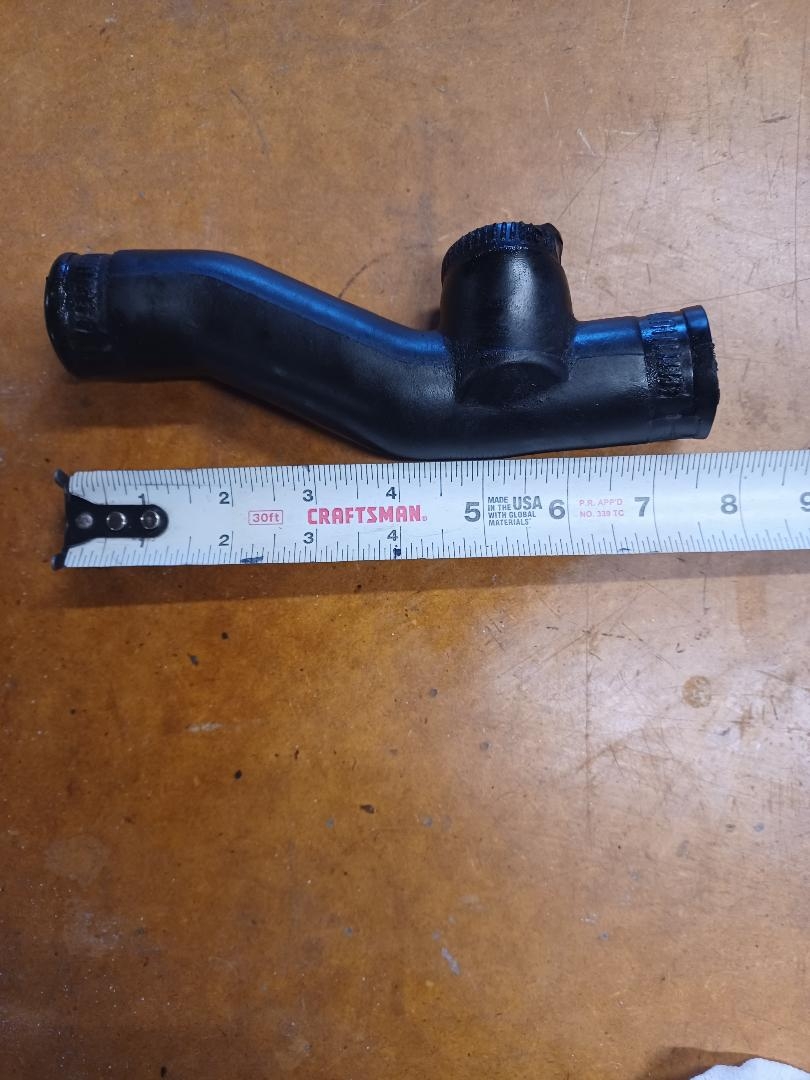

It's the suction hose for the hydraulic pumps. You have to contact some dealers around and see if they can help you.
   / rubber hose fitting for hydraulic pump #4
Holy crap, tell me that's not a a specialized hose, good luck $$$$?
   / rubber hose fitting for hydraulic pump #5
Now that's Kore-engineering at it's best. I'm curious to see how you make out finding one of those. Won't be much in the after market world, and OEM replacements won't be around for long. If all else fails, I would be considering fabricating something from steel tubing and using three rubber connector hoses.

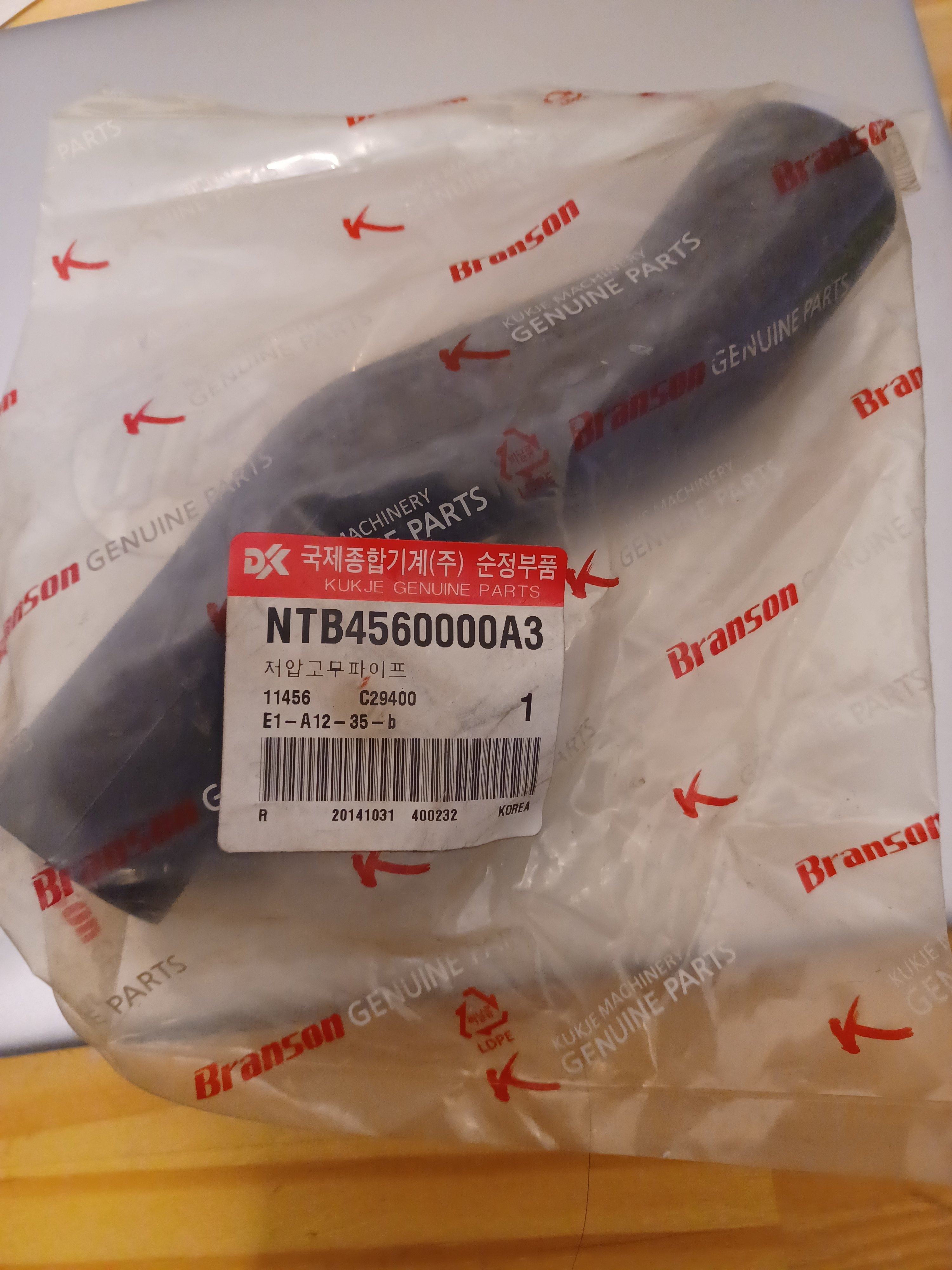

I found it at the dealership I bought the tractor at 20 years ago. In stock!

$75 I couldn't believe it! lol. They were only 45 min from my house.
   / rubber hose fitting for hydraulic pump #12
See? Sometimes it pays out to contact a few dealers first. The model may be discontinued but the parts are still out here.
Here is another one, now that we know the part number: HOSEA LOW PRESSURE (NTB4560000A3)

At $75 per replacement, fabricating an alternative NOW might be a reasonable approach. Esp if it gets More Scarce over time (likely, right?)
I wonder if a machinist/pipe fitter might be able to add a piece to a copper tube . . . Make a mode out of the old hose to use in forming (bending) a piece of sand filled? tube into a similar shape before brazing a nipple of the correct dimensions where in needs be.

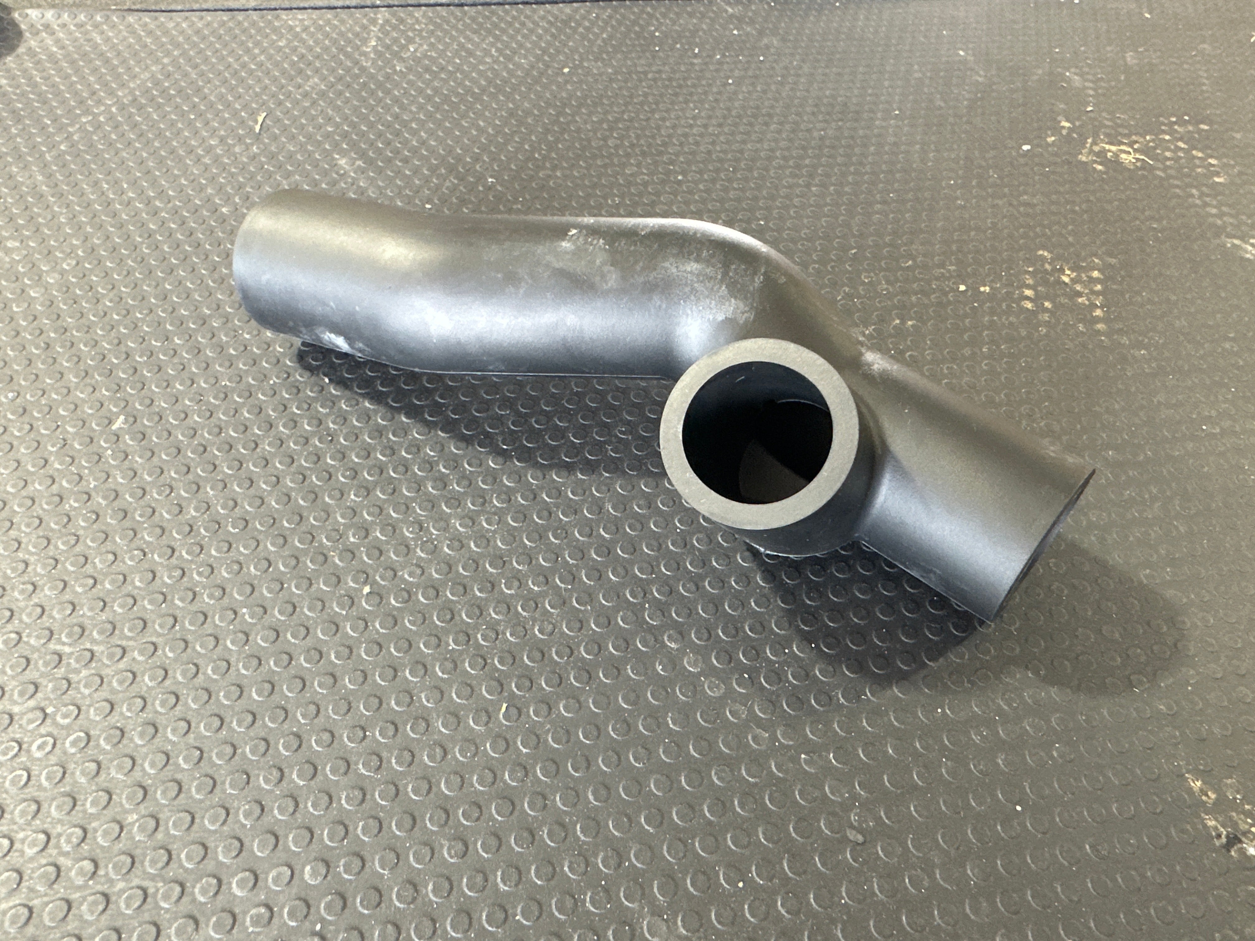

There is a $35 and a $45 alternative for the hose. I wouldn't panic so fast yet. The same hose is used on other models still made today with the A1700 engine that uses two separate hydraulic pump instead of the tandem pump setup on the A2000 and A2300 engines.

That's true indeed but I wouldn't bother too much being a rubber part stored for a long time. As long as it doesn't see direct sun light, it should still last a long time.
That being said, the one on my 7 year old tractor, showed signs of cracking, but mostly because I tweaked the hard line some time ago and it's been forcing the hose in a weird angle. If it wasn't for that, it should last a long time. For now, just wrapped some tape around that bad area.
