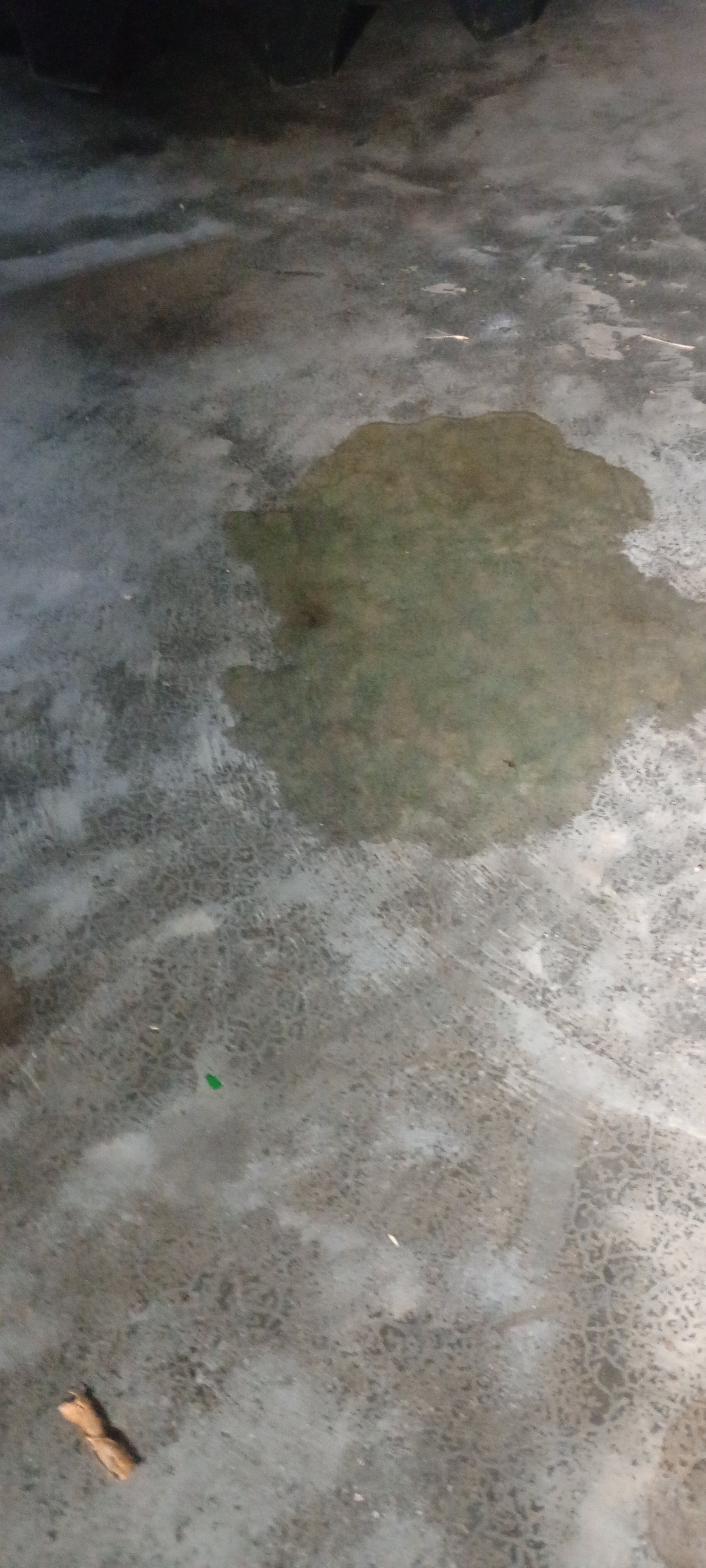

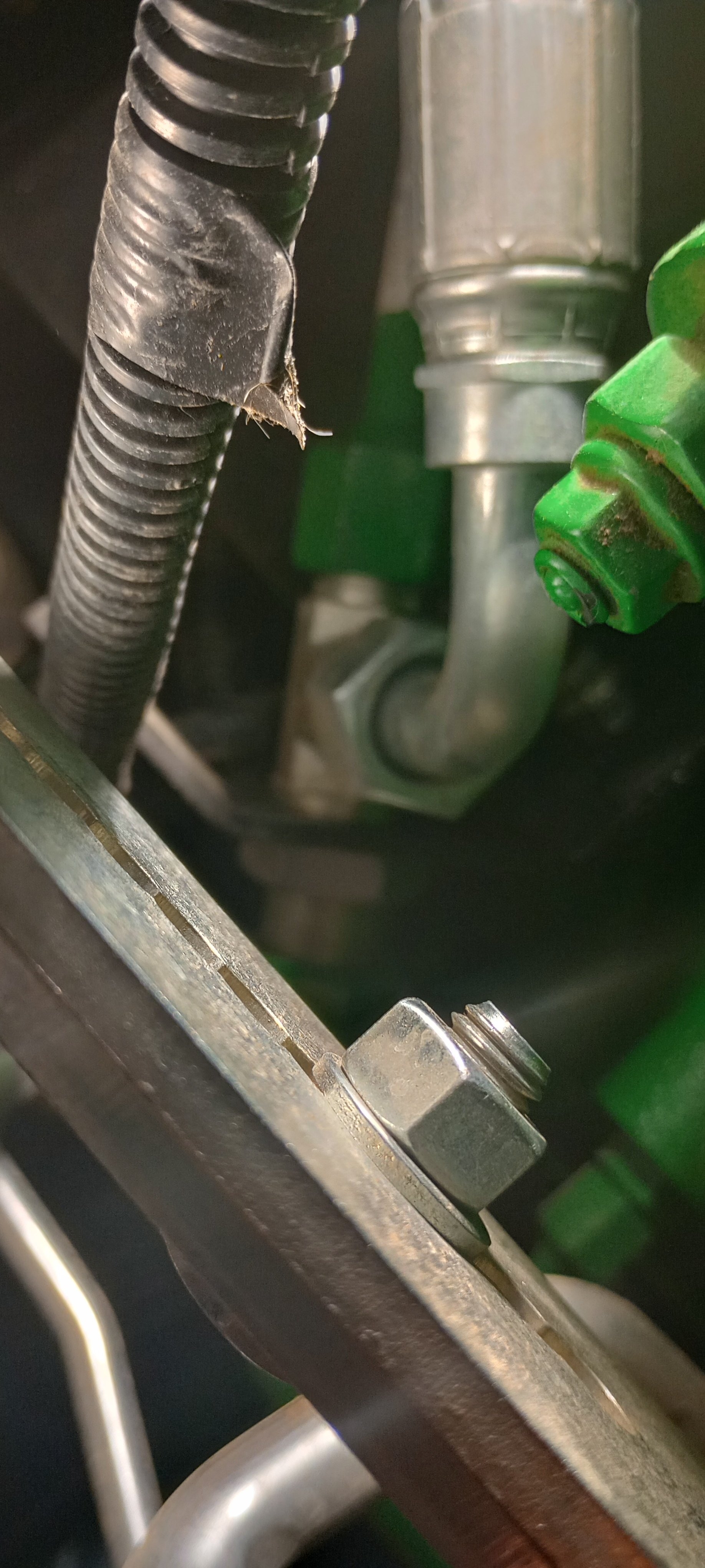

I would have thought the same thing a few years ago with Deere. This is what I found this morning. A new hydraulic leak on top of the transmission. It looks like the tee is leaking. It just never ends with this tractor.

Update: We had to get a loaner for deliveries. They only had a 4044m/400e, which lifted 2060-lb pallets from 48/49 inches. I had to throttle up, but the tractor lifted and curled it. Also, we unloaded a couple of 1900 lbs pallets from a 53-foot semi with no issues. Our tractor does not even budge them. We still have no timeframe for the repair; even though we requested the tractor be returned, the selling dealer refused. The driveshaft cover failed a second time on Sunday, coming from another part of the property. It was insanely loud as I was running over 20 mph, and it really shredded itself.
I forgot to add that they replaced the pump that was flowing 8.5 gpm with a brand new one, and it is now flowing 8 gpm. I stated that the JD specs show 11.2 gpm but was told they are unsure what it should be.
