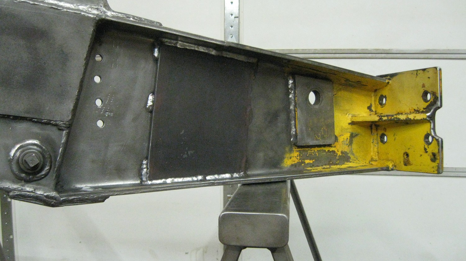

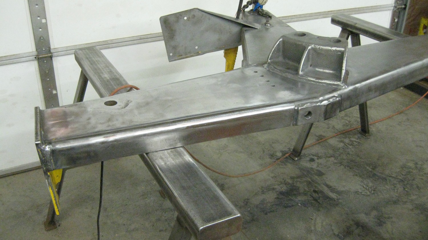

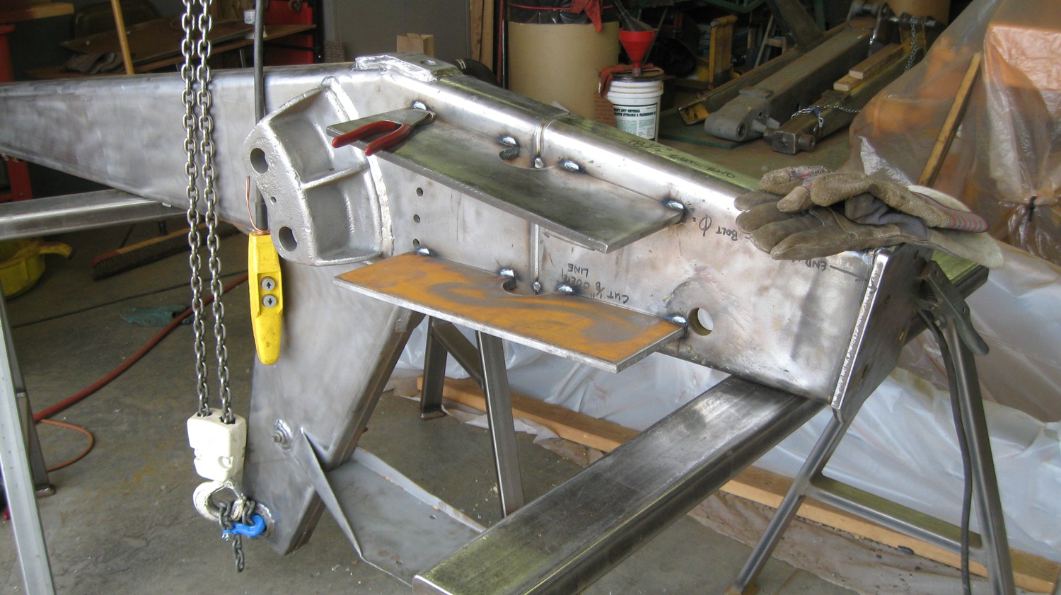

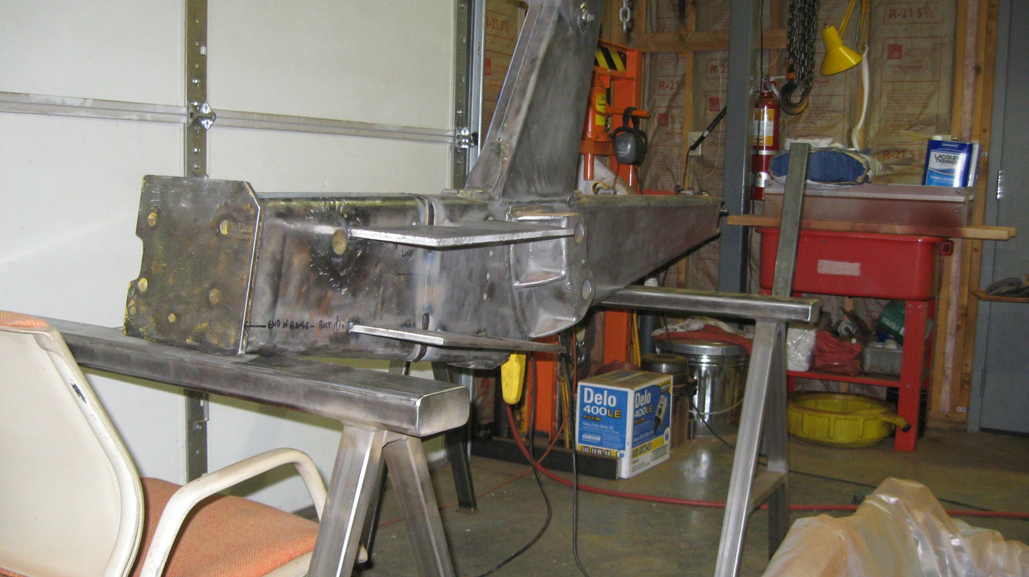

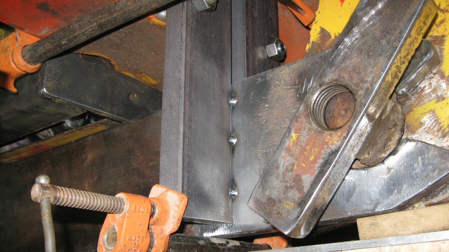

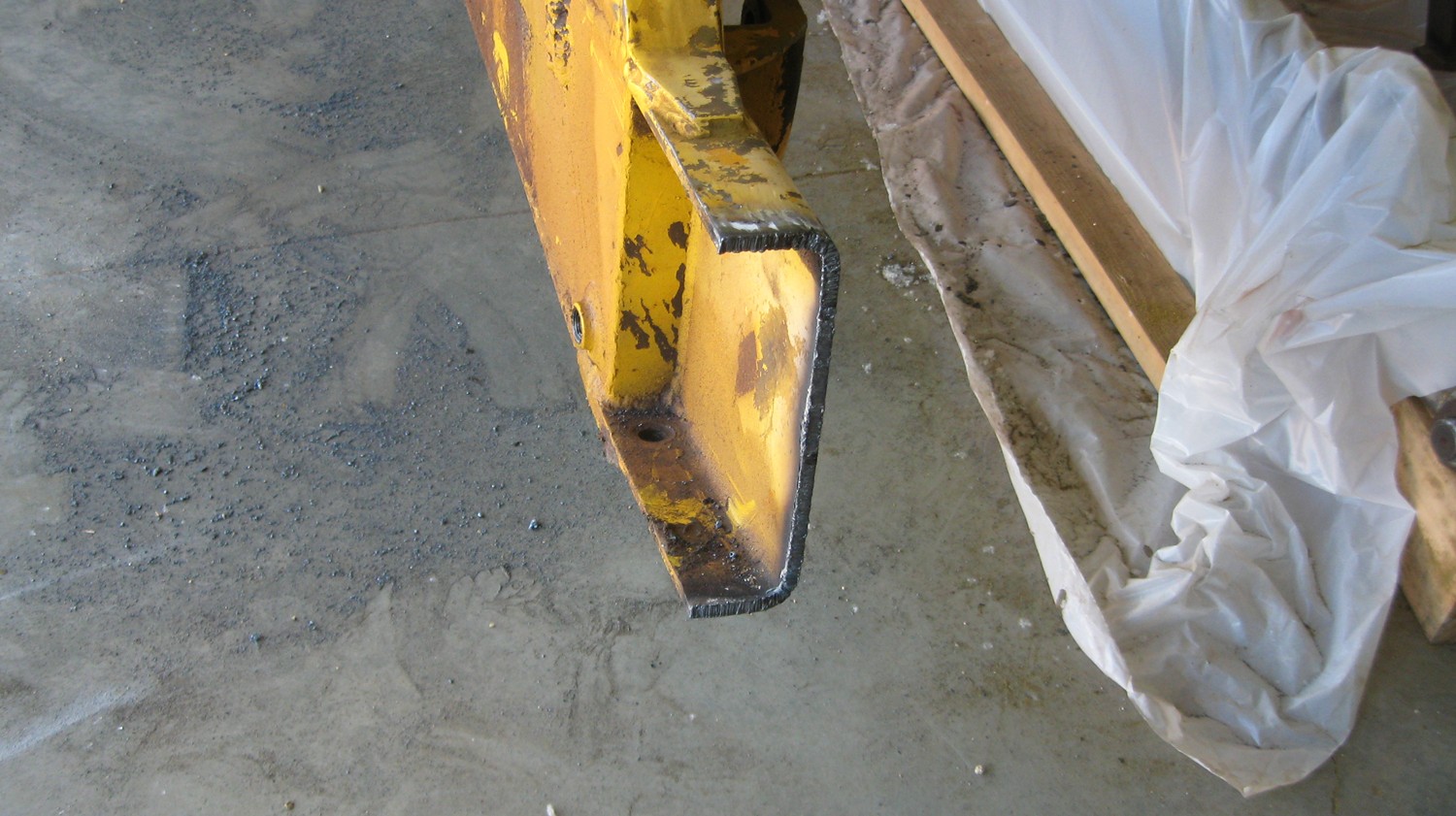

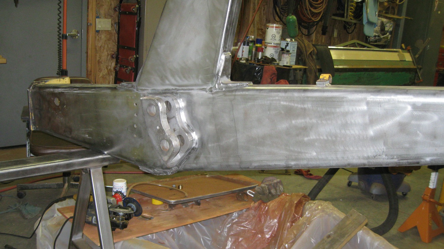

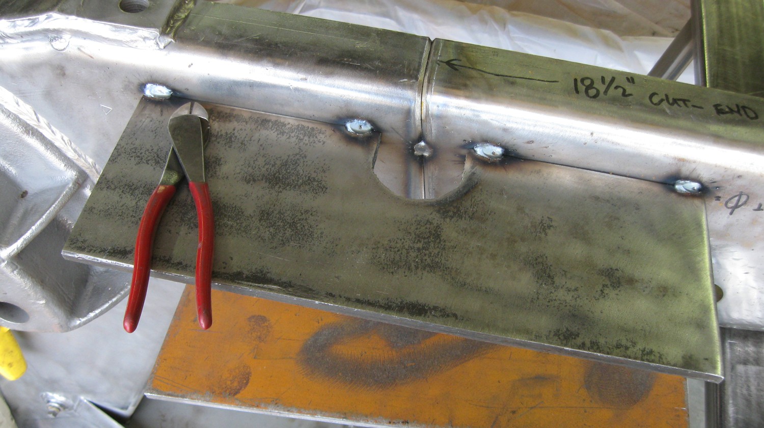

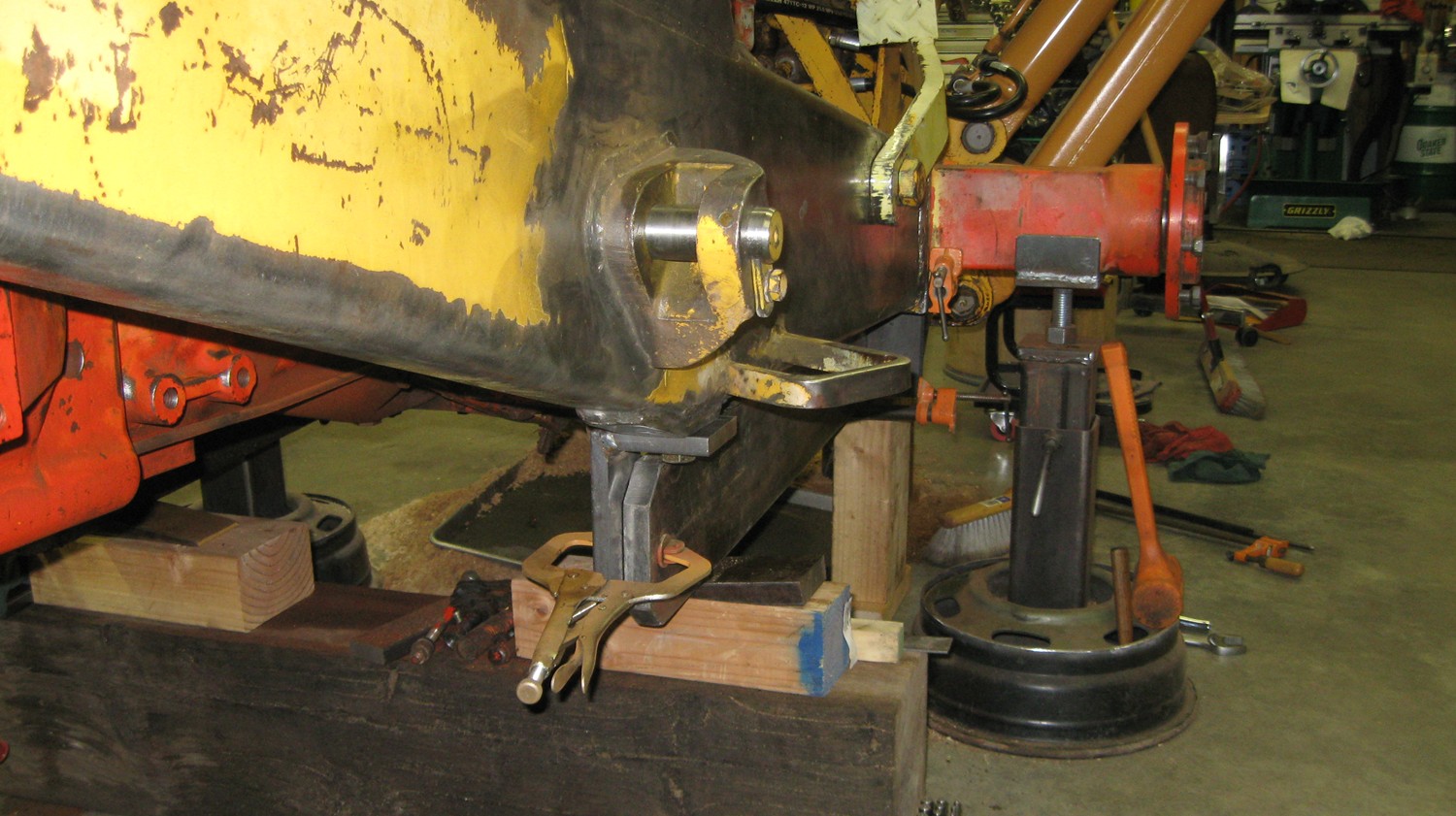

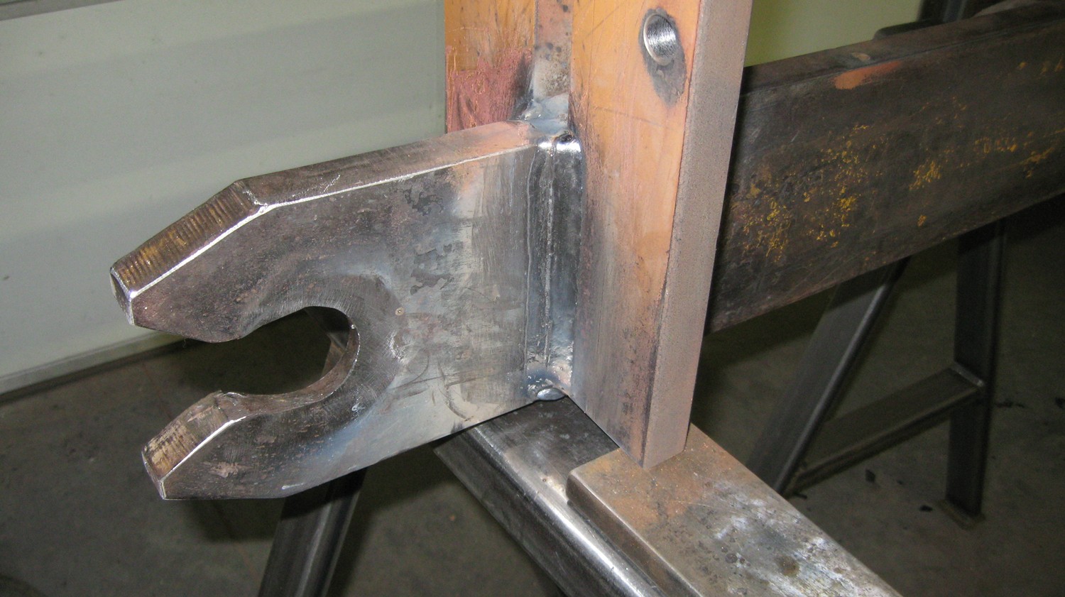

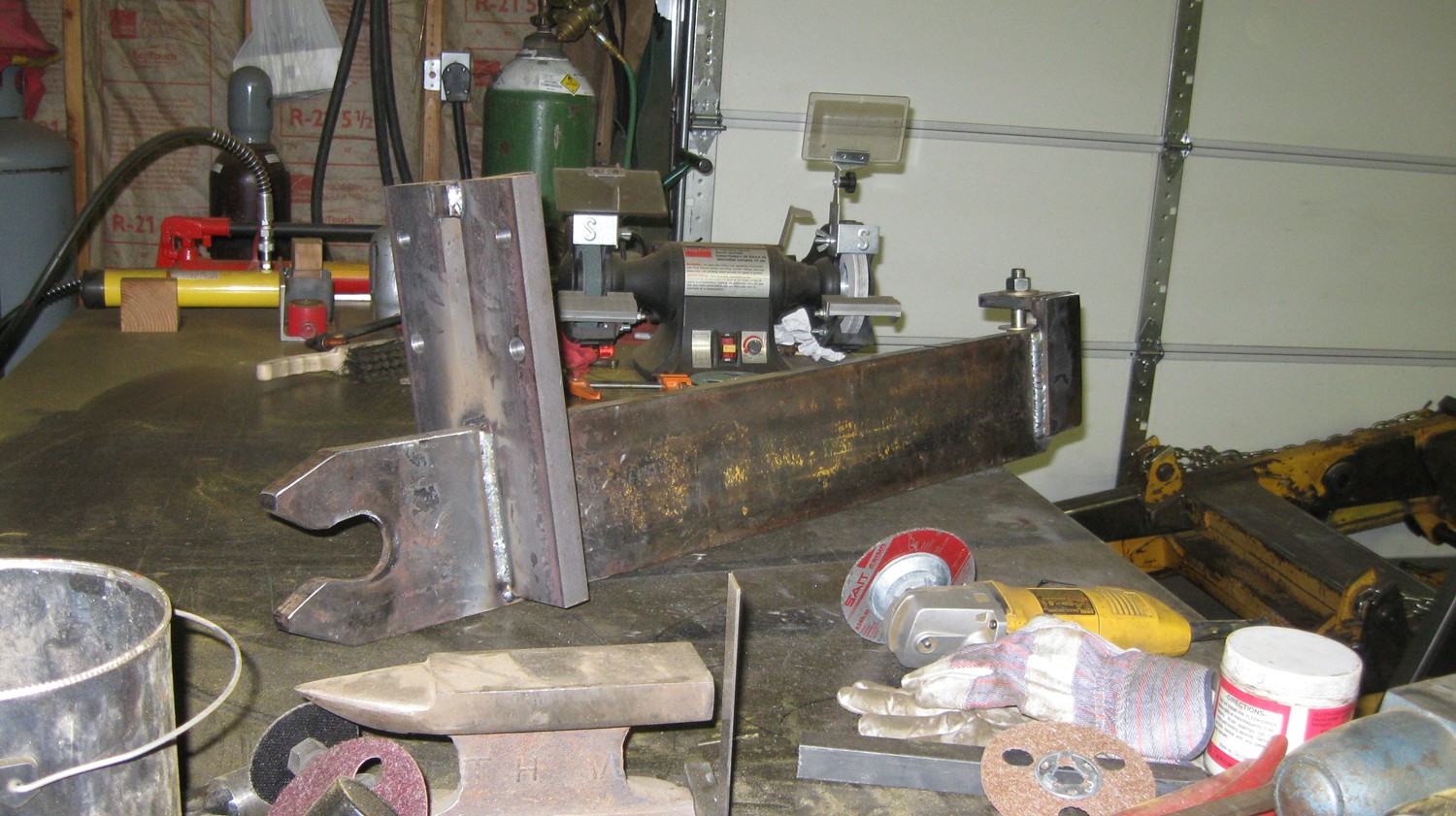

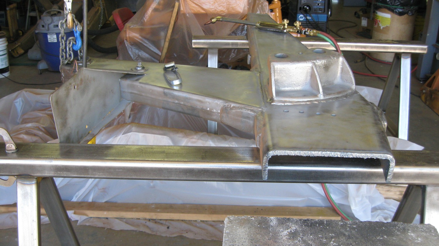

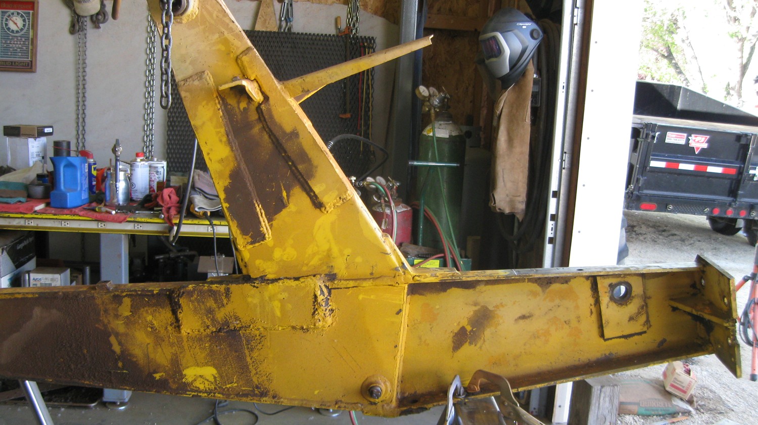

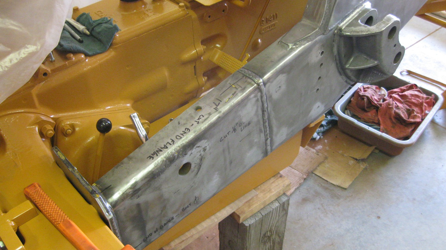

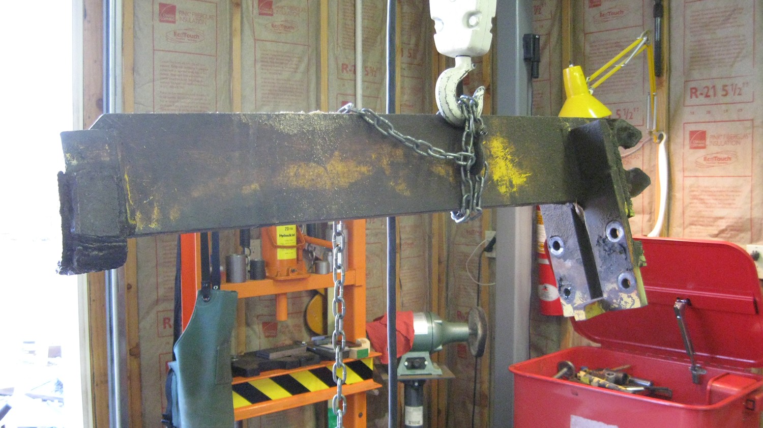

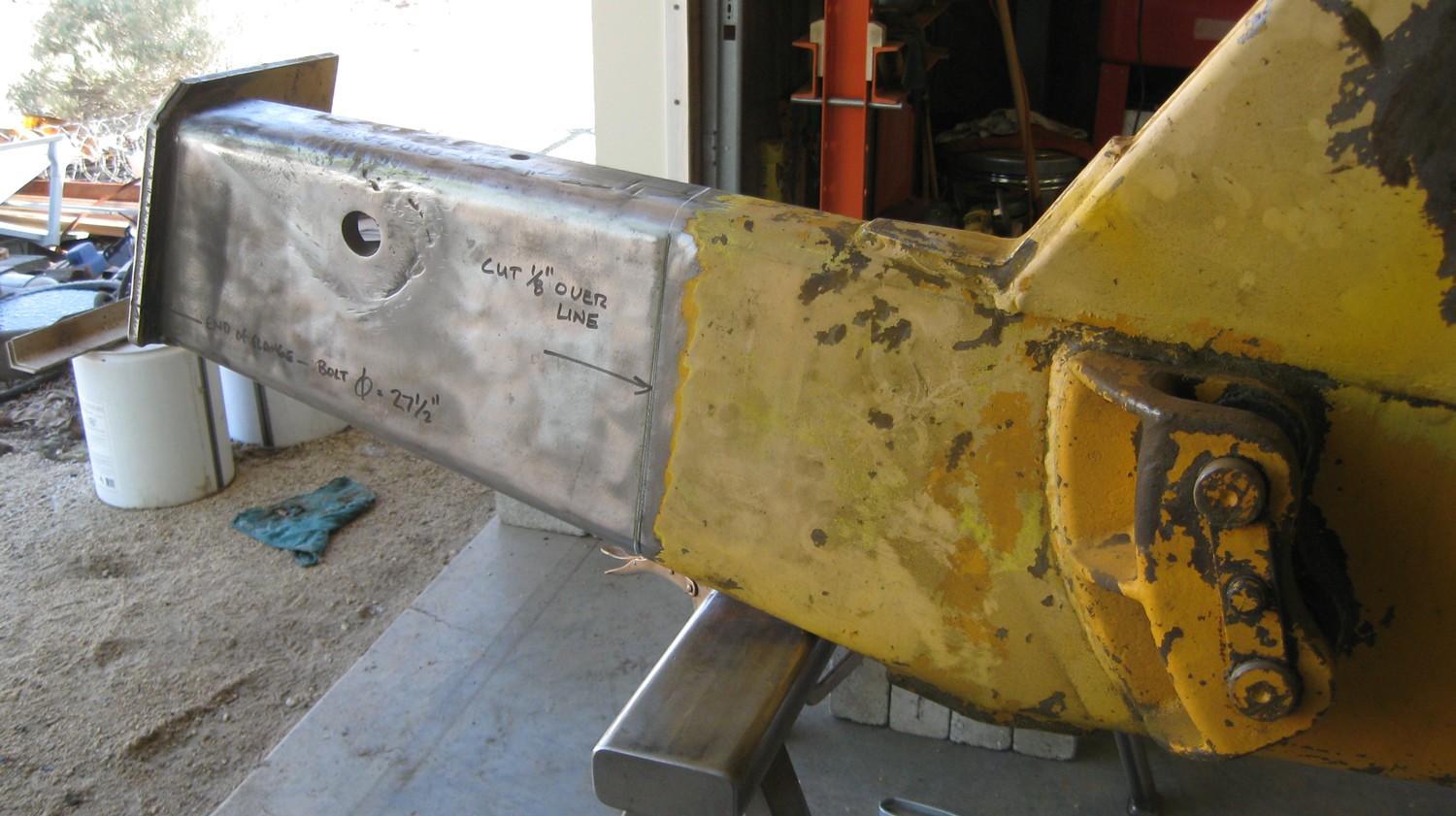

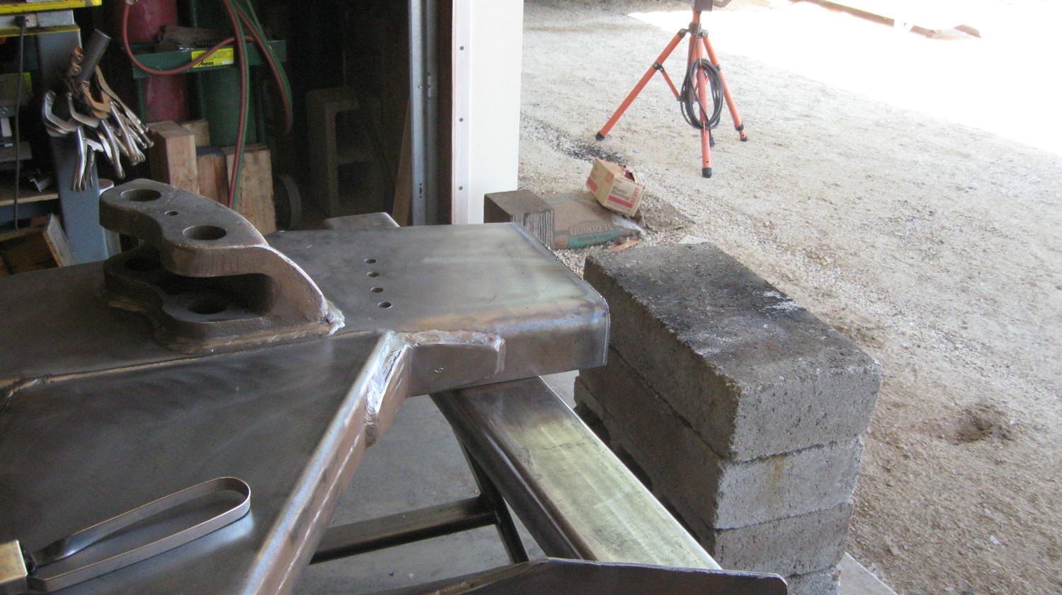

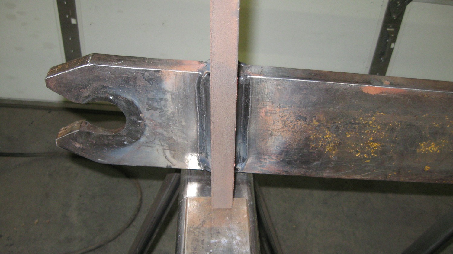

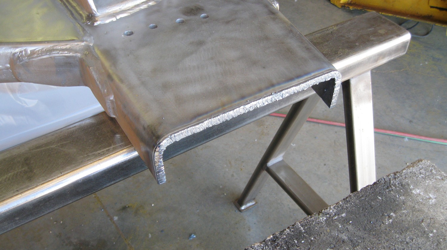

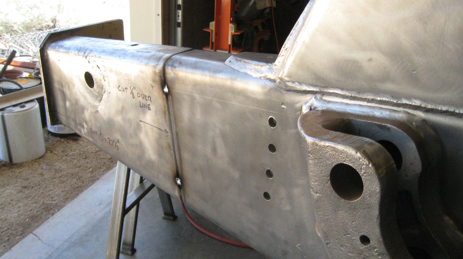

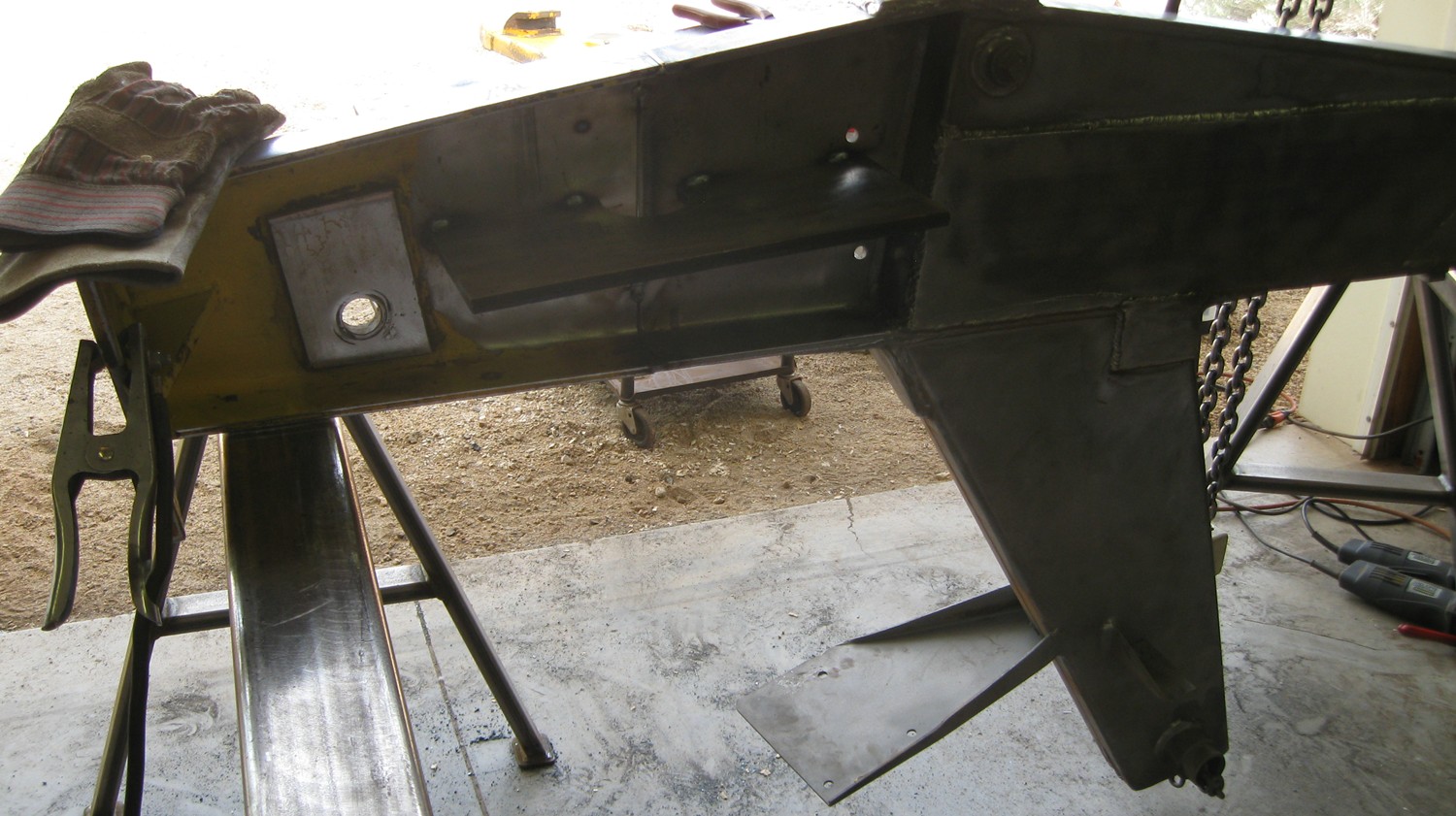

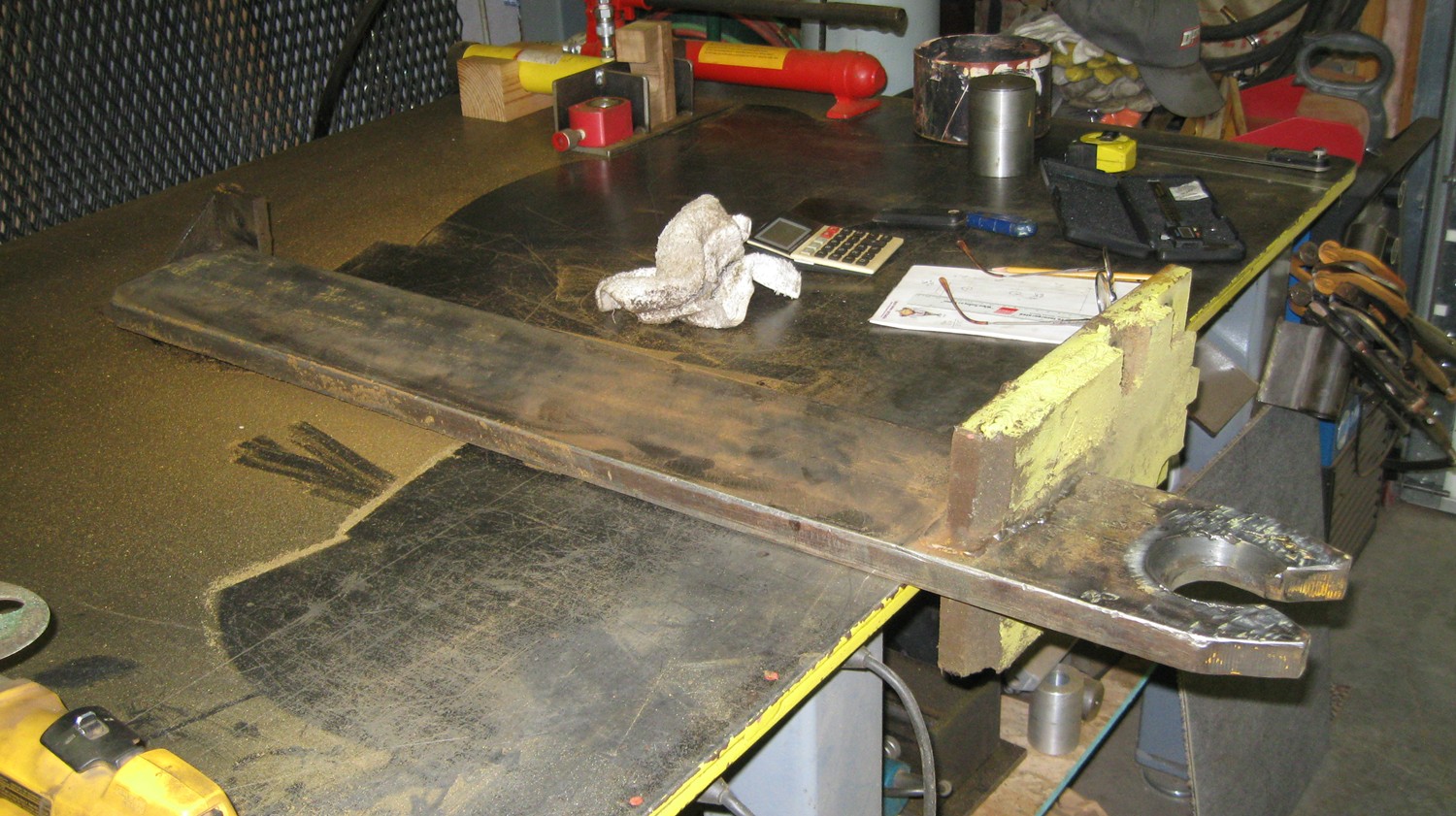

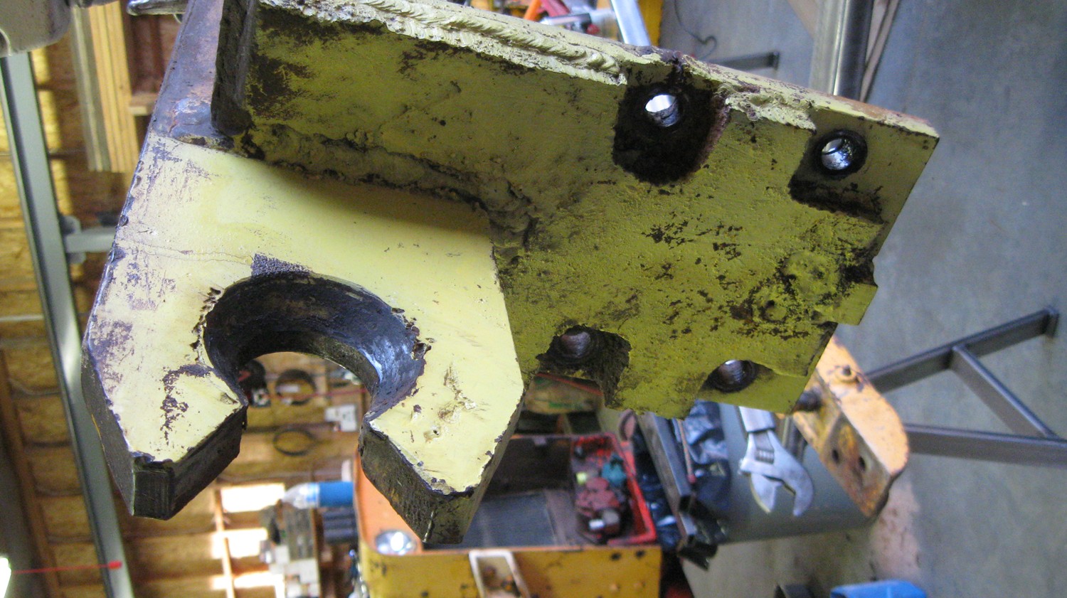

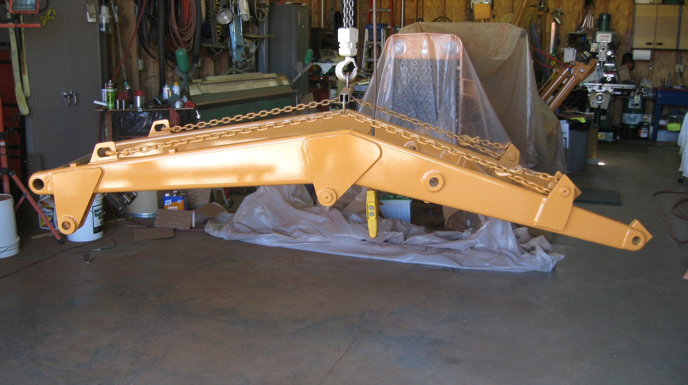

Here is my post of the loader arms replacement. The original arms had looked to have been broken and mended several times. There were fish plates on both arms and just re-welds in other places, it looked like some warp had been introduce in the earlier repairs. They are the ones on the floor of the shop and the replacements are on the horses.
If you look at the arms on the horses you can see that they were pretty straight and worth repairing to use instead of the old ones. I stripped off all of the old paint and ground out and prepped places that needed to be welded. It looked like water had entered both of the arms and frozen, breaking the welds along the factory weld lines or parallel to the welds. You see the factory made each arm in two pieces and welded them together, then attached them with a cross trunnion near the bucket attachment points. And it appeared that somewhere water had gotten in, sat there and frozen when it got cold and broke a couple of the welds. I drilled a hole at each end of the cracks then 45'ed the cracks to get a deep root weld then welded them up.
I made some eyes out of 1/4" bar stock and then welded them to the top of each arm. Sure made it easier for handling and removing, working on, then re-installing them on the tractor. Also made a gambol for the lift; you can see it attached to the chains with a 1/2" U welded to the top. During the re-work process, I made new bushings for the rotating points of the arms and tractor.
Just one of the many welds and repairs that had to be done.

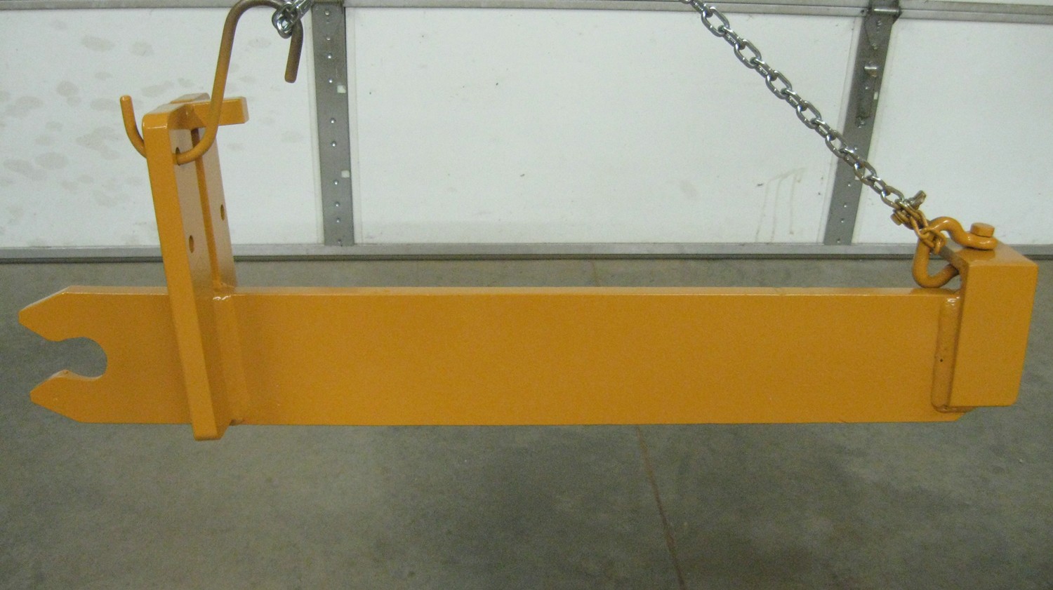

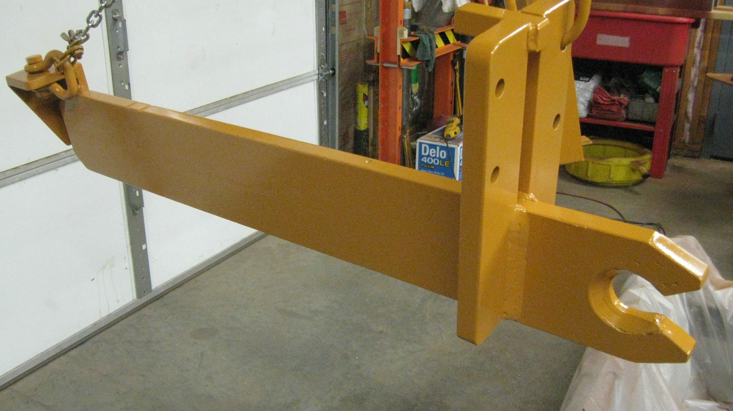

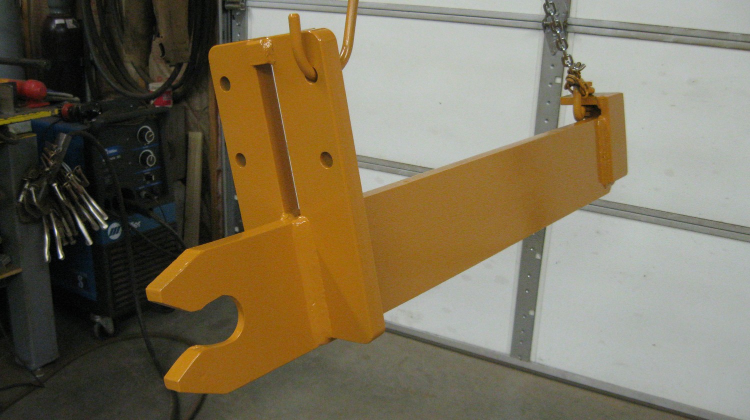

Finished arms and ready for primer.
Finished priming and ready for paint.
Painted arms and ready for decals.
Just another view and perspective.
Decals on and mounted. Sounds easy, but a lot of steps to get to this point. Thanks for all you folks that take a peek!

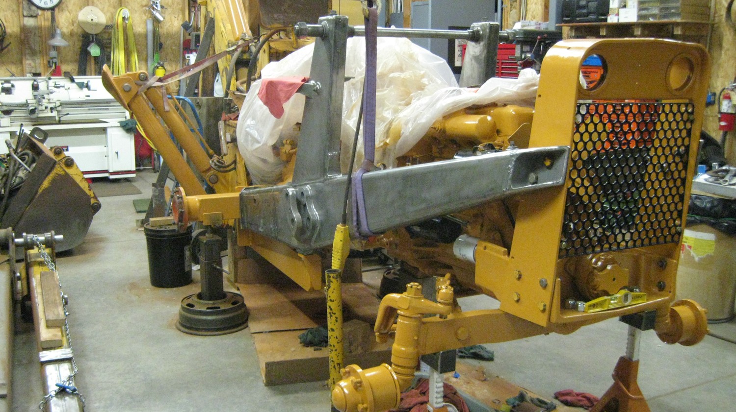

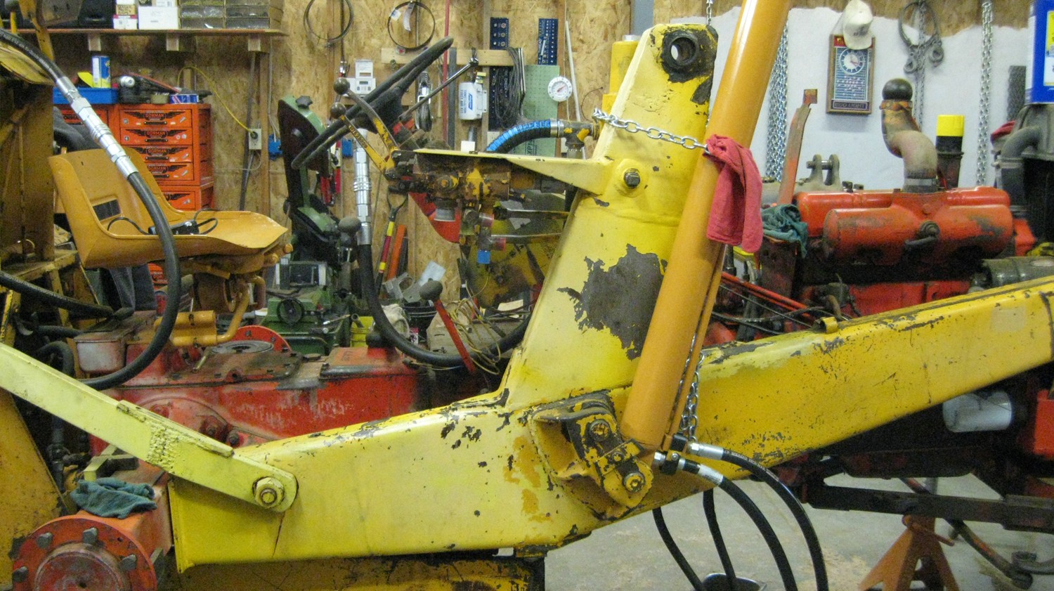

Here will be my last post on this tractor project for a while. I need to start on the backhoe end of this thing and as of this date I haven't done much to that portion of it because I wanted to stay on the loader and tractor until it was completely done. I've had so many interruptions during the summer, that I haven't had the time to start the backhoe portion of this project, except the stabilizers and cylinders, stick cylinder rebuild and bucket cylinder. So, here goes:
Having gotten the decals applied to the hood and loader arms I was starting to install cylinders and all of the front hydraulic groups; hoses, cylinders, pins and hard line hold downs. I painted the hold downs then dipped the ends in liquid rubber for vibration and holding ability.
I know it looks like I've got 2 or 3 steering wheels in this picture but I think that it's a function of the flash from the camera. In this picture you can see the new seat, all of the new hoses and I went ahead and spent the extra money for the non drip hydraulic quick disconnects at the valve body. It will attach to the backhoe portion of the hydraulics. The male and female parts are about $70.00 apiece and there is 2 sets, so it's a bit of money. The spool was working well when I tore the tractor down, so I didn't do anything but clean and paint the valve and levers. I still will touch up the paint on the trunnion nuts and pins and such before I put the tractor into service.
Here is a shot of the new battery hold down that I fabricated and the painted dash pans that I made to cover the wires and tubes that show when the regular OEM dash is left uncovered.
This is another view of the battery case and the pans covering the bottom of the dash.
Got the loader bucket attached with the old pins, they will come out and be replaced with the new ones that I fabricated out of 1 1/2" dia. 1045 mid carbon cold rolled round stock. I have the basic pins all machined and just have to drill the centers and thread the bores to receive the new grease zirks. If you take a look at the cylinder links you can see that they are attached to the loader arms on the bottom and the bucket dump link on top. In the center of the links where the cylinder post meshes with those links, there are recesses for a bushing that interacts with that cylinder post. The bushings that were pressed into the link (pocket) were cracked and I needed to machine new bushings and press them back into those pockets. And I had to do that with two of the links, looks like there had been considerable pressure over the years and just took it's toll on the bushings. Nothing bent or twisted though.
Here is the front of the tractor with a partial view of the bucket attached.
Left side and you will notice that the upper bucket dump link is missing, I have yet to finish fillet welding and repairing a spot that had some kind of "Rube Goldberg" device welded onto it. I flushed it off some time ago, but hadn't got around to finishing it until now. So, after I do that and paint it, the front will be completely done, and I'll mount the newly painted wheels. Then it's time to see if it will run.
I also have to install the new hydraulic lines down to the left hand lift cylinder, and the dump cylinders, fill the hydraulic reservoirs and add new coolant to the radiator, fill the power steering reservoir, and add diesel then prime everything and see if it will start and run. We'll see. For the time being I've got the backhoe isolated from the hydraulics on the tractor, so I shouldn't have any leaks. After I run it for a while and everything checks out, I'll start the new thread on the backhoe portion. Oh, and I do still have to install the rest of the decals on the loader. Thanks for tuning in!

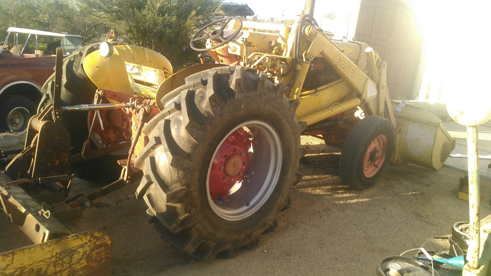

I have attached a picture of mine before I got it home. It now has refinished rear wheels, a new pair of sneakers in the back, fresh oil and filters, and a rebuilt rockshaft piston. Still needs a front pump leak fixed, then start in on the cylinder seals.
Nice Case 530, Walker1,
I studied the picture of your tractor that you supplied and it looks like yours is in pretty fair condition. What year is it? The paint and non-rust looks like it is a west coast or desert tractor. I'm real glad you posted a picture, I like the old stuff and really enjoy someone else's pictures and narrative. I need some new rubber for mine too! I'm glad that my postings are of some use and I'm sorry that I haven't stayed current in my posts. Be assured that I've got more pictures and captions on the hoe part now. I've removed the boom, crowd (stick for some) and bucket, cylinders and finally removed and disassembled the frame and tower and swing cylinders, valve body, hoses, and hard lines. And shucks, you can't believe the amount of machining that I've had to do. It has turned out that most of the pins and bushings were fried and in the future posts I'll let you know what steel I used for pins and bushings at each position on the hoe and the problems that I ran into. Thanks again for the kind words and post a few more of yours..........

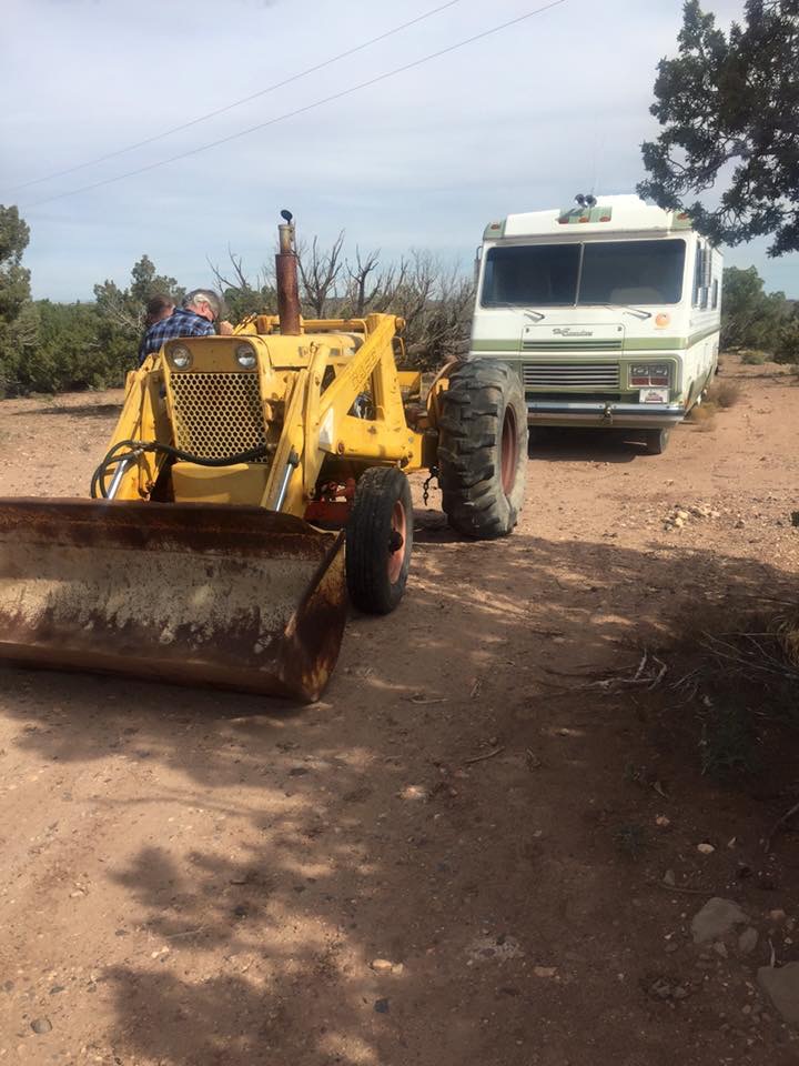

I was up in Northern Az, but came from the Phoenix area before that. Very little rust on it. I pulled the front pump off today to take a look at the seal. Somebody had it apart before, only a couple of the case bolts were tight. The spider gasket was shot and missing pieces, and the gears had ingested one of the check valve sprigs that was put in wrong. Too bad too, because the side plates and gear sides were flawless. Had to order a new pump, so am down for a week or more.
I did get the new rear tires installed and it rides much better now.
