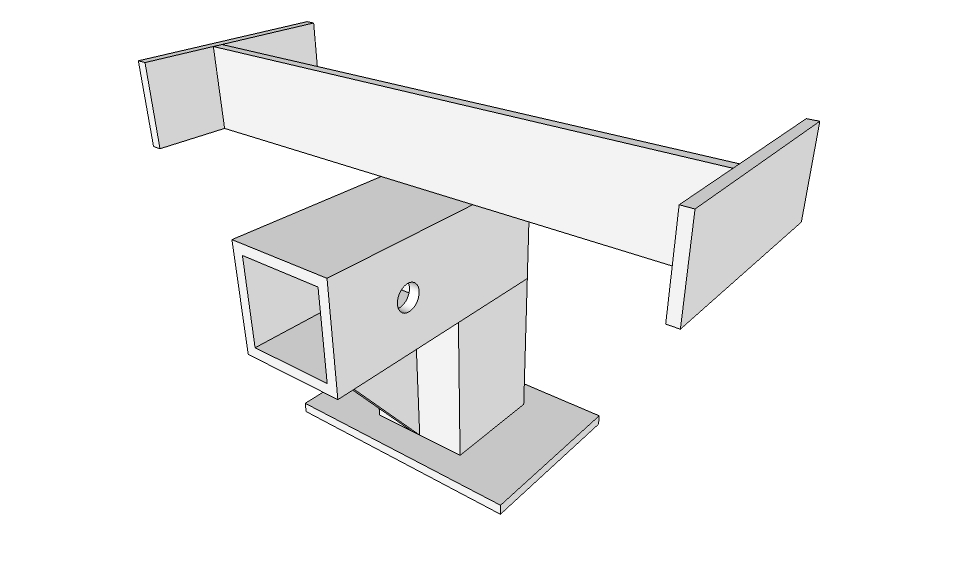

I just made a receiver hitch for my x700. I will post pics middle of this week after it is all painted and installed.
I simply took 2pcs of 2"x6x1/4" and welded together to create a 4x6 plate. This is to be the mounting plate at the bottom.
next I welded a 3 1/2" long x 2" tube steel vertical in the middle, then took some of the same material (same size as a receiver tube, and made an "L" to be the receiver. I also welded a triangle gusset for support.
3rd I made a wide "H" or I configuration of of angle and flat steel. This is welded to the top of the receiver tube, then bolted to the sides of the tractor frame to existing holes.
   / 2" Receiver Solution for X749 #33
I figured out how to add a pic.
Here's a 3d sketchup of my design to help explain

   / 2" Receiver Solution for X749 #34
That looks like it's incredibly strong and certainly wobble-free. That's awesome.
