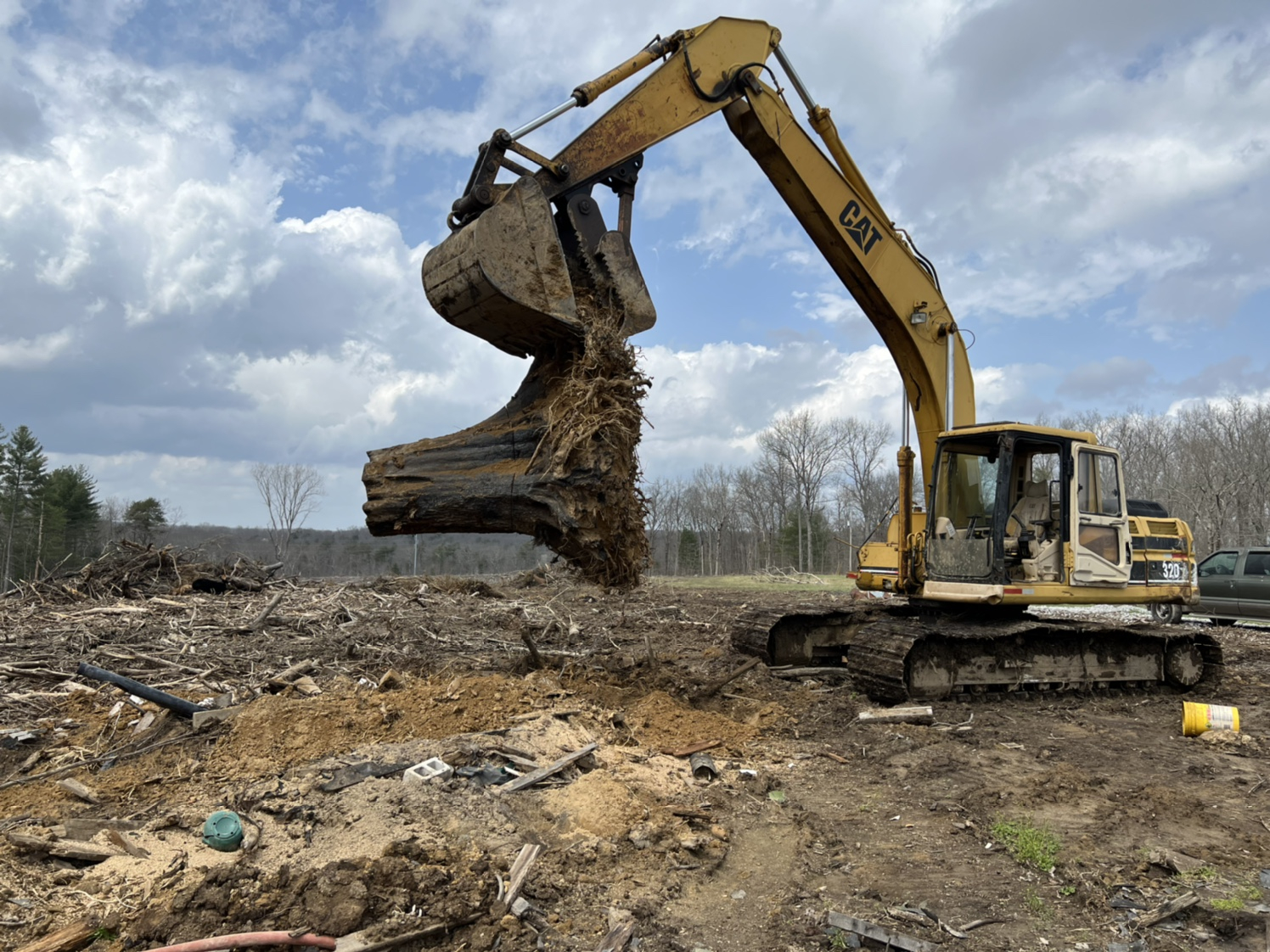

That and people buy a 5,000 pound tractor backhoe and expect them to dig like this.

That and people buy a 5,000 pound tractor backhoe and expect them to dig like this. View attachment 759809
Absolutely; if you need a backhoe, get a backhoe; not an attachment to your 3pt. So many trying to go cheap and make eqt do what it is not designed to do. Then they get all worked up because it failed to perform.
Can’t afford 90 or 120k.
Not rich!
It doesn’t attach to the 3 point it has a subframe.
Tractor manufacturers should make certain add-ons like this get proper hydraulic flow to them.
