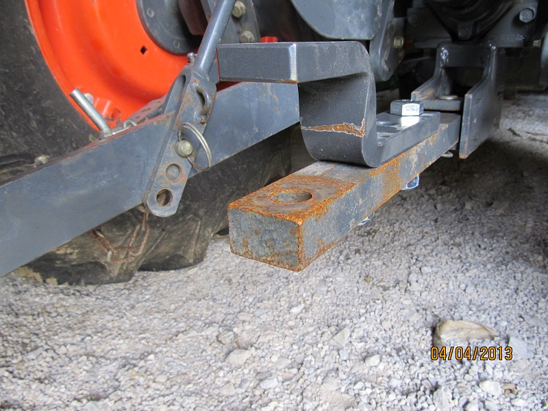

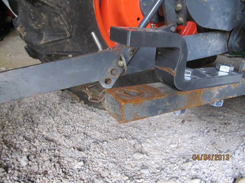

Two points. When I pull heavy implements, I add a "hammer strap" to my drawbar to reduce wear on the drawbar from the "chugging" back and forth of the tool action. The hammer strap is just a sort-of stepped-up short piece of drawbar that bolts to the drawbar and reduces drawbar wear. If you need a picture let me know. Not totally necessary but heplful. Depth is with the cylinder but really should be all the way down for the most aggressive action. This offset disc is going to pull hard but do a wonderful job.

Post the picture if you get time. It sounds interesting.
Some caution might be warranted if the implement is driven by the PTO as to length change of the bar. I have pulled round balers, hydraulic motor rakes, tedders and other stuff for over twenty years with one particular drawbar without any problems of the hole getting distorted, but of course the bolts or pins are shimmed with a sleeve so they are not very sloppy in the hole, except for the tedder which does rack back and forth in the hole.

Here you go. The first is on a 50 HP Kubota.

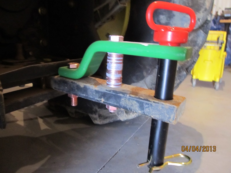

This next one is on my JD 5520 and is not fully set up. JD wanted $65 for the hammerstrap, which is OK, and I think $165, which is not OK, for the bolt and other misc that I think I can get by without. This is shown in mock-up stage with washers being used for spacers. I really don't think it matters what the spacer is but we'll see how it plays out. Anyway, here it is.
As noted, the hammerstrap keeps the drawbar from getting prematurely beat up by having, in effect, a second drawbar to lessen the impact.

Looks good!
Thanks for the pics.
